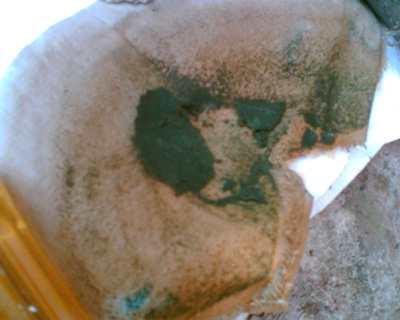

I didnt find a prep so I just tried it 4 times until "it looked right" :) First thing I did was I made some Cu(N3)2 and added NH3 to it. The dried material still pretty much looked like plain Cu(N3)2, most of it was dark brown with a few specks of green/blue in it so I guess the insoluble Cu(N3)2 doesnt fix the NH3 easily. I didnt keep any of the stuff as it seemed quite sensitive. Dry copper azide is quite scary IMHO especially when u have to use gram quanitites because the lab scale is broken and all u have is a digital bowl kitchen scale precise to 1g at most :mad:
When I added NaN3 to a solution of CuSO4 in ammonia I also observed that some violet stuff precipates first. It didn't burn after drying so I figured it must be [Cu(NH3)4]SO4 and discarded of it. The clear filtrate then deposited the green crystals after further standing.
I wasted quite some NaN3 because the solution was too dilute. You must use very concentrated solutions, otherwise little or no crystals precipate even after adding ethanol.
Attached is a photo of the green crystals. I kept a small sample of it. For an explosive azide it is amazingly insensitive.
