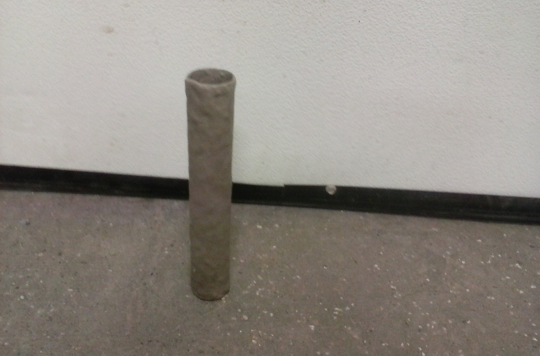

I decided to rebuild the hotbox of my furnace, as (on opening it) I discovered it was not in a nice state inside. I am now trying to contact multiple people (I've already lost count) to investigate if it is a good idea in terms of element longevity to have them in direct contact with silicate containing refractory. I'm waiting for a phone call back from the technical boys at Morgan for some more advice on silicates and direct contact. Morgan actually have a factory about ten minutes drive from my house, so I've been trying to weedle a visit out of them thinking it might be interesting to see the products being made.
I noticed GC and Magpie were having problems getting their cement to stick to the elements and discovered an interesting snippet from this site;
Electrical Elements
New elements have a greasy residue left from the wire manufacturing process, which may cause the ITC 213 to flake off if not removed. One method is to pre-fire elements after stretching for 5 to 10 minutes to achieve at least cherry-red glow. If this is not possible, the elements can be heated in a furnace or kiln at 700oF for 30 minutes. Allow to cool.
The ITC 213 can be applied as described above or can be applied by dipping. Using a wide shallow pan, empty the ITC 213 into the pan and add 1/3 water, mixing well. Dip the entire element except for the lead wire into the ITC 213 mixture. After dipping, shake the element to remove excess coating and hand to dry for several hours or overnight. The elements are now ready to install.

I noticed GC and Magpie were having problems getting their cement to stick to the elements and discovered an interesting snippet from this site;[/url]
Electrical Elements
not_important pointed out this pre-oxidizing technique on p. 4 of this thread already.
I didn't use ITC-100 but ITC-213. ITC-100 may have been more appropriate, but my tube furnace continues to function well. It wasn't a problem of not sticking to the kanthal wire but a problem of cracking. But since it did not spall off it seems to have been a non-issue.

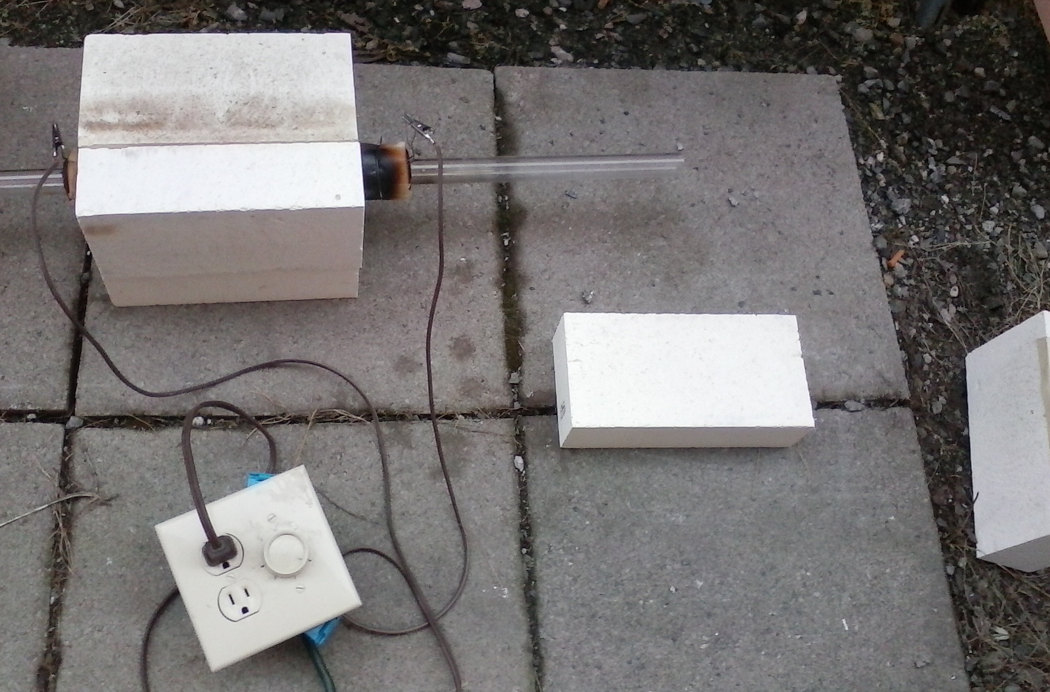

I got 30 meters of 1mm Kanthal A1 wire for $36 via ebay and rewired my furnace with it.
http://shop.ebay.com/i.html?_dlg=1&_jgr=1&LH_PrefLoc...

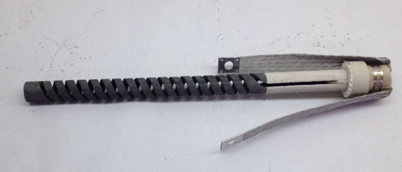

Silicon carbide and moly D elements are available as tubular forms that'll manage 1400 to 1850C, but they are expensive.
I was having a click around on the Kanthal site and spotted this.
"Kanthal furnace tubes can be used at temperatures up to 1250°C (2280°F) and are available in sizes from 26 to 260 mm (1.02-10.2 inch) outside diameter."
Wonder how much they are.
One of the good things about the silicon carbide and moly D tubes, that these lack, is that they feature spiral sections for the hot zones, so the ends where they touch the refractory and wiring remain a bit cooler.

There are also coiled MoSi2 elements up till 1900°C available from www.mhi-inc.com.

I've since tried Garage Chemists nichrome wrap method as well, using this tube, and it works a charm.
I have also noticed cracking, despite pre-oxidising the wire and leaving the cemented result overnight and then in the oven all day, gradually increasing the temperature from 70C to 250C to cure the cement. Solution? Bake and then re-cement with a thinner layer? Must be water loss and shrinkage.

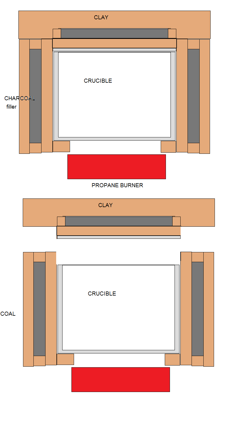

I have following design in mind (ATTACHMENT)
a steel cooking pot in
cover it with clay of 1-2cm thick
put charcoal in the mantle
add another layer of clay of 0.5-1cm thick
Cover the lid with same structure
Would this reach 1000-1200C temp with LPG gas burner? Should the bottom be covered with clay layer too, would this hinder the delivery of energy into the container?

dont remember which thread it was but I remember reading a comment by one of the sci mad members saying stainless oxidizes above ~600/650'C. I lucked out and got a nice big quartz tube 147mm x 152mm optical grade for 11$ + 11.95$ s&h off ebay. so <25$ was a great purchase. what you going to use to monitor temp, control temp? did you calculate how much wire and all that you are gonna need( if you go electrical)? you don't wanna pull so many amps you blow a breaker every time it turns on. it's a big project to get there and not a lot is easy about it. I am in the process of building mine, in scant spare time, but slowly it is happening.
instead of charcoal liner you could try rockwool. I haven't done the heated tests yet but they sell cubes for transplanting seedlings and clones in a garden supply shop. they come all stuck together in small rectangles that are easily cut. might make a better insulator, might melt to a pile of goo, don't know yet.

testimento - 3-7-2013 at 20:04
Yes I considered rockwool and glass wool and other wools, but they do have limited temps of 400-800C, and some few ceramic special wools can hold up to 1300C. Asbestos was another one, but that is obviously a rather too nasty one for this purpose.
The stainless will form an oxide layer at high temps but as long as no mechanical forces are applied, it just sits there, as far as I have tested. The surface layer flakes off when you cool the pot, so in the end after a couple of hundred runs, the reactor bottom may just fall off. I believe I will not be conducting more than a few dozen runs with the reactor until it goes to dump yard so I dont concern about that a lot.
I use triacs with potentiometers to control the power of the heaters. I have controllers that limit max power to 2000, 3000 and 3800 wats, respectively, so it will just sit there at the designated temp. I have one with my 2kW chlor-alkali cell too and it works like a clock.
I'll give a try for this reactor type and see if I can get it hot enough. The propane should give 2000C temp at the flame core and melting lead with it is a minute job, but I made a test today where I used CaCO3 in a steel pot with double radiation shieldings and the temperature went so high the plastic knob on top of the lid of the pot self-ignited and charred into carbon so the temp was at least 500-600C, but IDK will it reach 1000C. If it wont, I will consult my electric company via nichrome.
[Edited on 4-7-2013 by testimento]

testimento - 5-7-2013 at 18:55
Well, this wouldn't be just for few uses. I was actually planning of using this for several different processes, including those with catalysts. Lead in one tube, catalyze, and lead the products out and cool. Cool. :)
I made a little adventure to my local junkyard and found a 60-liter aluminium cylindrical tank. An idea came in my mind to coat it with ceramics from inside, make holes at the bottom for the burner, a top at the middle for the canister to sit and vent holes at the top and then the lid. This would be the primary can, and I may coat this with rockwool after then.
My idea is to use common wood coal as an alternative for the gas burner. Big pack of it like 5kg costs a few quid and that should give rather nasty temperatures and kilowatt-powers when I install line fan to blow air at the bottom of the burning coal.
Another of my idea was to insert the crucible itself into this thing, which is coated with clay and stuff and has an nichrome electronics inside it, so if the outer temp is 900C, I will need only small boost with electricity to reach my 1000-1300C.
I planned on using common concrete, but it seems that it only sucks up all the heat, so I've got to look for fireclay, at least to cover the interior. Hope it aint that nasty priced shit I saw at my HW store last week... -___-

testimento - 9-7-2013 at 18:51
Sorry I make two threads but Im gonna make this oven:
-I use 8-12 firebricks
-I mortar them together with fire clay in square form
-I will put nichrome wire worth of 2kW inside and glue them with al2o3 paste to the walls
-The bottom and cover will be made out of 60mm thick plates of fire clay
-The bottom have insert for gas burner and air holes for roasting coal
-The container that goes inside is stainless steel or clay. It will be coated with al2o3 paste, wrapped with its own nichrome wires and coated with clay again.
-So you can use the electric only heater, the container heater and the gas burner or coal. This should bring the thing over 1000C.

Some Silicon carbide tubes here.
They are a bit short. Could you make a heating element from one?
http://www.ebay.co.uk/itm/FOUR-INCH-LONG-HEXOLOY-SILICON-CAR...

jock88 - 16-11-2014 at 17:43
What do ya all think of this one?
http://www.ebay.co.uk/itm/Silicon-Carbide-Heating-Element-1-...
It is a Silicon Carbide heating element 5.37 ohms , 1.25 inches diameter and about 15 inches long (I think). and costs 100 bucks
What power would it put out?
TIA
$_57.JPG - 62kB
Metacelsus - 16-11-2014 at 18:24
At 120 V, 2.68 kW.
macckone - 16-11-2014 at 23:38
Given the size I would say it is probably a 220V rated heater element. That would be around 9KW and require a 50A circuit.
*edit*
Given a little more research it is designed to operate at 9KW
at 1200C.
[Edited on 17-11-2014 by macckone]

I just built a fairly humble tube furnace. It is only 500 watts and 12 inches long. I simply wrapped one layer of aluminosilicate ceramic paper around a 1 inch black iron pipe and fixed it in place with wire and then wrapped it with nichrome. Then I placed several additional layers of ceramic paper around it and held them in place with wire and put it into a box made with firebrick with the power supplied by a triac dimmer. I had a similar one that was twice as big with 1/3 the wattage with less insulation up to around 850 F yesterday, so I'm quite sure that this one will get really hot. I have a couple of 120 cm quartz tubes that I can place in it. My target is 1000 C.
I bought some alumina boats, but they don't seem to quite fit into my quartz tube, and I'm not sure what to use to grind them down to size (I suppose a diamond grinder would work).
Given the simplicity of construction, I will post pictures later.
Edit: I checked the temperature at 30%, and I had to rescue my thermocouple before it was destroyed by the high temperatures (I am waiting for a better thermocouple to arrive). At the time, the temperature reading was around 730 C but rising rapidly. It looks like it will work just fine for making aluminum chloride and lithium hydride.

wg48 - 25-2-2016 at 15:16
Snip
I just built a fairly humble tube furnace. It is only 500 watts and 12 inches long. I simply wrapped one layer of ceramic paper around a 1 inch black iron pipe and fixed it in place with wire and then wrapped it with nichrome. Then I placed several additional layers of ceramic paper around it and held them in place with wire and put it into a box made with firebrick with the power supplied by a triac dimmer. I had a similar one that was twice as big with 1/3 the wattage with less insulation up to around 850 F yesterday, so I'm quite sure that this one will get really hot. I have a couple of 120 cm quartz tubes that I can place in it. My target is 1000 C.
With a conductive former you risk the insulation between it and your element breaking down. Particularly so at higher temperatures, with 220V elements and only a few mm s of insulation. As the insulation starts to conduct it heats up which increases the conduction which increases the temperature. thermal runaway then create an arc melting the insulation and element.
JJay - 25-2-2016 at 18:36
LoL, it wouldn't create an arc - it would create a short circuit, which would blow out the triac long before melting the insulation. But anyway, that's actually not likely to happen with careful construction. And actually, materials become *less* effective conductors when they heat up. I'm not mocking you, but I'm not sure what makes you think you are competent to give advice on these matters... have you built a tube furnace, wg48?
I have 120v elements and yeah, only a mm or so of inside insulation and about 10mm outside plus some refractory brick. I guess I should mention that I doubled up the inner layer of ceramic paper at the ends to keep it from breaking down under the steel wire, and I didn't wrap the heating element very tightly. I think it might be possible to heat it to 1300 C but I don't have any specific plans that would require such temperatures... I think the tube furnace could be used to make phosphorus but have no plans of doing so.
Incidentally, the iron pipe / asbestos (ceramic) paper plan came straight out of Vogel's Practical Organic Chemistry, although I had to make some modifications for higher temperatures / lower voltage / less use of carcinogenic materials. I'm not saying my furnace is as good as garage chemist's, but it sure was easy to build.
Here it is running at around 800 C. I'm burning it in so that it won't fume when I use it in regular experiments (burning off pipe paint, wire coatings, masking tape, etc.). Oh and, the quartz tubing is actually pretty close to ambient temperature at 30 cm away from the heating element.

wg48 - 26-2-2016 at 08:06
[Edited on 26-2-2016 by JJay]
Well apparently we agree one thing it may be possible to run it at 1300C. Why not try it if you think its not risky. The question is how long will the few mm's of ceramic insulation hold off the voltage. Perhaps you will be lucky.
I suggest you swot up on the behaviour of insulators with temperature.
JJay - 26-2-2016 at 20:48
Umm... let's see here....
The coefficient of resistance of both quartz and alumina is extremely close to 0. There is minimal risk of loss of resistance from temperature.
I haven't run it at 1300 C because my thermocouple would disintegrate long before reaching that temperature. Also, 1300 C is pushing the service temperature of the nichrome wire (I've read that Kanthal is a bit better at high temperatures). The melting point of the pipe is probably around 1400 C. While it could withstand a temperature of 1300 C for a limited time, its service life would be limited, and the quartz might not do so well at that temperature either. The furnace was cheap and easy to construct, but I don't have a specific reason to use such high temperatures.
I thought the alligator clamp/120V plug cable was a nice touch, but of course that would be considered an unholy abomination around children or in the workplace.
I usually use game theory type analysis instead of SWOT analysis, but it does depend on what exactly I'm trying to accomplish.

Ready made furnace elements ((reporposed)
wg48 - 3-3-2016 at 18:47
Below is a pic of a heating element extracted from an old ceramic hob. Presumable good to red heat temperature perhaps higher if the watts is reduced. It could be repurposed as the heating elements of a furnace.
Sorry a bit off topic but is related.
This is my second attempt to post. Does attempting to post two pics crash the system?
The glass (possibly fused quartz) tube across the diameter of the element had me intreaged. It appears to be a thermal cut out operated by the deferential expansion of the glass tube to a metal bar inside the tube. I surprised the difference can operate the micro switch type of mechanism at the end of the glass tube.
WP_20160303_23_43_17_Pro.jpg - 1.6MB
[Edited on 4-3-2016 by wg48]

JJay - 27-3-2016 at 19:52
After running several trials to determine its temperature profile, I plugged my furnace directly into the wall current, and it was quickly destroyed. So I built another one. Unfortunately, this time I used a different brand of ceramic paper, and it appears that it wasn't as good an electrical insulator, and it was destroyed on its first trial. I rebuilt it using the same brand of ceramic paper, and the same thing happened (the other kind came from oneworldonedream on eBay and is very delicate and easy to tear but does function well).
So I soaked a cardboard tube in sodium silicate and smeared a layer of perlite/sodium silicate paste around it and then dried it with a heat gun. Then I wrapped some nichrome around it. I limited the maximum wattage to 350 so that the maximum theoretical temperature at 100% power is 1200 C (according to a chart I saw in some trade publication... obviously this is just a rough estimate). I dried out the tube and then cemented it into a cube of firebrick, and right now I am burning out the cardboard. I don't think it is safe to take this furnace up to 1300 C, but it should be able to do 1000 C, and it has a large enough diameter to hold two of my quartz tubes.
Edit: Right now it is holding 700 C at just over 50% power. That's good enough for me.
[Edited on 28-3-2016 by JJay]
JJay - 27-3-2016 at 21:51
Grr I went a little too hot and now the wire is sagging... I'm going to have to try something else... and it appears that molten silica gel actually etches quartz... ugh.
JJay - 28-3-2016 at 15:49
Here is a stoneware tube that I made by putting successive layers of slip onto cardboard. It is crudely constructed, will shrink when fired, and is surely not as heat resistant as fused alumina or pure mullite, but I think it will do the job.
