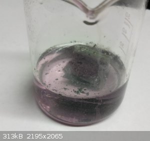

I want to use aluminium cans and sodium hydroxide to make hydrogen.
There is a very thin plastic film coating the aluminium that is really effective in protecting the aluminium from the sodium hydroxide solution.
(I tried NaOH soution in the 1M to 12M range).
Acetone dissolves at least partially the plastic film,
judging more by the residue left after evaporation of the acetone than any increased reactivity of the aluminium.
Anyone know a quick,easy,cheap method of enabling the sodium hydroxide to get to the aluminium ?
For reference, the scale will be multiple batches of 400 litres of hydrogen,
requiring about 24 aluminium cans and 500g sodium hydroxide per batch.
Pieces of aluminium cooking foil added to the mix react quickly and rapidly,
so I still suspect the plastic rather than the oxide.
The aluminium can I tested by tearing into c1" squares,
plenty bubbling aroung the edges, negligible bubbling on the flat surfaces.
The hydrogen is for filling 400 litre balloons with steel wire tethering as a vertical antenna,
so a reasonable reaction rate is required.
EDIT: pieces of aluminium can each approx. 1" x 2" after five hours in c1M NaOH.
A lot of the aluminium has been dissolved from between the inner and outer plastic layers which remain intact !
Four pieces inside-up, one piece outside-up.
AlCan_NaOH.jpg - 2.1MB
[Edited on 23-5-2018 by Sulaiman]

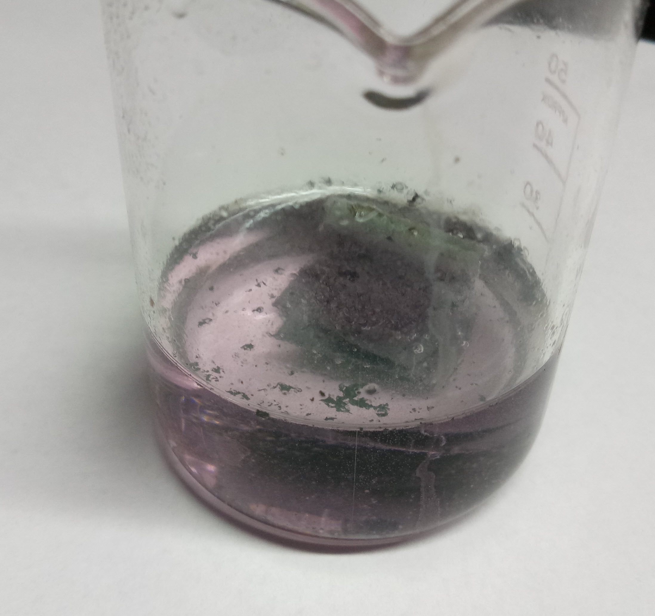

egret - 15-6-2018 at 13:41
Hello everybody
Its my first post here. I atempt a reduction of nitrobenzene by zinc in sulphuric acid. I got a purple coloured solution after filtration of unreacted zinc. Do anybody knows why the the filtrate has a such colour? May be an oxidation product of aniline?
filtrate.jpg - 170kB

Quote: Originally posted by egret
Hello everybody
I haven't done anything with aniline for many years (20 or so) but I remember back in the day that aniline stored in non-airtight conditions would become a similar color after a while. So yes, probably oxidation products is correct. Also probably some condensation products caused by the sulfuric acid. IIRC HCl is typically used for the reduction instead of H2SO4 to minimize such side reactions.
[Edited on 18-6-2018 by stamasd]
Hello everybody
Likely a complex involving p-aminophenol:
http://labmonk.com/synthesis-of-p-aminophenol-from-nitrobenz...
http://www.sciencemadness.org/talk/viewthread.php?tid=27849
http://shodhganga.inflibnet.ac.in/bitstream/10603/126633/11/...
Apparently zinc and acids converts nitrobenzene to phenylhydroxylamine which rearranges to p-aminophenol. Usually this is done in two steps with Zn/NH4Cl for reduction and H2SO4 for rearrangement.

j_sum1 - 14-1-2019 at 19:13
I discovered today that I don't have any zinc chloride. Never mind I thought. I have some zinc from a D cell and plenty of hardware-store HCl of reasonable purity.
After reacting, the resultant solution was a purple/lilac colour. Berating myself, I concluded that stray manganese dioxide from the battery was the most likely culprit. So I repeated with some reagent grade zinc powder.
Same result. It must be some impurity in the HCl. But what? I know that Fe is common but I have tested the acid for Fe in the past with a negative result. Is Mn or Co likely?
[Edited on 15-1-2019 by j_sum1]
2019-01-15 13.12.19.jpg - 313kB
clearly_not_atara - 14-1-2019 at 20:11
^Also, solutions of iron chloride are brown.
The HCl itself isn't colored, but with zinc it is? If it were a simple metal chloride the addition of zinc should not change the color. Mn or Co will be present as the divalent salt which should not undergo any sort of redox in this condition.
However, maybe the HCl is a little greenish? That would indicate chromium, as CrCl3 gives a green solution and CrCl2 a blue one. Additionally various aqua-chloro chromium complexes are slow to interconvert and have many different colors.
