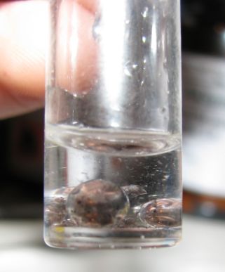

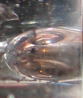

panziandi - 28-3-2009 at 15:54
I just thought I'd share a nice photo of NaK with you all. Hope you like it. The second photo is a closeup of one of the globules. The NaK was prepared by melting potassium and sodium under pre-dried paraffin, it was transfered to a vial, extruded into paraffin under argon from a pipette to remove surface oxide contamination.
CaptureNaK.JPG - 23kB CaptureNaKcloseup.JPG - 22kB

Nice NaK panziandi! It does look very shiny...
