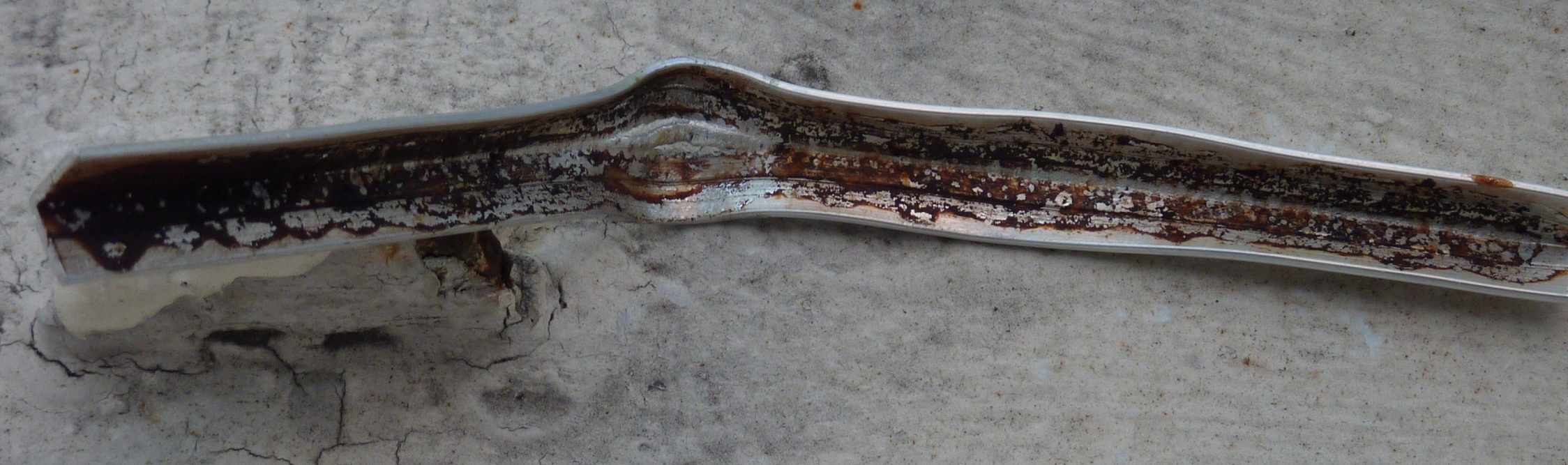

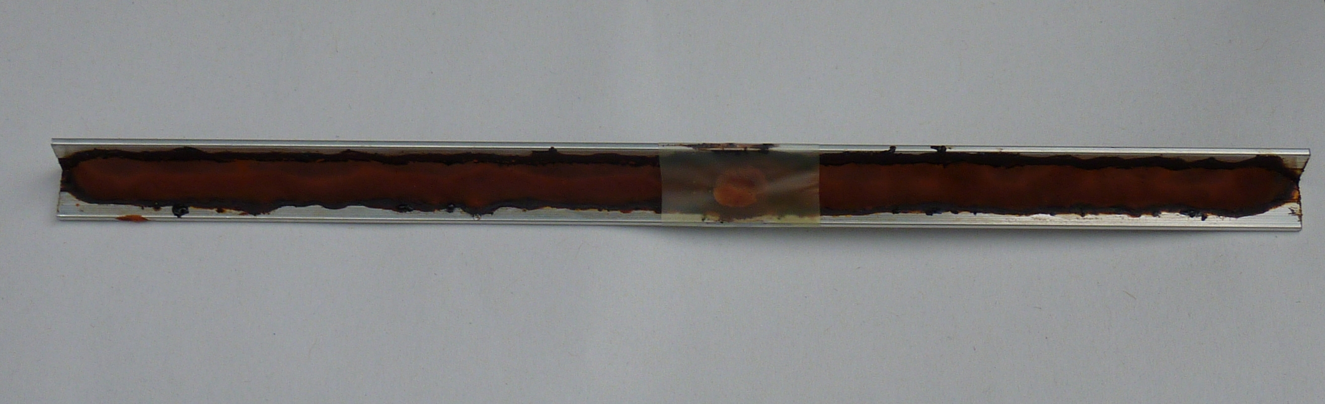

pdb - 17-11-2024 at 14:39
I hesitated to include it in my list of primaries because I’ve never managed to achieve DDT in open air. The substance deflagrates, leaving a combustion residue, but doesn’t detonate.
I even tried initiating it with another primary. The photo shows a trail of 2,4-Dinitro-benzenediazonium perchlorate ("DNBDP") interrupted in the middle by 50 mg of nitrobenzenediazonium perchlorate, which constitutes a pretty powerful initiation. The fire was set at one end, and you can see that the detonation at the center failed to propagate to the rest of the DNBDP.
Microtek, who also prepared it, said that DBBDP could achieve DDT, but neither Axt nor I have been able to make it detonate.

Yes, of course, when the configuration of the charge creates confinement—either because it is contained in an enclosure or under its own weight—the accumulation of combustion gases and the heat released can lead to the formation of a shock wave. Even a low explosive can be made to detonate under certain conditions.
But the question is different when a few milligrams deposited without any compression on a metal plate manage to dent or puncture it. What you say about the N3 radical, where the ejection of one nitrogen atom impacts another N3, merely describes a chain reaction. However, the majority of chain chemical reactions occur without detonation, so IMO this explanation is not sufficient to account for the behavior of primaries.

Axt - 18-11-2024 at 04:41
Good god pdb, it's been just shy of 20 years it's good to see you made it to 75 posts haha. This is off topic though, it's not a complex salt and the original thread is here http://www.sciencemadness.org/talk/viewthread.php?tid=3681 . Yes, I made the dinitrobenzenediazonium perchlorate and yes its ability to DDT is lower than that of the less nitrated homologues. Its counter intuitive for numerous reasons but is clearly shown in practice. It's likely due to balance between the electron deficient diazonium group and the electron withdrawing nitro groups creating a stronger bond overall. Most sensitive to least is benzene>nitrobenzene>dinitrobenzene, a clear pattern with the worst of all being the benzenebis(diazonium) diperchlorate derived from phenylenediamine which likes to detonate in solution. On the other side, one would expect electron donating groups such as methyl (aminotoluene) to create a more sensitive diazonium salt than even that of benzene.
I'm not sure what your photo is showing btw, it looks like an orange blob taped to the middle of some angle iron. I've never confined dinitrobenzenediazonium perchlorate but assumed it would DDT given any excuse with confinement.
I'll try to be more explicit. It's a pyrotechnic train consisting of a segment of 2,4-dinitrobenzenediazonium perchlorate, followed by a segment of 3-nitrobenzenediazonium, and then another segment of 2,4-dinitrobenzenediazonium perchlorate. The result shows that the detonation of the 3-nitrobenzenediazonium (which bent and pierced the angle iron) did not cause the 2,4-dinitrobenzenediazonium perchlorate to achieve DDT. I had conducted other tests at the time and failed to achieve DDT.

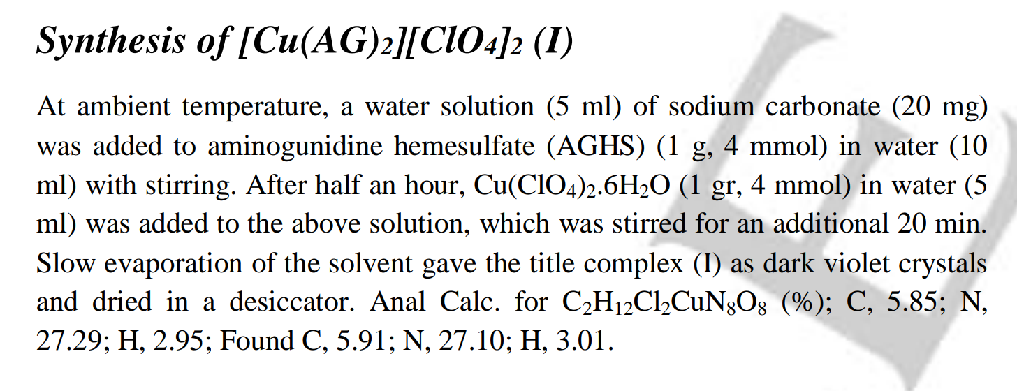

How about Copper(II) Perchlorate Complex with Aminoguanidine?
According to the "Synthesis, Structural and Energetic properties of Copper(II) Perchlorate Complex with Aminoguanidine", its thermal behavior is not much lower than that of NAP: 215°C vs 230°C.
However, I am afraid that the combination of copper and hydrazin bond will make the product unstable and dangerous.
Also, I found a youtube video with this substance. However, the author prepared not a pure substance that does not work.
I want to make a pure product without impurities of sulfate or acetate.

copper agn perchlorate.png - 870kB
Etanol - 20-11-2024 at 14:32

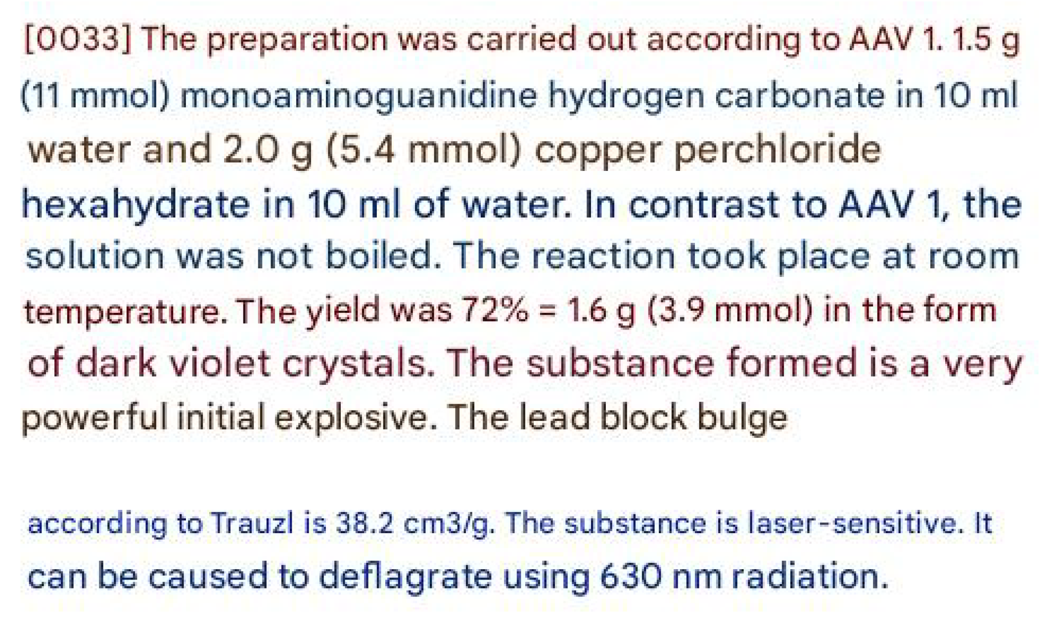

Thank you. But apparently this is Fake. Copper aminoguanidine perchlorate cannot exist.
When trying to synthesize, aminoguanin perchlorate slowly oxidizes copper perchlorate in a Cu2O in an hot acidic environment and instantly does this in a slightly alkaline environment.
Laboratory of Liptakov - 22-11-2024 at 07:03
Copper perchloride ? Such errors do not writte anyone from this forum. Text looks a like bullshit from AI.....:cool:
Axt - 22-11-2024 at 10:25
You literally just linked to another prep of it, are you saying they are both lying and are both "fake".
The other is a google image translate of the patent.
Screenshot 2024-11-23 051022.png - 261kB
Laboratory of Liptakov - 23-11-2024 at 09:02
The time has come when you can't believe everything you see with your own eyes. Another error....hemesulfate ....Yes, aminoguanidine hemisulfate exist: https://pubchem.ncbi.nlm.nih.gov/compound/Aminoguanidine-hem...:cool:

Axt - 16-12-2024 at 12:36
The DPPE-1 I trust to at least perform, as another member here shared some of his experience in preparing it along with showing properties. I made what I thought to be the K-DABCO-ClO4 too, though that burned about as well as black powder (like you mention with the DAN-2). I have around 500g of DABCO though, so those perovskites are more enticing at the moment than tetrazole complexes.
I may try a CuAG-IO4 complex now that I think about it, may be an interesting alternative to NAP if it hasn’t already been tried and found to be shit.
[Edited on 14-12-2024 by dettoo456]
I'd be happy to be proven wrong, but I don't think copper will form complexes with periodate. I have tried it with ethylenediamine and ammonia and only received what I took for copper periodate (I'm sure that can be easily tested, but I haven't). Light green powder that when ignited It would smoulder through the mass releasing a bit of iodine smoke.
The potassium DABCO perchlorate and its ammonia analogue burn more like some type of rocket fuel. Potassium DABCO nitrate I would have loved to be a blackpowder like propellant, but as best I can determine just turns black and splutters a bit.
MineMan - 18-12-2024 at 14:52
There is a thread on this, where the user compares it to NAP.
MineMan - 18-12-2024 at 14:53

. How does carbohydrazide react to being ignited, or heated on a spoon/foil?
Compared to attachment.
Attachment: maybecarbohydrazide.mp4 (4.2MB)
This file has been downloaded 222 times

Microtek - 15-1-2025 at 11:21
My carbohydrazide melts, ignites and burns with a pale flame while emitting a hissing/roaring noise. It leaves no residue and produces no smoke. The ZnCP, when ignited in the open, flashes and burns while spitting out particles. It is not as fast as flash powder and doesn't burn as completely, often blowing itself out.

Axt - 15-1-2025 at 12:07
That description of carbohydrazide would fit mine when its heated underneath. as does the self-extinguishing albeit mine sounds less energetic. I've has a few things sputtering and self-extinguish, the silver aminotetrazole nitrate and copper triamino nitrotetrazolate does as well.
