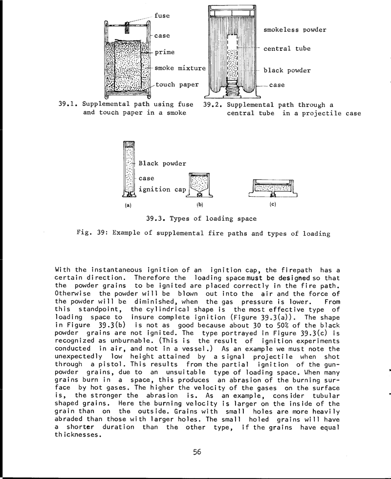

The WiZard is In - 18-4-2011 at 12:57
Quote: Originally posted by quicksilver
Blasty:
I accidentally lost your comment it responding to it: apologies. But it DOES explain the Cab-o-sil issue indeed. You were right on track (IMO). Yes. anti-caking agents really DO have a positive affect. As do the use use of "spread" size spectrum ingredients. Whenever exampling a deglagration of DDT element, especially in a mechanical composition, you will see this agenda often raise it's head.
Cab-O-Sil has always worked for me, and when it worked it worked
well. I would posit three reasons —
It it v/ very hard and not compressible thus creating interstitial
space through which the flame can propagate.
Its specific heat is high enough that it helps transfer heat through
the comp.
I have found that when it is added in small %'s if the case is
tapped on a hard surface ... 5-10% more comp can be loaded
into the case.
These from the late Dr. Shimizu's Fireworks From A Physical
Standpoint, a translation from the German by Alex Schuman
of Feverwerk von physikalischem Standpunkt aus (1976).
Published in four parts by Pyrotechnica Publications, 1981.
With a little simple math you can calculate the IS of spheres. To
find it in layered spheres ... a bunch of ball bearing or some such
and a graduated cylinder would enable on to derive a formula to
calculate it for different size spheres. For the truly driven it can be
approximated by mercury porosimetry.
NB - Dr, Shimizu's comment about large particle black powder
burning faster ... only works in open systems... thus cannon use
large particle BP, rifles/pistols faster burning small particle BP.
Shimizu-fire-path-1.jpg - 264kB Shimizu-fire-path-2.jpg - 235kB Shimizu-fire-path-3.jpg - 263kB Attachment: phpm47lXr (248kB)
This file has been downloaded 1178 times
