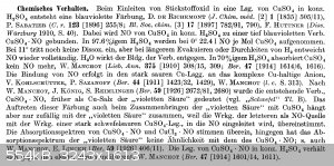

Atomistry, as so often, is very interesting, but gets some things wrong.
A better source of information is of course the Gmelin Handbook of inorganic chemistry series, which sadly is non digitalized. The information is from Sulfur part B pages 1630ff.
IMG_20200207_144904.jpg - 1.4MB
They call this compound Nitrogen Oxide Nitrosyl Hydrogen Sulfate with the formula N2O2HSO4, or better (ON.NO)HSO4, the most common name is "blue acid" but "purple acid" describes the color much better.
This compound can be formed in a variety of ways, but it is unstable, can't be isolated (probably) and even in conc. sulfuric acid only stable for a few days. Nonetheless, it is very impressive.
It can either form from the reduction of NOHSO4 in sulfuric acid by metals, sulfur dioxide, some organic compounds, and nitrogen monooxide under pressure. There are some more but more exotic methods.
Some more information can be found here: Seel, Ficke, Riel, Völkl, 1953. The doi is 10.1515/znb-1953-1011

I have in the meanwhile found the answer to the questions on what the copper now actually does. It turns out it is something quite different, not a salt of the purple acid. Rather, the purple acid just serves as a donor of NO. In strong sulfuric acid, copper will form an addition compound with NO, denoted by Gmelin with CuSO4 · NO. This is indicated by the fact that it can be made from pure NO and copper sulfate in strong sulfuric acid, and its absorption spectrum has nothing in common with the one from purple acid. It is water sensitive and hydrolyses below 70% it seems. Another nail in the coffin is that copper chloride actually forms the blue color too, giving CuCl2 · NO, and its absorption spectrum is the same. It would be interesting to try this, dissolving anhydrous CuCl2 in alcohol or acetone, then passing NO into it. I assume this is or at least is related to the blue complex that woelen obtained in the experiment linked earlier.
The source is Gmelins handbook of inorganic chemistry copper part B-1 page 579:
CuSO4 x NO.png - 554kB

Diachrynic: I found paper about reaction of Cu(0), Cu+ and Cu2+ with NO in strong acids. End product of these reactions is [Cu(NO)]2+ complex, which you mentioned in your post.
Cu + 3NO + 2H+ --> [Cu(NO)]2+ + N2O + H2O
2Cu + 4NO + 4H+ --> 2[Cu(NO)]2+ + N2 + 2H2O
2Cu+ + 4NO + 2H+ --> 2[Cu(NO)]2+ + N2O + H2O
Cu2+ + NO <--> [Cu(NO)]2+
https://sci-hub.se/https://www.journal.csj.jp/doi/abs/10.124...

Bedlasky, that is a great find! That is exactly what I was looking for and confirms the text from Gmelin but in more detail. Thank you!
Lion850, thanks for this contribution as well! The more sources mention the compound the more weird it seems I (and many others that I asked) had literally never heard of it before I randomly stumbled over it. The formula given is slightly different but not too far off from the modern interpretations.
Here are three more relevant papers:
Wright, Wu, Hayton, 2010, "Structural Characterization of a Copper Nitrosyl Complex with a {CuNO}10 Configuration", doi: 10.1021/ja105930b
Fraser, 1961, "The dissociation of nitric oxide-copper(II) halide complexes in alcohols. The preparation of the copper(II) fluoride nitrosyl", doi: 10.1016/0022-1902(61)80150-4
Fraser, Dasent, 1960, "The Composition of the Nitric Oxide Complexes of Cupric Halides", doi: 10.1021/ja01487a022
The last one seems very relevant for the experiment woelen performed. I assume halides can stabilize the blue complex so it doesn't decompose as fast in water and without it strong sulfuric acid is needed as the solvent.
This is a very interesting tangent from the purple acid. The paper Bedlasky found by Tsumori and Xu plus the Gmelin entry demonstrate that copper actually decomposes the purple acid and just using its NO to form a much more strongly colored complex itself. This means that no copper is the way to go if actual purple acid is desired. Still, a very interesting experiment in itself.
