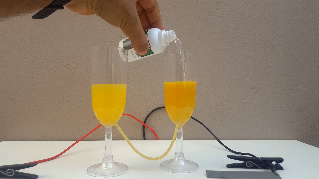

For this, I built a "cell" made up of two plastic cups joined by a thin transparent tube. In other words, a cheap (but functional) imitation of a typical "U-tube" that you would find in any minimally equipped laboratory (photo 01)

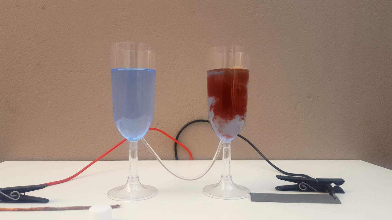

The electrical resistivity obviously got a little high, it took 24 volts to make the electrolysis happen at a reasonable rate. Anyway, after some time, CuCl accumulates in the anolyte and, allowing the liquid to flow from one compartment to another, CuOH precipitates. It is a very beautiful color, ranging from bright yellow to solid orange (photo 02)

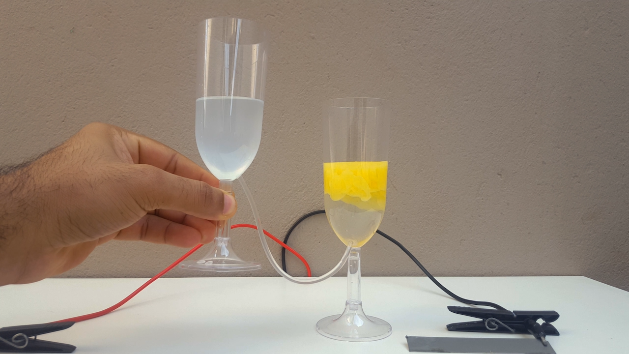

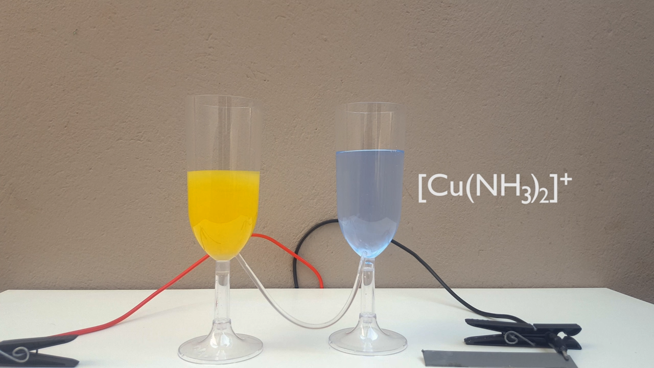

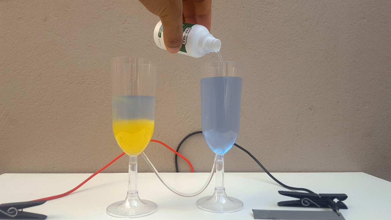

When adding ammonia to the produced CuOH suspension, the liquid changes from a solid, opaque color to the "soft blue" of the complex formed, presumably diamminecopper, [Cu(NH3)2] + (thanks to DraconicAcid for helping me find out the name of the complex formed by the interaction of Cu(I) and NH3).
(photos 03 to 06)

Btw. the pale blue color in your experiment is not the color of the Cu(NH3)2(+) complex. That complex is really colorless. The pale blue color is due to the presence of some Cu(NH3)4(2+). Because of oxygen from the air (or dissolved in the solutions and the ammonia you used), some copper(I) is oxidized to copper(II), leading to the formation of the blue complex.
