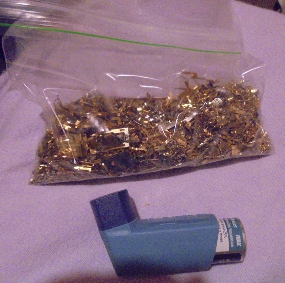

+ All phones yielded bit over 200 grams of gold plated pins.
[Edited on 23-6-2021 by Romix]
gold pins.jpg - 198kB

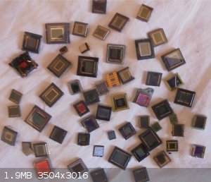

Romix - 23-6-2021 at 05:58
Ceramic lenses from old digital cameras, under 4 megapixels.
Maybe someone have a small device to crash them, interested in buying one.
They'll break average kitchen blender.
DSC00039.JPG - 1.9MB
