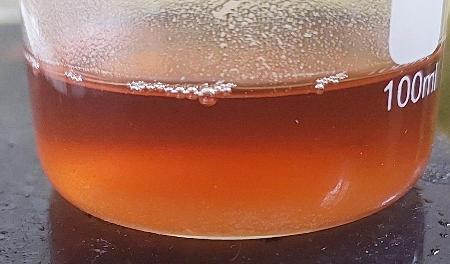

Altreon - 25-12-2025 at 22:44
I repeated the procedure again, with twice the amount of MnCO3. I added enough HCl to make the solution a somewhat clear brown color. I then added 5g MnCO3, along with 50% H2O2. This is where the procedure deviates. No matter how long I refluxed, even after filtering and adding more MnCO3 (totalling over 10g) or more H2O2, the solution was much more difficult to filter and the red(!) filtrate always had some of the brown MnCO3. The last time I did this, the filtrate was very pure and easy to refilter. I tried refluxing with extra water, hoping to force hydrolysis, and with less water, hoping to "catch" more of the Fe3+, but I was eventually left with a solution that was very clearly not a pure pink (peach? it looks orange on camera). After boiling down the solution and refluxing with 2g MnCO3 in a last ditch effort, the filtrate went back to being red with particles going through. I have no idea what I did wrong this time. The pH of the soln. stayed at 3-6 for a long time, meaning I probably didn't reflux the soln. enough, but the really red filtrate is neutral. The color was really unlike Mn2+ or Fe3+.
I added drops of conc. NH3 at this point, creating a white ppt. that slowly turned brown, and turned very brown with H2O2. This stuff filtered into a dark brownish red soln., which is probably a colloidal Fe(OH)3.
Attached images are of the cleanest the filtrate got, and the filtrate just before and after I added ammonia.
(1).jpg - 39kB (2).jpg - 66kB (3).jpg - 404kB
[Edited on 26-12-2025 by Altreon]

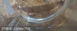

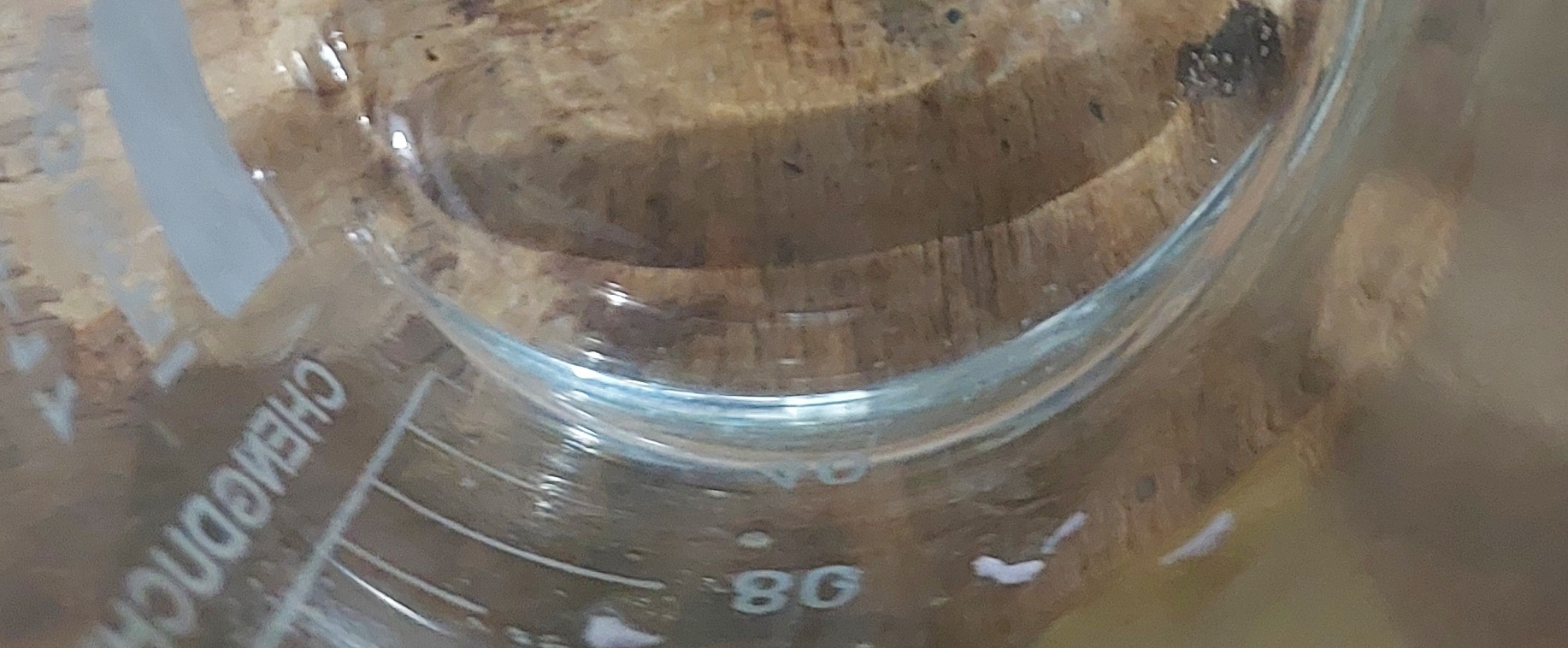

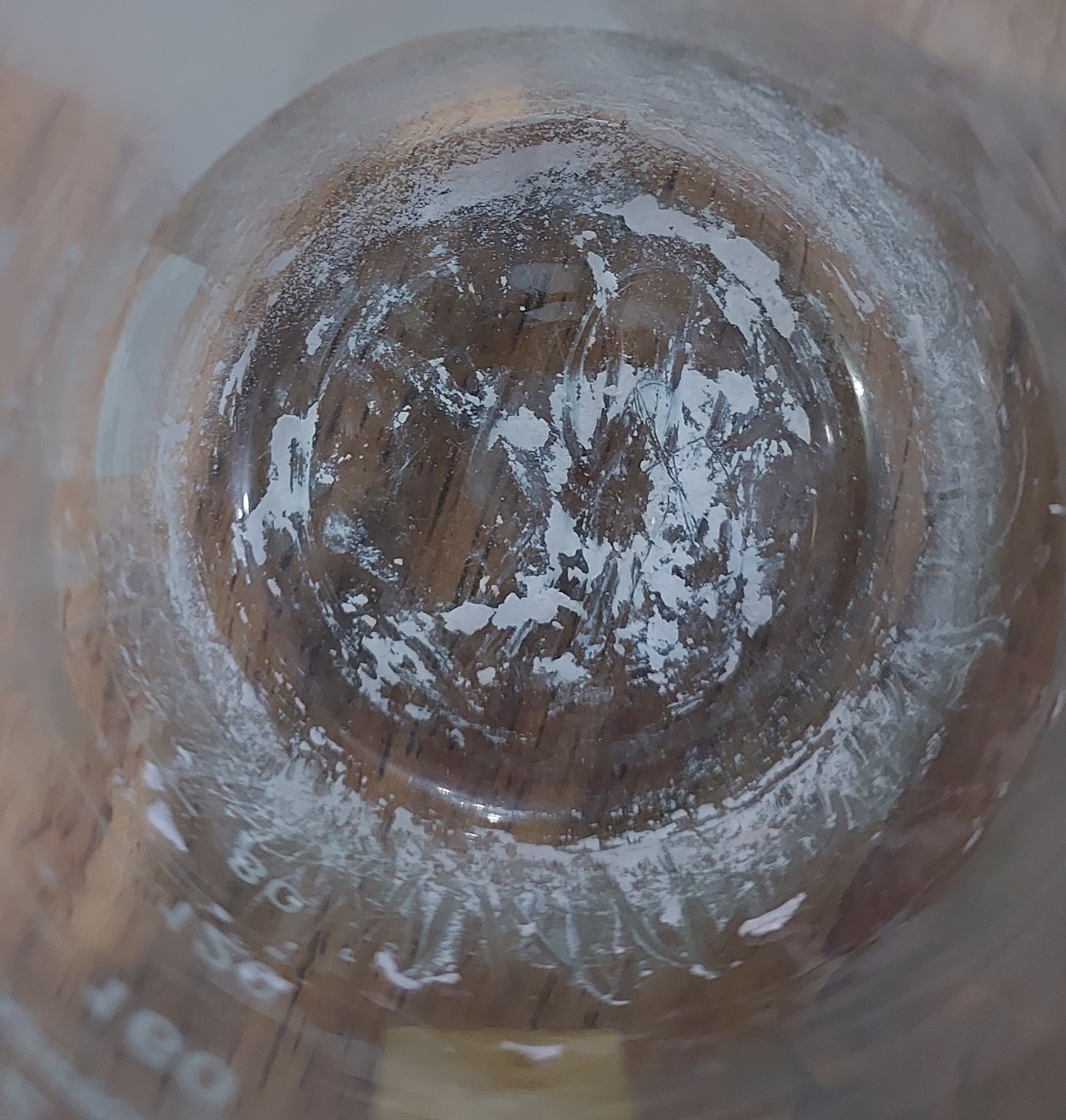

Altreon - 26-12-2025 at 08:42
I have successfully synthesized 13.5g of what may or may not be anhydrous MnCl2, accompanied with visually severe oxidation, despite my attempts. I will explain in detail tomorrow.
Altreon - 27-12-2025 at 06:17
After I repeated the procedure from my first post here, it seems that MnCl2 shares a property with CoCl2, CuCl2, and possibly all transition metal chlorides where the first step in dehydration turns the substance rock-hard. For MnCl2, it seems that resulted in very visible amounts of oxidation products forming at the bottom of the beaker. After breaking up the rock and spreading it over a wider beaker, I managed to stop all oxidation even when heating the pwdr. to 280°C, leaving me with an off-white slightly pinkish pwdr. If I spread the pwdr. out initially (which appears to be @bnull's suggestion, which I now understand) then maybe oxidation would have lessened.
The fact that, even with the methanol, the pwdr. still oxidized, makes me willing to believe that the literature must be doing something quite unusual (i.e. the dry HCl and NH4Cl methods rather than simple dehydration), and that it is probably a futile task to dehydrate MnCl2•4H2O without significant oxidation if even the MnCl2•xMeOH•xH2O adduct cannot stop the hydrolysis (which is equivalent to oxidation) completely. Another observation is that MnCl2(aq.) added to an excess of MeOH causes a faint white gel to ppt. at r.t., indicating that MnCl2 is so much more willing to coordinate with H2O that it wouldn't even let itself get solvated by the MeOH, and that the MeOH additions probably don't completely dissociate the MnCl2 aquo complex, leading to the unfortunate oxidation of my product.
Finally, my last failure was due to insufficient H2O2. It seems that trace Fe2+ is enough to slowly turn the solution acidic and very hard to filter (a pH paper displaying neutral pH after being dipped in the soln. became red after an hour).
I have analyzed the 2nd source you have graciously provided in further detail. It seems to suggest that the green complex that I've been associating with methanol all this time is actually a thermochromic aquo complex involved with the decomposition(!) of MnCl2•4H2O that apparently turns "rose-red" or "yellow" under some* heating conditions and can be formed by ethanolic solns(!). I have never observed any of these colors and crystals, so I cannot say if this article is accurate, but it also supports that MnCl2 cannot just be heated to dehydration, further proving the side of fellow amateur chemists rather than Mellor and the rest of the old literature's descriptions. I am unable to translate the 4th source in full.
The attached images are of the oxidized MnCl2 and the final product.
whywhywhy.jpg - 133kB mncl2.jpg - 70kB

MnCl2
Altreon - 8-1-2026 at 19:10
Well, I didn't expect this thread to get as much attention as it did. Not that anyone is interested in the actual MnCl2, rather it seems to have spiralled into some theoretical discussion that I am too ignorant to participate in.
To bnull: I can't seem to find any links to the supplementary paper, so I can't provide it. I'd like to try out this synthesis of MnCl2 myself, but I am currently trying to obtain a 10cm borosilicate dish for this process. I will be preparing ≈30g of anhydrous MnCl2 with excess HCl.
I've recently been working on anhydrous NiCl2 as well, and it seems that both compounds I've prepared produce a cloudy suspension in MeOH despite them dissolving completely in water. NiCl2 only produces a faint green color in the organic solvents. Does anyone have a pure sample of either compound who can observe their solubility in organics? AFAIK they are similarly covalent to CoCl2 and CuCl2, which both dissolve easily and form strongly colored complexes with alcohols, so NiCl2 and MnCl2 should behave similarly.
