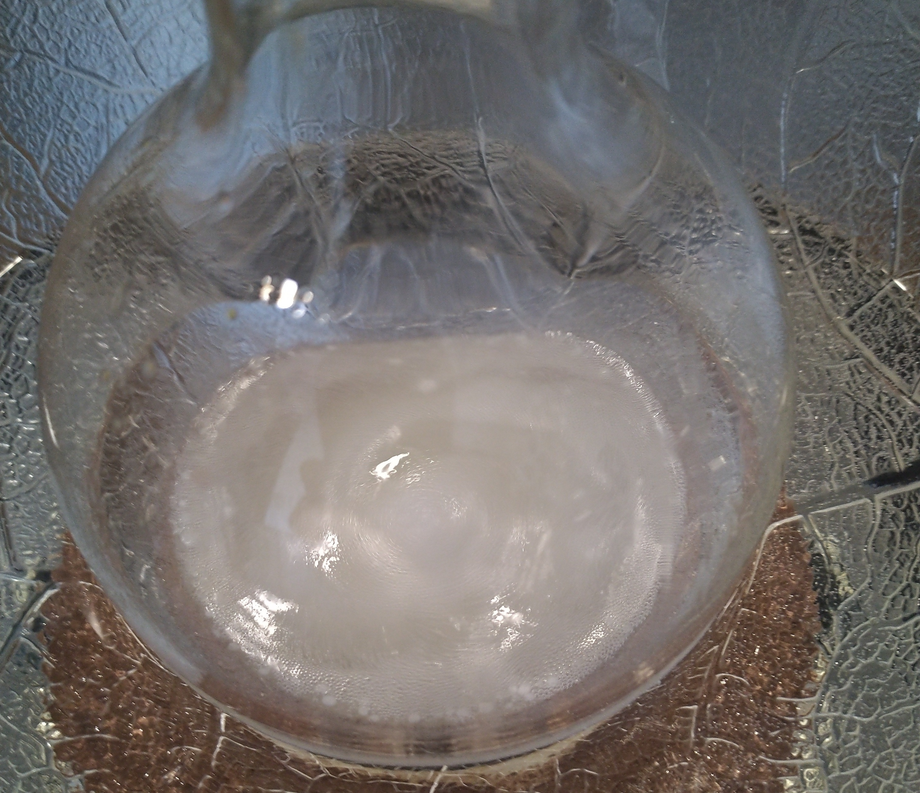

IMG_202601.jpg - 2.1MB
first part - lose color
IMG_202602.jpg - 2.2MB
second part - refluxing
IMG_202603.jpg - 1.3MB
hydrofumarate presipitation
Workup
The reaction mixture is poured into a 150 ml beaker and the flask is rinsed with 10 ml of IPA. The layers are immediately separated, with the IPA-amine layer on top and the aqueous layer below. 25 ml (7 g NaOH + 20 ml H2O) are added. The upper layer is carefully separated to avoid dark copper flakes. The aqueous layer is then extracted with two 15 ml portions of IPA. A saturated solution of K2CCO3 (18 g + 20 ml H2O) is prepared. The IPA solution is shaken twice with 10 ml of K2CO3, then dried with MgSO4. The result is approximately 55 ml of a clear, slightly yellowish solution of amine in IPA. The alcohol is evaporated, and the resulting solution is dissolved in 10 ml of acetone. A solution of 0.8-0.9 gr fumarik acid is prepared in hot acetone and added to the amine solution until pH = 6. White crystals of hydrogen fumarate immediately precipitate; after washing with acetone and drying, 2.75 g (0.0077 M) was obtained.
