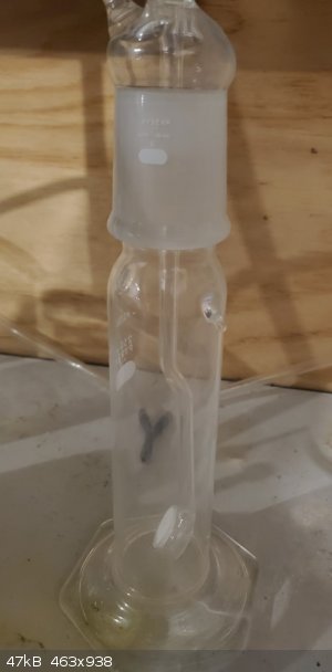

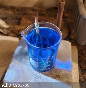

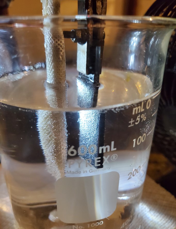

Experiment: Hydrogen Peroxide by Sulfuric Acid Electrolysis

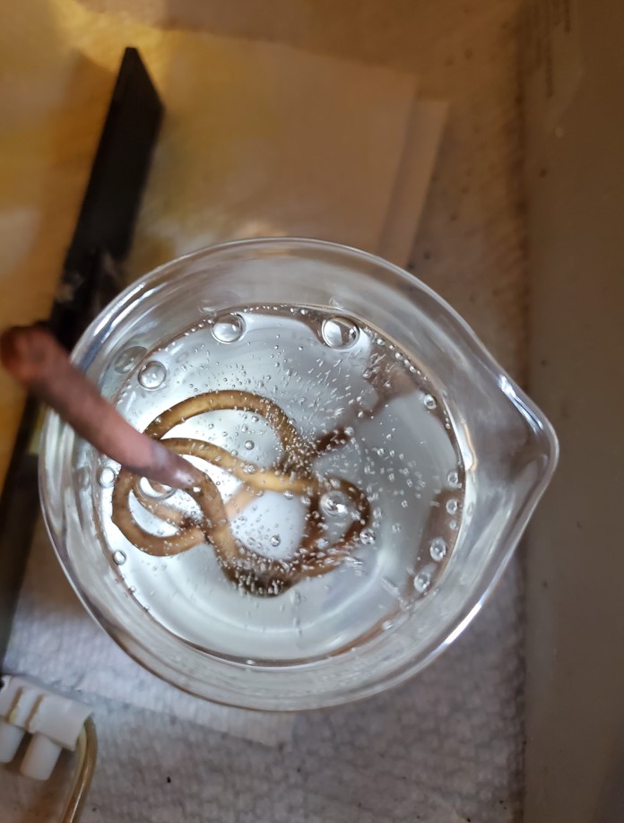

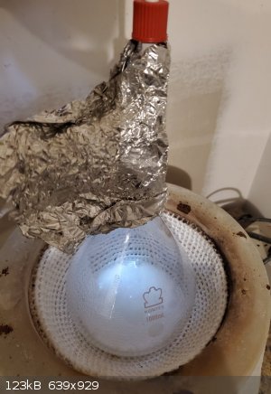

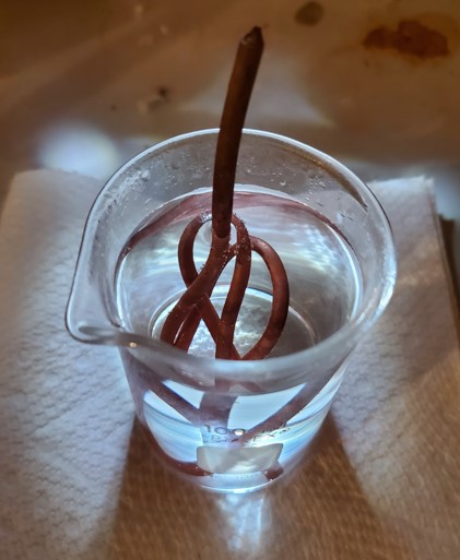

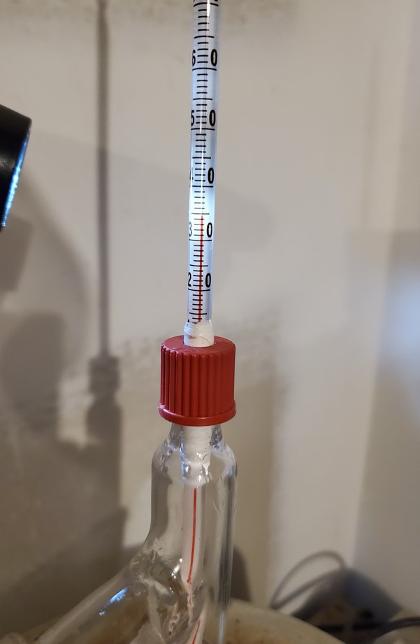

Mister Double U - 13-6-2025 at 09:57
Breathing some fresh air into this threat.

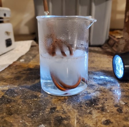

I prepared a ~50% H2SO4 solution and started electrolyzing.
Current: 3 [A]
Cathode: Titanium mesh
Anode: Boron Doped Diamond
Current Density on Anode: ~250 [mA/cm^2]
Here some pictures:
720g ice cubes & 750g H2SO4 (Drain Cleaner):
Acid.jpg - 189kB
The setup:
Setup.jpg - 127kB
Electrolysis after 2 hours:
After 2 Hours.jpg - 154kB
Electrolysis after 12 hours:
After 12 Hours.jpg - 132kB

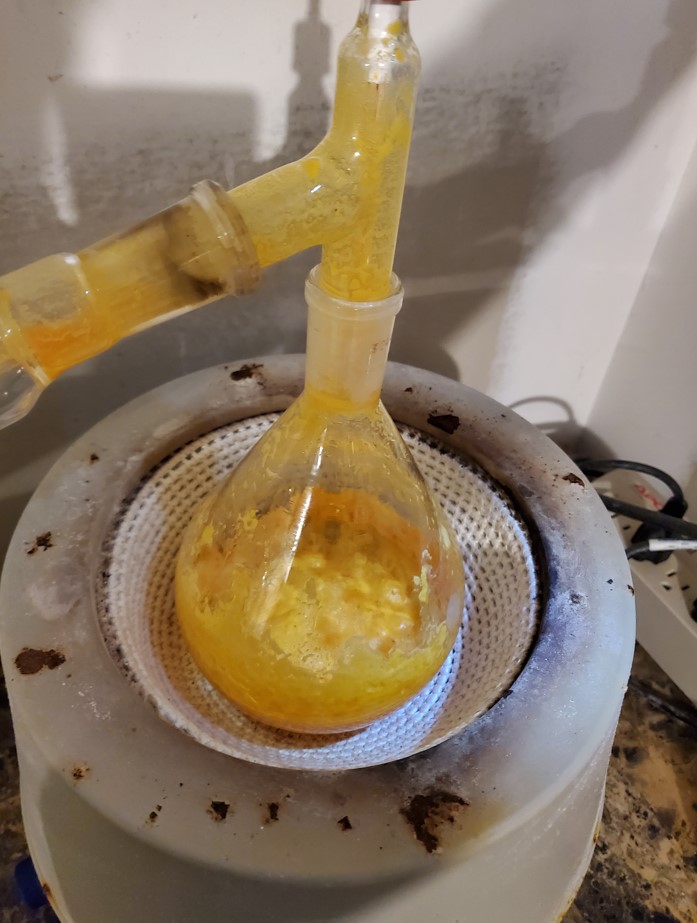

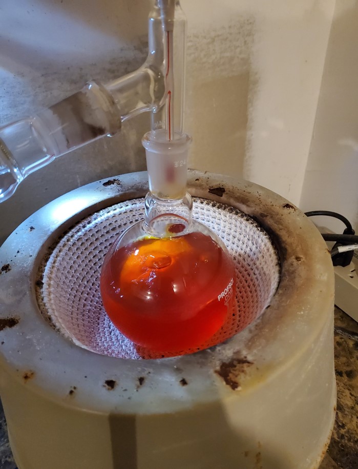

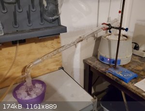

I was not expecting to see any colors in this experiment. Because of this I assumed that the H2SO4 was contaminated, and I distilled the whole batch.
I also reduced the amount of water in the acid a little, so it should now have ~55%.

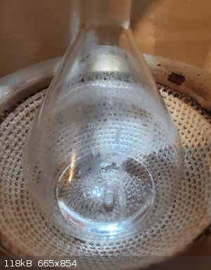

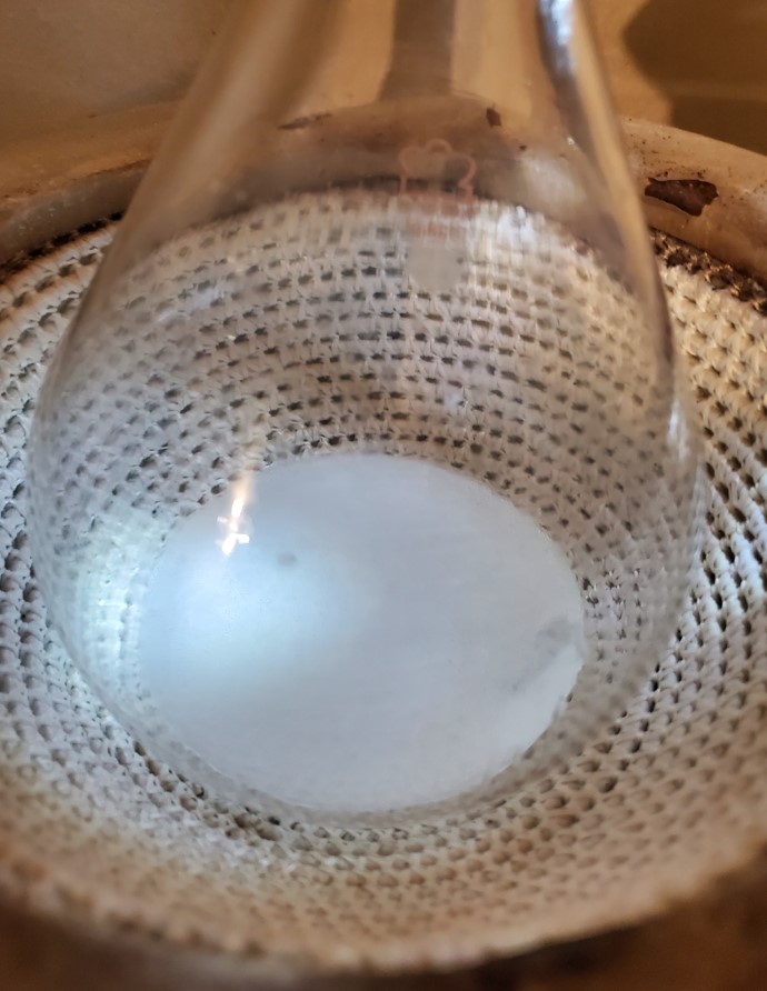

Here the residue in the distillation flask:
Residue.jpg - 135kB
There is some green color visible in the residue and my guess is that this is Iron(ii) Sulfate. I heard somewhere that sulfuric acid plants use iron piping, as high concentration acid does not readily attack iron metal. So, this would make sense.
I then restarted electrolysis. To my great astonishment, the same orange color appeared again. After a day, it is as red as the 12hr picture above.
I did find an article about some unspecified Titanium-peroxo complex, which is orange or even red in sulfuric acid:
"pH Effect on the Optical Properties of Peroxo-Titanium Complex"
"Interesting optical properties of peroxo-titanium hydrogen peroxide complex against pH changes were studied for the first time using an analytical UV-VIS spectrophotometer. A freshly prepared peroxo titanium complex with pH value of 2.21 exhibited an orange color. This color changed to light orange, cloudy yellow, and then translucent pale-yellow as its pH value increased to 3.9, 5.8 and 6.7 or above. UV-VIS spectra show that the fresh complex had an absorption band rising at wavelength around 400 nm to higher energy, but had no maximum peak. A new absorption peak appears at 245nm for the cloudy yellow samples. This is similar to that of colloidal TiO2, which suggests that TiO2 particles might form upon increasing pH value to or above 5.80. The formation of TiO2 particles was accelerated in the pH value range from 6 to 9, but not in the acidic environment. In H2SO4 acidified environment, the color turned red-orange instead, and a strong absorption at 397nm was observed only at pH =0.99. Based on the experimental observations, a model for the color-forming species and possible applications by using the techniques generated from the present study were proposed."
I derive from this, that the Titanium cathode is slowly dissolved and forms this beautiful color with H2O2 present in the solution. I will let the cell run another day and then attempt to vacuum distill the content - let's hope something is there :-).

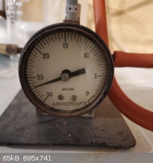

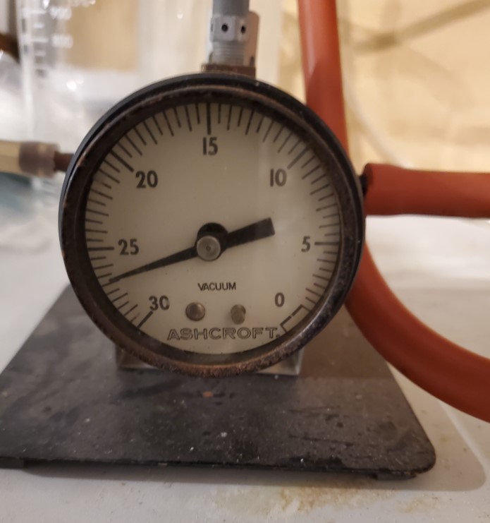

Max vacuum the pump could reach:
Pressure.jpg - 98kB

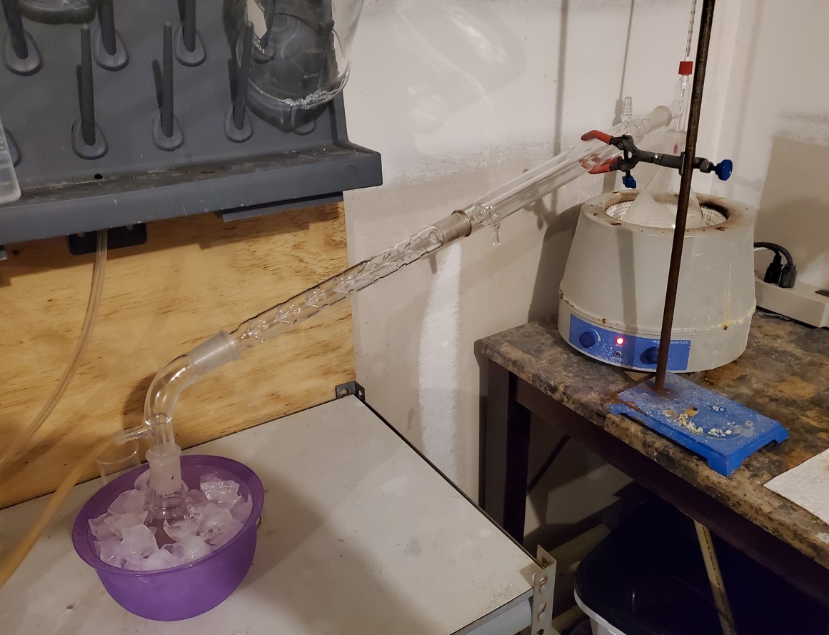

Distillation setup:
Setup.jpg - 199kB
Liquid in flask before distillation:
Before Distillation.jpg - 94kB

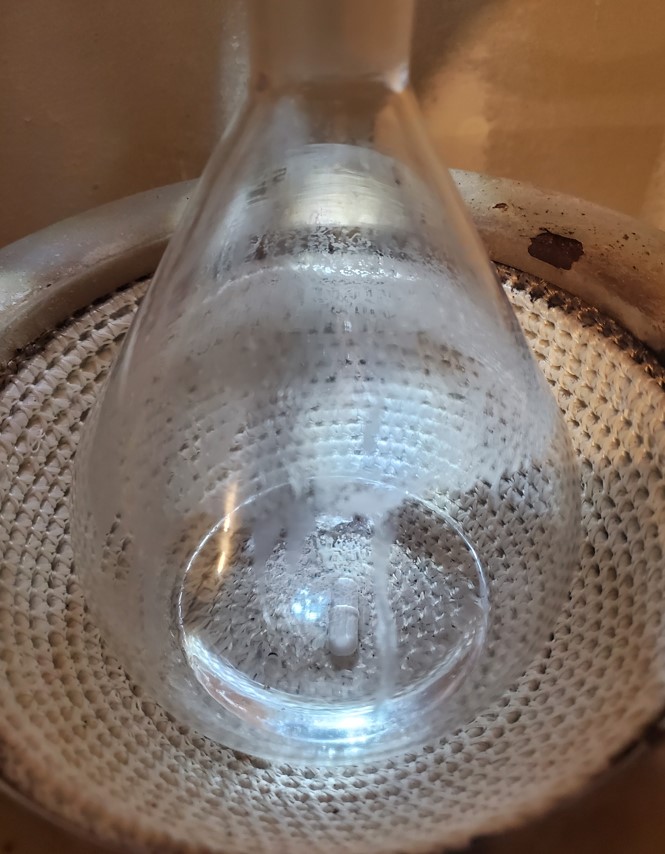

Liquid in flask after distillation:
After Distillation.jpg - 119kB
Before I started the distillation I tested if both the distillation flask and also the receiving flask could hold the vacuum without imploding. This was done by wrapping them in a thick towel and then placing in a heavy-duty plastic crate.
After the first half of the distillation the liquid in the distillation flask went to almost colorless. During the second half, the temperature was increased, and the liquid became greenish. Does anyone know what that green color could be?

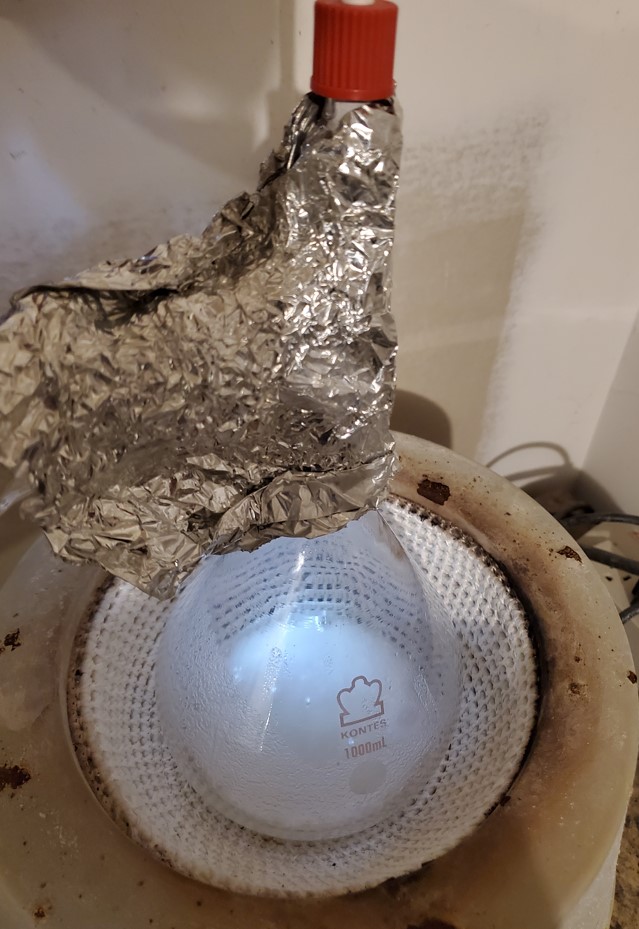

Anyway, I still got the second half of the batch. I want to wrap the distillation flask in aluminum foil, so less hydrogen peroxide condenses on the way up. The setup is a basically a very simple rectification column. Also, I want to improve the cooling on the receiving side, so I can distill quicker (first half took almost 2 hours).

Just distilled the second half with the improvements mentioned before. I also added 100ml of distilled water to the acid in hope I could distill something over at a lower temperature / concentration. But this did not work. I tested the obtained solution by heating with an oxidized copper wire. No fizzling was observed. I repeated that with a bought 3% H2O2 and it fizzled vigorously. So, no H2O2 at all.

1. Get a greater vacuum. My pump creates a vacuum of 55 cm-Hg which should be 180 mbar. Commercially this distillation is done by lower pressure.
This website (https://chemistrypage.in/hydrogen-peroxide-properties/) states that it is distilled at 26 mm (I assume Hg as it did not state) this would correspond to ~31 mbar. The website also states that water jet pumps can get down to these kinds of absolute pressures.

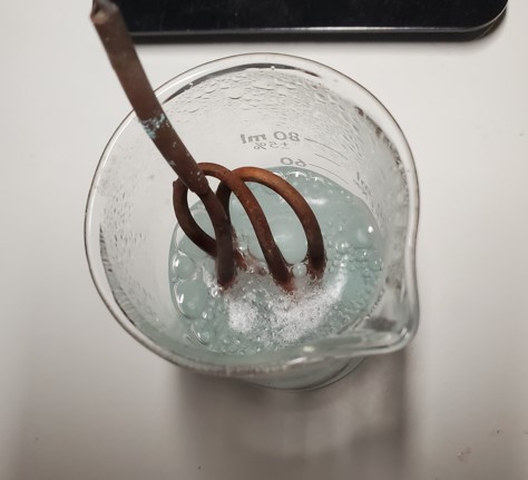

50 ml of anode liquor + 50 ml of water with copper after some hours:
Copper Sulfate.jpg - 117kB

Conclusion: Generation of Persulfate somewhat successful for the high temperature, but only traces of H2O2 survived distillation. Again, the pressure might need to be lowered further to get real amounts of H2O2.

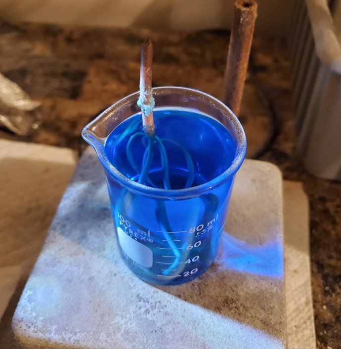

50ml of the anolyte were diluted with another 50ml of H2O and some Copper was left in the solution until no more reaction took place. The weight loss of the copper was 0.3g. That means that there were 0.3[g]/63.5[g/mol]*194[g/mol] = 0.91g H2S2O8 in the sample (7.3g in the whole annolyte. This result seemed not very encouraging.
I did remember though that a couple years back, when I tried to make Sodium Persulfate, that I had better results with lower concentrations of the salt vs adding more NaHSO4 over the course of the electrolysis. So, after this, I repeated the experiment with ~30% H2SO4. Run time was ~1day.
Results 2:
100ml of the anolyte were taken and a piece of Copper introduced. Weight loss of Cu was 1.44g -> There were 17.6g H2S2O8 in the whole anolyte.
So, in one day the amount produced was more than double compared to the 2-day-run with the 60% acid. Astonishing is that in literature (e.g. The manufacture of Chemicals by Electrolysis) it is mentioned that concentration needs to be rather higher than lower.
Anyway, I want to do another run with 20% acid and see how that works out.

The current efficiency for this run was 33.5%.
To test the purity of the product, 10g were dissolved in 100ml of water. The solution needed to be heated to ~50C for all K2S2O8 to dissolve. Then dissolution of a piece of Copper was measured as in the previous experiments.
2.4g were dissolved. For that amount of Cu to dissolve, it takes ~10g of Persulfate. In other words, the product was almost pure.

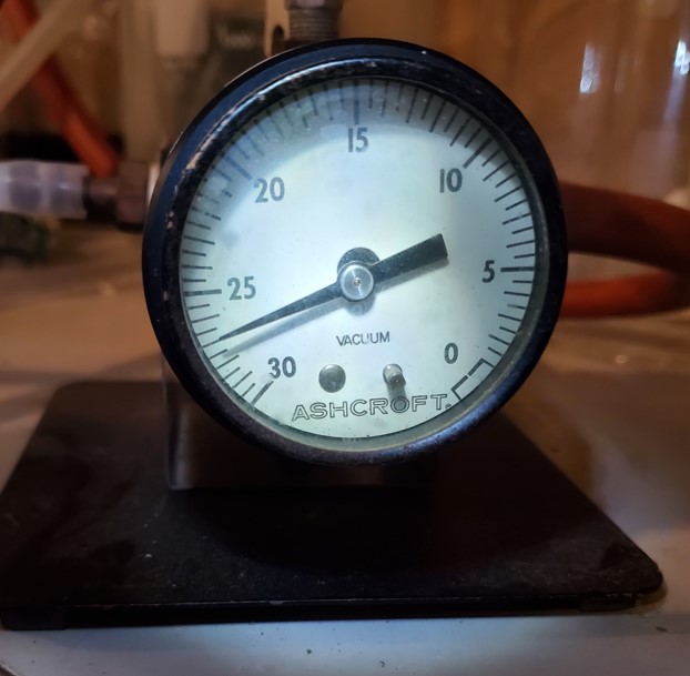

Max vacuum the pump could reach was 27 inHg. Which converts to ~100mbar absolute pressure.
The distillation temperature was 65C.

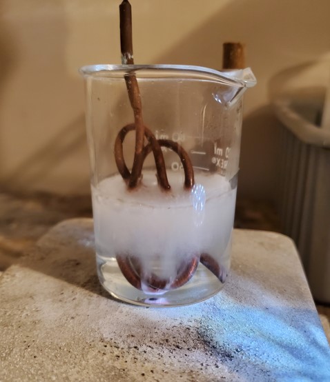

After the previous failures, I wanted to see, if H2O2 can be distilled at 100mbar without decomposition or if the pressure is just not low enough.
Boiling started around 35C. From there the temperature slowly rose to 45C and remained there for the rest of the distillation (+/- 5C, my thermometer is not very accurate).
It did not look like any decomposition was happening at all. I only saw big 'boiling' bubbles and no small foaming 'decomposition' bubbles.

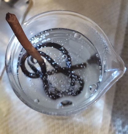

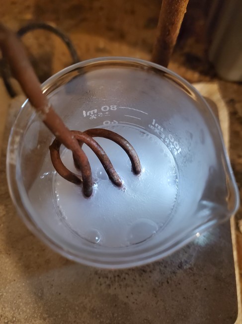

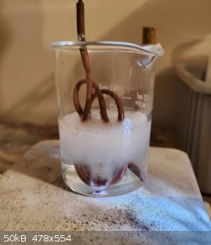

After the first half distilled over, I heated the liquid with some copper wire.
Gas evolution was visible:
First Fraction.jpg - 78kB
When the rest of the liquid was distilled over, the same test was performed as previously.
Vigorous gas evolution was visible:
Second Fraction.jpg - 68kB
Second fraction kept bubbling for several minutes after being taking of the hot plate:
Seconf Fraction without Heating.jpg - 75kB
Conclusion: Hydrogen Peroxide can be distilled at this pressure without decomposition. Since Persulfates were clearly created in previous experiments, the problem lies withing the hydrolysis / distillation (contamination) step.

H2O2 by Ammonium Persulfate Hydrolysis & Vacuum Distillation
Mister Double U - 30-8-2025 at 17:06
Hello Folks,
As promised, I finished electrolyzing the NH4HSO4 solution. And it is currently distilling.
Volumen: 500ml
Concentration: 400g/l
Current: 2A
Duration: ~30hrs
Anode: BDD (10cm^2)

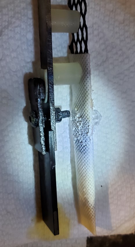

Cathode: Titanium mesh wrapped in 2 turns Polyethylene cloth.
(Cathode was etched in 20% HCl for 10 hours before use)
As discussed previously, the Ammonium hydrogen Sulfate was made by boiling freshly distilled H2SO4 with DEF in the correct proportions.
After the electrolysis was finished, the solution was heated to ~50C and kept at that temperature for 6 hours to facilitate hydrolysis of (NH4)2S2O8 to H2O2. Interesting enough, the solution changed color from completely colorless to red/orange again - like in my first experiment. So I assume there is some Titanium contamination. likely from the holder of the anode which is made from Ti. At this stage I take this as something positive as I think it is the Ti-peroxo complex. So, in other words, there is H2O2 in solution :-).
During the 6 hours hydrolysis only very few tiny decomposition bubbles were observed.
As distillation started, no decomposition bubbles were seen - only big boiling bubbles.
Pictures:
Boiling flask:
Boiling.jpg - 116kB
Temperature at beginning of distillation:
Temp at Start.jpg - 52kB

Electrode setup:
Electrode Setup.jpg - 75kB
Cut PE cloth (believe was a bag a pillow came in):
PE Cloth.jpg - 291kB

Failure Again
Mister Double U - 30-8-2025 at 20:19
Just tested the distillate by the usual copper wire and boiling method.
No gas evolution was observed. Quite disappointing - I thought things looked good.
Not sure what I can change at this point. Feel a little beat down :-(

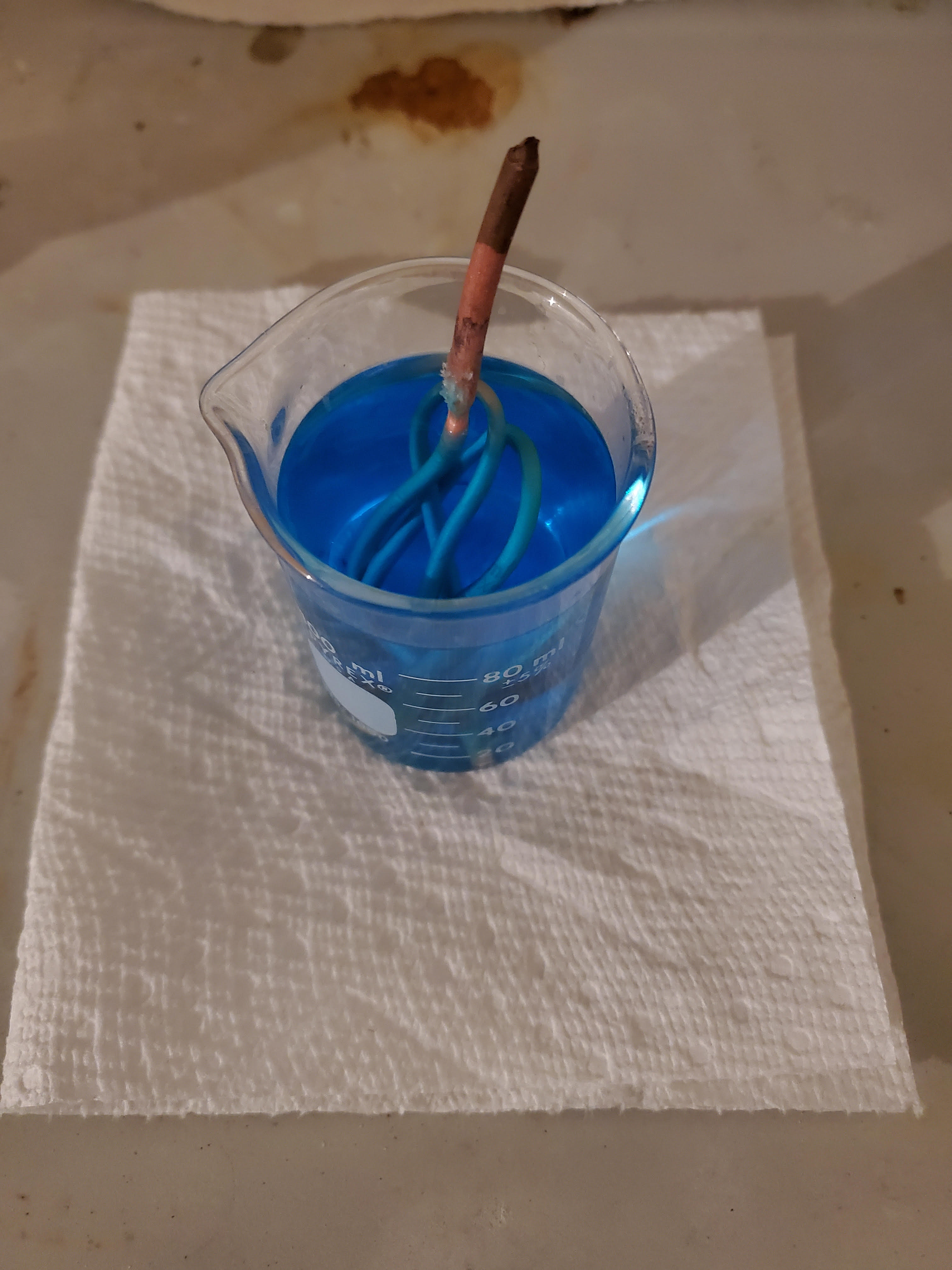

Just tested the second ammonium persulfate solution. Please note that this is not the distilled H2O2 but the raw Persulfate solution. If there was any Persulfate ist was only present in trace amounts.
Here the picture of Copper immersed in the solution after some hours (no blue color visible):
Test for Persulfate.jpg - 46kB
I noticed during the electrolysis that a lot of gas was produced at the anode. I wonder, if there was still a lot of un-hydrolyzed Urea in the solution, which got oxidized to N2 and CO2 - that is at least my hypothesis.

Here the results for the Persulfate content of the NaHSO4 electrolysis:
Next Test for Persulfate.jpg - 541kB
2.47g of Copper were dissolved. That means there were 10.1g Na2S2O8 in the 100ml sample -> 50.5g in the batch after ~24 hours of electrolysis.
Current efficiency: 23.6%

Here the result of the last distillation attempt - failure:
Before I started distillation, I heated the solution to ~60C (when small bubbles started forming) for a couple hours. Then I let the solution cool and started vacuum distillation.
At the end things became very foamy and some material spilled over into the collection flask. I still tested the distillate and observed some small bubbles, but I attributed them to the spilled-over Na2S2O8.
To exclude contamination as the culprit for poor Hydrogen Peroxide yield, I added commercial 3% H2O2 to the residue from the first distillation and distilled again. At least some H2O2 made it over. In other words, it looks like the hydrolysis step is the problem in this whole endeavor.
Boiling flask after first distillation:

Experiment with Phosphate Addition - Small Success
Mister Double U - 7-9-2025 at 06:04
Hello,
As mentioned, I also wanted to conduct a run and see which effect PO4[3-] has on the whole process.
NaHSO4 electrolysis was carried out as in the previous runs (500ml, 125g, 2A, wrapped cathode). After that 30ml of a solution containing ~8g Sodium Phosphate (mono & di) were added to the cell content. Unfortunately, the solution also contained some Na-EDTA (enema solution - Walmart).
Here the next steps:
1. A white precipitate formed, which I assume consisted mainly of the acid form of EDTA and was filtered off.
2. The volume of the solution was vacuum distilled down to ~250ml.
3. Vacuum was removed, and solution was heated to almost boiling and some foaming started - heat was then cut off and solution left to cool for ~2hrs.
4. 150ml of distilled water were added and vacuum distillation was repeated until nothing came over anymore.
Both the distillates from the first and second vacuum distillation were tested by the usual heat + Copper way and did contain small amounts of H2O2. Interestingly, judging from the bubbling they seemed to contain roughly the same amounts. One would think that the second (after hydrolysis) batch would contain more. I am guessing the solutions contained somewhere <0.5% H2O2. I did not conduct quantitative testing.
Lastly, the addition of PO4[3-] seemed to have helped. Almost no red/orange color was visible during any of the distillations - only a very faint hue during the hydrolysis step. Also, at the end of the distillations things did not get super foamy like in the previous run and the second one could be driven to the point where nothing came over anymore.
Hydrolysis (the cloudiness is actually very fine foam on top of liquid):
Hydrolysis.jpg - 105kB
Peroxide decomposition on Copper:
Product.jpg - 44kB

Potassium Peroxodisulfate with 50% Sulfuric Acid Distillation - First Success
Mister Double U - 6-12-2025 at 19:29
Hello,
As stated in my last post, I tried to electrolytically generate some Sodium Perborate. I tried multiple runs with the different ratios of Borax and Sodium Carbonate / Sodium Hydroxide. All of those did not yield any crystalline product in the electrolysis cell and were considered failures.
When I thought about next steps, I decided to revisit the distillation of Potassium Persulfate with Sulfuric Acid. When I last attempted this, I did not use redistilled acid - just straight drain opener acid diluted to 30%.
Additionally, I remembered a patent mentioning the use of 50% acid for the hydrolysis step.
So, today I distilled some H2SO4 and then made 100g of a 50% solution. To that I added 50g of K2S2O8 and heated this to ~70C for hydrolysis. Not all of the Persulfate dissolved. I kept the solution + slurry at this temperature for about 3 hours and noticed little decomposition.
After that I let the flask cool down and started vacuum distillation. The first liquid started to come over at ~35C. Temperature rose to 51C during the course of the distillation. At the end of the run some decomposition seemed to happen. About 55ml were collected in the receiving flask and I was prepared for another failure.
Before I started my usual Copper + heat peroxide test I decided to give the receiving flask a swirl and noticed some disturbances in the liquid - like when you mix two solutions of different concentrations.
Here the pictures of the usual test:
On Hotplate 1.jpg - 55kB
On Hotplate 2.jpg - 50kB
Off Hotplate 1.jpg - 52kB
Off Hotplate 2.jpg - 32kB
Last picture is several minutes after taking of the hotplate. The bubbling looked stronger than the 3% commercial solution.
So, it seems doable after all. A very acidic environment helps with the hydrolysis.

130g of 70% H2SO4 were mixed with 67g of K2S2O8 in the distillation flask (I wanted to keep the ratio of double the amount of liquid compared to the solid the same as in the last run).
Distillation temperature was between 50 and 70C.
Pictures:
Setup:
Setup.jpg - 174kB

Begin of distillation - boiling slurry:
Beginning of Distillation.jpg - 123kB
Vacuum reading:
Vacuum.jpg - 65kB
Flask after cooling - a viscous liquid which did not solidify:
Distillation Flask after Cooling.jpg - 118kB
Dissolved Copper - this time from H2O2 (+H2SO4):
H2O2 Test.jpg - 91kB
Results:
45ml of liquid were collected in the receiver. 15ml of this were used to perform the usual Copper and heat test which showed vigorous bubbling (@ ~80C). The liquid had no color after the reaction fizzled out - in other words, no Copper was dissolved.
The other 30ml were mixed with 21g of H2SO4 and topped up with water to 110ml (max of my small beaker). Into that the Copper spiral was introduced and left for a couple of hours. At the end of this period the solution was heated (~80C) to drive the reaction to completion.
6.5g of Copper were dissolved. That means the sample contained 3.48g of H2O2. The total amount was 5.22g with the liquid from the first test. Based on the Persulfate this was a yield of 61.8%.
Unfortunately, I did not measure the weight of the distillate, so I can't calculate the exact weight% of the H2O2 solution. However, with knowing that 5.22g were contained in 45ml of liquid, it is fair to say that the concentration was somewhere around 10%.
So, the reaction works. However, a lot of chemicals are needed.
(I assume the Sulfuric Acid could be recovered by distillation and the KHSO4 reused)

Experiment:
Current: 2[A]
Electrolyte: 300g of 60% Sulfuric acid (Anolyte volume ~250ml)
Diaphragm: Small flower pot sealed with hot glue.
Anode: BDD
Cathode: Tungsten rod (TIG welding electrode)
Pictures of setup:
Electrolysis Setup.jpg - 121kB

Cell liquor with slightly yellow hue:
Cell Liquor.jpg - 37kB
Wiped off residue from cathode:
Residue on Cathode.jpg - 78kB
I attribute the slight yellow color to Titanium contamination from the anode clamp. The color vanished, once the solution was heated.

As promised, I conducted another run.
But before I report, I want to give a word of warning:
After I finished the last run, I disassembled the condensers and found a big white stain on my thumb. The typical peroxide 'burn'. I was not expecting any high concentrations, so I did not wear gloves. It does look though, that H2O2 of considerable concentration can distill over at the end.
I ended up putting some Vaseline on it and the white spot disappeared over the course of the next hours. Anyway, everyone please wear your PPE (especially safety glasses)!
This finding let me to believe, that even higher concentrations of Sulfuric Acid can be used, and I decided to go with 70% this time.
Pictures:
Setup:
Empty wash bottle between vacuum pump and receiver to capture water:
Vacuum reading:
Results:

Cell Parameters:
Current: ~2A
Voltage: ~6V (did not exactly measure, but judging from the transformer dial)
Duration: 58hrs
Cell Volumen: 500ml
Electrolyte: 250g NaHSO4 dissolved in 400ml H2O
Anode: BDD (8 cm^2, Titanium holder taped-off with electrical tape to prevent Ti contamination)
Cathode: Tungsten rod (4 cm^2)
Temperature: ~20C
No diaphragm or other means to prevent reduction were deployed.
The run time for the cell was roughly double the time required to convert all NaHSO4 to Persulfate. This was done to assure, that the maximum possible concentration of Persulfate could be established in the electrolyte (to overcome reduction losses). Electrolysis started at 2.4A and dropped to 1.9A after a day. Current flow did not change after that.
A fan was positioned next to the cell for cooling.

To the remaining 450ml of the cell liquor 250g of H2SO4 were added. This heated the solution to the point, that it could not be touched anymore (estimate 90-100C). This heating step was beneficial, because it ensured hydrolysis of Na2S2O8 to Hydrogen Peroxide.
When the solution cooled back down, vacuum distillation (100mbar) was started.

Cell setup:
Cell Setup.jpg - 171kB
Test for peroxide:
Test for Peroxide.jpg - 75kB
Results:
The initially separated 50ml of cell liquor dissolved 2.85g of Copper. That means there were 10.7g of NaS2O8 present in this sample. Since there were 25g of NaHSO4 in this volume before the electrolysis, 42.7% were converted to Persulfate.
After distillation of the remaining 450ml of cell liquor (with H2SO4), 301g of distillate were collected. Of this, 80g were taken and mixed with 20g H2SO4. Into this another Copper spiral was introduced - 5.2g were dissolved. As a result, this sample contained 2.8g of H2O2. For the whole distillate this would be ~10.5g (if the initial Persulfate sample is added this would be 11.6g). The yield from Na2S2O8 to H2O2 was 76%.
