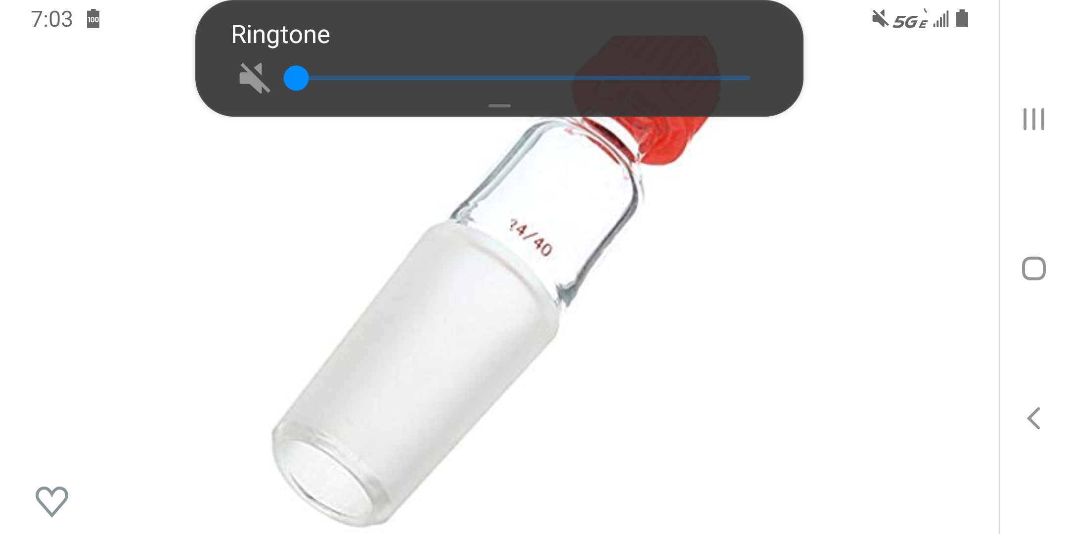

magnet - 6-9-2019 at 05:42
My thermometer adapter popped up and out at the end of my last distillation because I was negligent in using a keck clip..ugh. so ordered a new one but it's different and didnt realize the system will be open using this(I use my multimeter for thermometer). I thought of filling hole with aluminum foil but I'm sure that would react with something sooner or later. Any ideas how to seal around wires? Sorry about volume level thru pic..damn phone is a pitas to screen shot.
Screenshot_20190906-070342_Chrome.jpg - 168kB
[Edited on 6-9-2019 by magnet]
j_sum1 - 6-9-2019 at 06:13
Four options.
  • Hot glue gun
  • Lots of teflon tape
  • Silicone sealant
  • Buy the adapter you want
    Sulaiman - 6-9-2019 at 06:15
    Heat seal (melt) the end of some 8mm o.d. borosilicate tubing and put the thermocouple in the glass tube.
    Pumukli - 6-9-2019 at 06:21
    To polynitrosomeone: yes, just dilution. Why, what did you think? :) No special additives, nothing. It would cost money, anyway! Dilution is cheap - but can be explained away as the most important scientific breakthrough in the XXI century. :) Like "x % less fuming"! :)
    magnet - 6-9-2019 at 06:55
    Thank you for the suggestions.

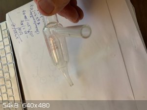

    solo - 8-9-2020 at 09:04
    What is this piece used for....some type of trap .?......solo
    5E578C39-EA28-4B4D-946F-BE9D527C218D.jpeg - 1.8MB

    Well you kind of cut off the bottom of the picture, is it just sealed glass at the bottom? Also, does the tube from the top & middle section seal to the bottom tube, or is it open at the bottom?
    solo - 8-9-2020 at 17:16
    sealed at the bottom with a small hole on the upper side...and open on top ....solo

    Just a WAG (as opposed to a SWAG): could this be some kind of device to deliver 10 mL of a reagent from some kind of reservoir?
    B(a)P - 11-9-2020 at 02:34
    Some time ago I purchased a cheap condenser and it came with an addition funnel. I used the addition funnel for the first time today and it was almost impossible to get a constant drip rate. Can I replace the tap to get something usable, any tips for getting crappy taps to perform or do I just forget it?

    Has anybody ever heard of such a thing as a spring-loaded flask clamp? With how handy it would be for receiving flasks it seems to be a thing that should exist and yet I don't see any anywhere.
    karlos³ - 12-9-2020 at 22:42
    Could you draw one, just a bad sketch to get the idea?
    I'm not sure how that should look like.
    I hope not like that: https://www.sigmaaldrich.com/content/dam/sigma-aldrich/produ...
    Because that would mean they stole and produced your idea, and that in merely hours!
    Those capitalist pigs, no respect on your intellectual property! :o
    But seriously, like that?
    Because initially I imagined a clamp to hold the receiving flask connected with the vacuum adapter(or cow) or such.
    Just a plain flask clamp.
    Only that I can't picture how such a thing would look like spring-loaded, which is why I was asking for a sketch of it.
    And promised, not to steal the idea and sell it to sigma or whoever bids most, you have my hobby chemist word of honor on that! :D

    So instead of tightening a thumbscrew to apply pressure to the piece, you'd be unscrewing it to release spring tension onto it, to hold it in place. The flask could then be removed and replaced by squeezing the other end of the clamp scissors-style. If that makes sense lol
    Untitled 1.png - 12kB
    [Edited on 14-9-2020 by paulll]
