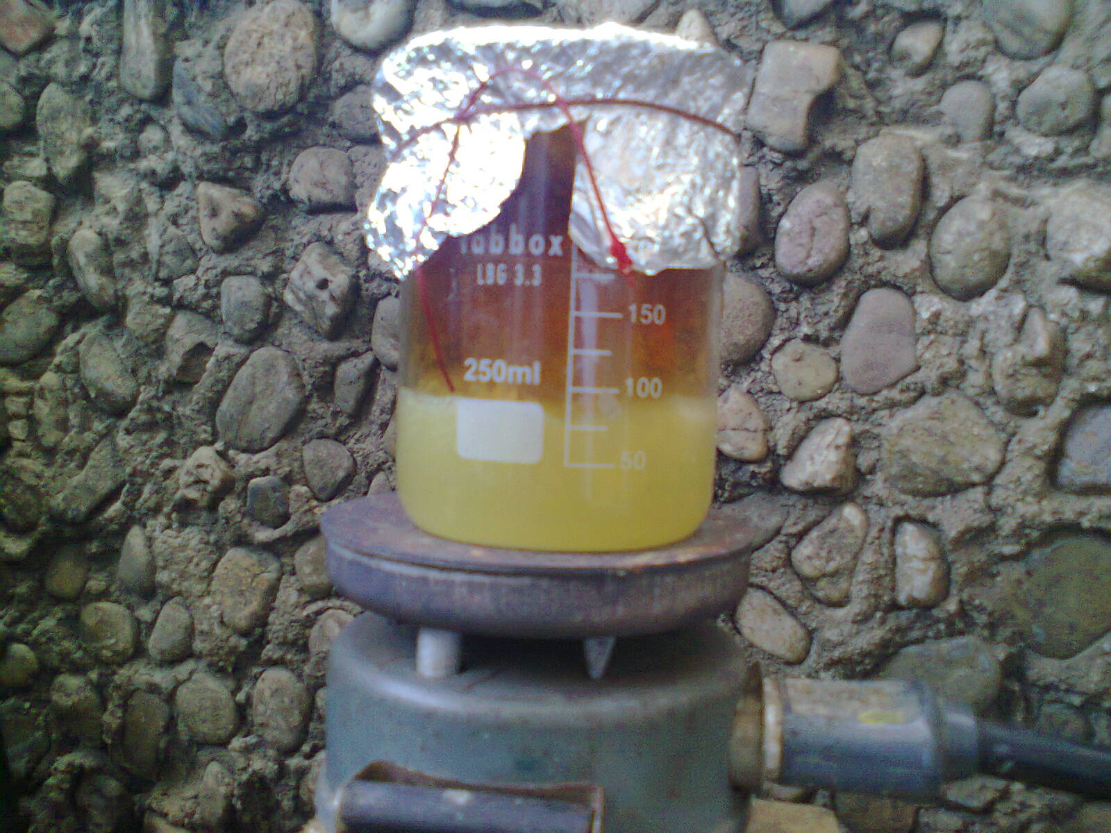

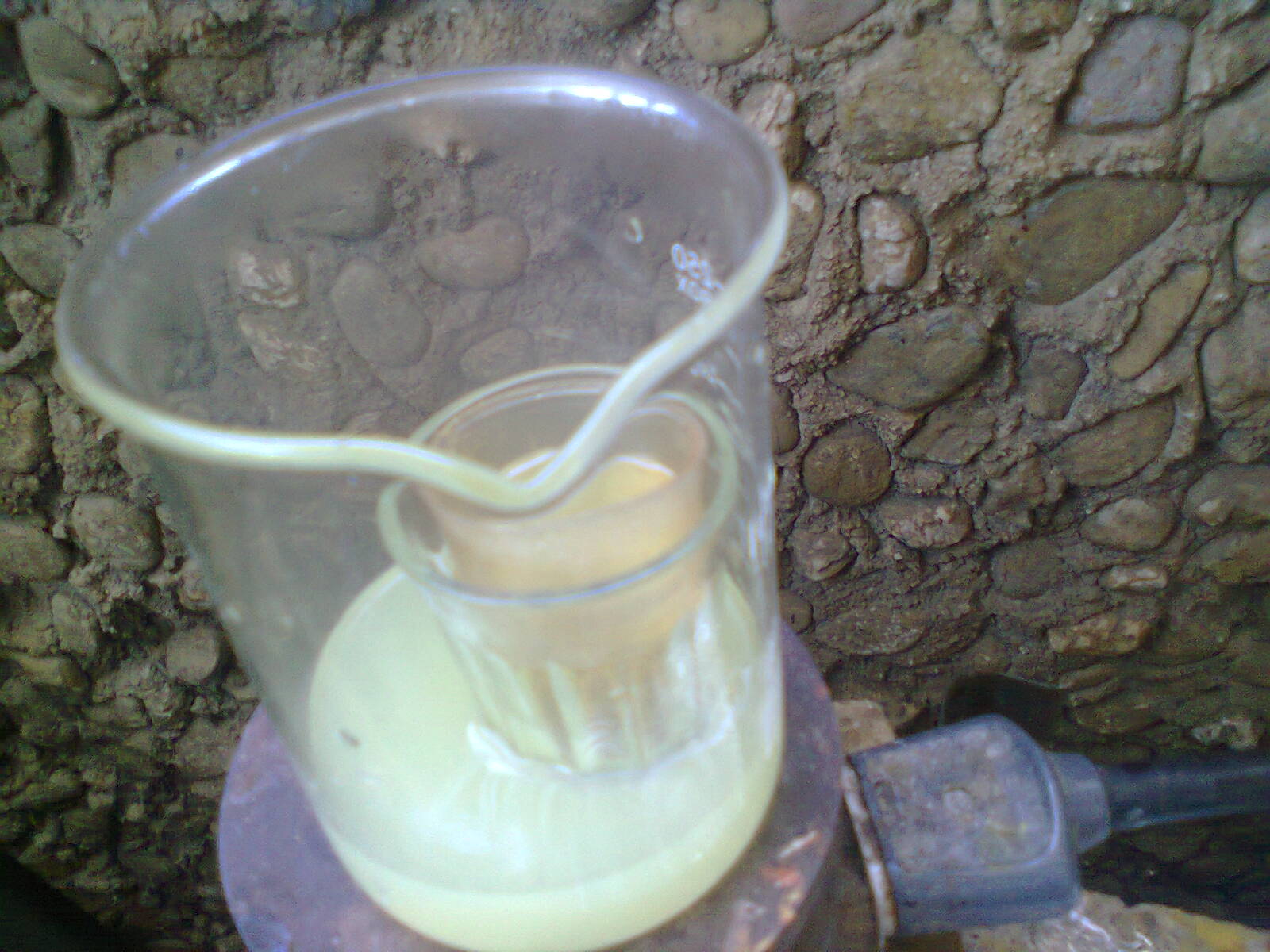

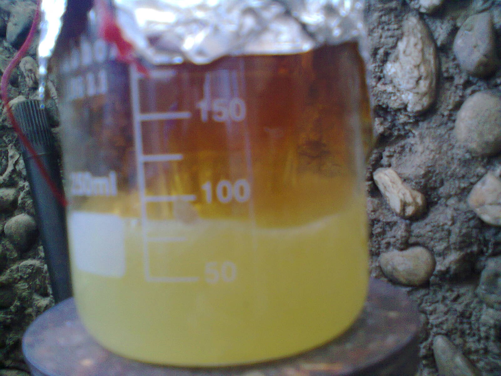

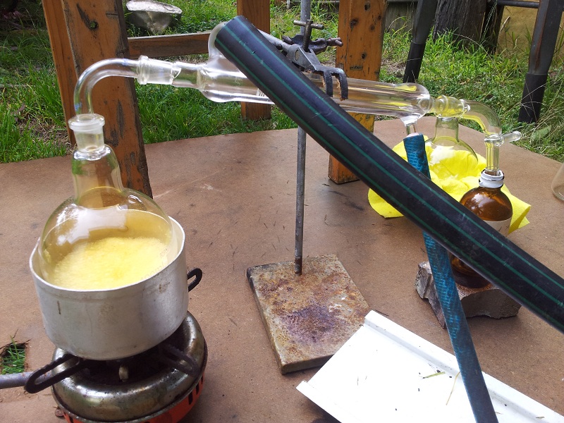

Oscilllator - 20-7-2013 at 02:21
Quote: Originally posted by weiming1998
With an excess of sulfuric acid, (almost) water-free nitric acid can be made (See http://lulelaboratory.blogspot.tw/2013/01/preparation-of-anh...). However, nitric acid made and distilled without a vacuum will always contain a significant amount of nitrogen oxides dissolved in it. Thus, white fuming nitric acid (anhydrous nitric acid containing very small amounts of dissolved nitrogen oxides) can only be produced by vacuum distillation.
It is important not to crank the heat up too much during distillation, as more nitric acid will decompose, producing nitrogen dioxide and water, which dilutes down your product.
I have actually observed results that contradict this. If I carry out the distillation at lower temperatures, then NO2 is very visible, but if it is carried out at higher temperatures there is barely any NO2 contamination. I have previously made a thread on this , but I don't recall receiving a satisfactory explanation fo this phenomena.
The distillation was done with KNO3 and clear drain cleaner labelled as 98% H2SO4. The acid obtained was yellow and formed a passivation layer with copper, indicating it is very concentrated. I have yet to do a titration on the acid, but its on my to-do list :).
The picture that on the right is a picture that was taken early on in the reaction, before it got going. The other one is from about 10 minutes later and as you can see there is minimal NO2 contamination.
IMG_20130714_132245.jpg - 214kB IMG_20130714_131634.jpg - 233kB
[Edited on 20-7-2013 by Oscilllator]
Pulverulescent - 20-7-2013 at 03:17
This is because NO2 is swept from the flask, on forming, by increased HNO3 vapour production!
weiming1998 - 20-7-2013 at 04:47
Wikipedia states that NO2 decomposes to NO and O2 (both colourless) at 150 degrees Celsius (http://en.wikipedia.org/wiki/Nitrogen_dioxide). Maybe that is why there is appears to be no NO2 in the flask.

Oscilllator - 20-7-2013 at 21:03
Pulverulescent I'm afraid your idea doesn't hold up. If the red NO2 was being swept away by increased HNO3 vapors, then surely once the HNO3 had been condensed then the red NO2 would re-appear. This is not what happened, almost no NO2 was observed coming from the vacuum take-off adaptor at the time when the flask was clear. But when the flask was filled with NO2 then NO2 vapor were observed coming out from the vacuum take-off.
weiming's explanation seems more likely to be correct, since I don't have a still head that a thermometer can be attached to, so I cant monitor the temp of the distillation. Since I was using a sand bath, it is entirely possible the temperature reached over 150C
And yes golfpro, HNO3 obtained by distillation can easily be over the azeotropic concentration, although I don't have any exact figures.

Hey for those using retort, how much concentrated nitric acid are you getting per distillation with what amount of sulfuric and KNO3? I don't have a problem with the purity, but I use 250ml sulfuric acid and then the proper amount of KNO3 I forgot which, and then only get 50ml of Nitric acid??? Am I losing my acid in the way of it just not condensing and fuming off instead? I don't cool the tube on the retort but the acid drops into a ice cold beaker. I use an oil bath at least 150* C
my retort only holds 500ml, and I don't like 300ml sulfuric yeilding only 50ml Nitric... This is with the correct amount of KNO3.
subsecret - 24-8-2013 at 06:32
Try using a cold round-bottomed flask. This will provide a larger cold surface.
hissingnoise - 24-8-2013 at 06:48
On distillation, the neck of the retort heats quickly until the glass reaches the vapour temperature and the vapour then largely escapes!
You could try pushing a cooled condenser onto the neck using teflon tape to minimise leaks . . .
Otherwise, just use small quantities of reactants ─ fiddly, but you'll lose less product!

golfpro - 24-8-2013 at 13:10
The distillation would work much better in the winter, but is there any way to cool the neck like wrapping a baggy of crushed ice and water and taping it around the neck?
This would cause moitsture to condense on the neck and maybe even drip water into the beaker which is supposed to get high concentrated nitric acid and then defeat the purpose.
I bet I'd get at least twice the amount of acid distilling in 15*F weather compared to 85*F Until then I've got to find a way to cool the neck. Maybe a cloth dipped in ice cold water and wrap that around..

golfpro - 26-9-2013 at 16:09
Has anyone found a way to get maximum distillation yields from a retort? I have a 500ml retort and from 200ml sulfuric acid and 160g KNO3, I get 50ml of Nitric Acid. I am looking for a way to get 100ml Nitric acid per 200ml sulfuric acid.
Maybe the neck slightly more angled down? I know that on a cold day I'd get more HNO3, and with less material in the retort, more nitric acid can be attained, but this only means it's more efficient to use less each time.
I was thinking of a way to cool the neck, maybe with a bag of ice?
I figure there are people on here who used a retort and have found little things for more efficient distillation.
PeeWee2000 - 26-9-2013 at 16:18
Ive never used a retort but the best way I can think of to increase your yield without using an actual condenser would be to stick the end as far as possible into another flask submerged in an ice bath so the entire flask acts like a condenser as well as trying to cool the neck as much as possible.
http://www.youtube.com/watch?v=S8rtyRnZZMU
Theres a good visual of what I'm trying to describe but definitely don't use copper and steel for making nitric acid :D.
You might also try cooling the flask with dry ice, that will cause the nitric acid to freeze but it shouldnt crack your glassware as it does not expand like water.
[Edited on 27-9-2013 by PeeWee2000]
MichiganMadScientist - 26-9-2013 at 16:31
Ah the retort. I own and periodically use a retort from time to time. Unfortunately, they are just not that perfect for good distillations...but not entirely without purpose. The idea is to try and keep the heat at just the minimum you need to distill off whatever it is you are trying to isolate. With the retort, you don't have the advantage of a chilled condenser, so try wrapping the retort in a cold wet rag (and replace the rag with fresh cold wet rags as they heat up). Also, make sure your collection flask is sitting in an ice bath.
Ideally, you can eventually invest in a simple distillation setup. A round bottom flask, a distillation head, a liebig condensor, and a take off. You can probably pull this off for just under a hundred dollars on Ebay. You can even use a simple automotive siphon to circulate water through the condenser. And after you obtain this setup, it's fairly simple to upgrade to fractional or vacuum distillation by simply buying a fractionating column or vacuum adaptor. Then you'll be distilling like the big boys!
[Edited on 27-9-2013 by MichiganMadScientist]
Dariusrussell - 26-9-2013 at 16:33
Another thing I think of (I haven't used retort either) would be to wrap a towel soaked in freezing water (Maybe with some dry ice wrapped inside) and wrap that around the retorts condensing end.
Depending on how long the distillation takes you may have to have a couple of towels ready.
Viel Glück!
OHp, michiganmadscientist beat me to it!
[Edited on 27-9-2013 by Dariusrussell]
Bot0nist - 26-9-2013 at 17:36
Sell it to some sucker whos into "alchemy", and use the $ to buy a proper, ground glass, distillation apperatus...

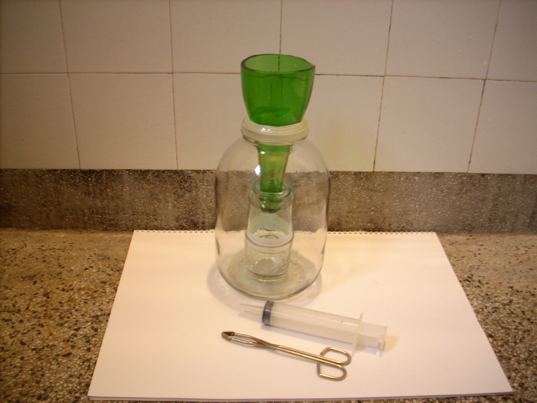

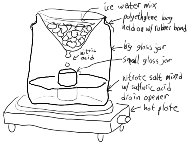

otonel - 11-2-2015 at 14:29
I read in an old book about distilling nitric acid using steel retort, and right now I want to build or improvised one because i want to make some lead nitrate and I need diluted nitric acid.
What do you thing about this improvised distillery can work ?
I read on a forum about a "recipe" to make nitric acid without distillation but how pure can be the final product because i don`t want sulfates in my nitrate.

Molecular Manipulations - 11-2-2015 at 15:17
The process described is indeed distillation, it's just a simpler setup.
If done perfectly there should be very, very little sulfate in the distillate. If you use an excess of nitrate there should be even less.
But perfection isn't possible, and while very little sulfuric acid will volatilize, aerosols may be a major cause of contamination of not just sulfuric acid, but also Na/KHSO4. Using boiling chips will alleviate the problem, but I can't think of a way to completely prevent contamination.
BTW, your "beaker" doesn't look like it could handle the heat. Also if that's a plastic coke top, it will catch on fire, but that shouldn't be a big problem right?
Actually I can see that it's glass, nice job cutting that, diamond blade?

Bert - 11-2-2015 at 15:17
About your quoted procedure- Just for a start: -41 F is approximately -41.5 C, NOT -5.1 C!
Your drawing may be workable- Particularly f you can can cool the small jar receiving the condensed nitric acid. Some have done what you diagram, but added a ceramic or glass "stool" of some sort to keep the receiver above the hot nitrate/Sulfuric acid in the bottom of reaction vessel.
The second procedure in the below linked video starting @ 2:10, reacting a nitrate, Copper metal and hydrochloric acid while piping the nitrogen dioxide into a hydrogen peroxide solution will give you useable nitric acid without sulfate contamination-
http://youtu.be/2yE7v4wkuZU
cyanureeves - 11-2-2015 at 18:53
yes its been done BUT if the "big glass jar" is not heat resistant you may have a serious and i mean dangerously serious situation.surely you werent gonna use that pickle jar looking thing?
Marvin - 12-2-2015 at 17:20
Everyone can see that the text and the pictures otonel posted are two completely different processes right?
Both methods are dumb for different reasons, the one in the pictures is very dumb.
It might be preferable to make dilute nitric and distil than to make concentrated acid and dilute. If nothing else less toxic gasses should be produced. Lead nitrate is a persistent poison. This sounds like a very green student wanting to do something stupid so he can do something much more stupid.
Bert - 12-2-2015 at 22:54
Indeed, I missed the drawing not having a "bath", putting a non Pyrex container full of acid on a hot plate is asking for a disaster.
otonel - 13-2-2015 at 04:20
I understand how dangerous is lead nitrate and working with acids especially nitric acid, You have right about glass jar if it is not heat resistant can make a disaster, that picture with the jar is not my "opera" and my mother when make pickle put the glass jar in a pot and warm the water for better preservation, and the jar don`t have fissures after that.
In this weekend I want to try this distillation and I will tell about the result.
[Edited on 13-2-2015 by otonel]

otonel - 13-2-2015 at 13:37
Sorry for the misunderstanding, I will use pyrex container placed on a water bath sealed (not perfectly) with glass and heat resistant silicone .I do not want a perfect seal because the heating increases the volume and a perfect seal can cause problems
I want to say a normal jar can be use if it is placed in a pot with water and this is slowly heated from a hot plate

otonel - 14-2-2015 at 06:57
Improvised distiller at work in pics, it worked well with the condition to change top water at 5 minutes using a syringe.
Nitric acid obtained is concentrated and emits red smoke.
I am glad for successful experiment and it can be improved , especially the heat exchanger
Fotografie0304.jpg - 290kB Fotografie0305.jpg - 213kB Fotografie0308.jpg - 231kB

Molecular Manipulations - 17-2-2015 at 06:36
What concentration did you get?
otonel - 17-2-2015 at 12:14
I don`t determined the concentration because I diluted it anyway for use in what I need and do not emit toxic fumes.
After aspect I think is somewhere in the 70 % concentration
