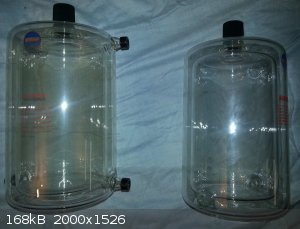

Have absolutely no idea what this is. It's about 3ft tall. It does say "don't wash with organic solvent" because it the base and top screw cap are made of acrylic/polycarbonate and some other white plastic on top.
Buchler 0.jpg - 214kB
Buchler 1.jpg - 135kB
Buchler 2.jpg - 169kB
These are upside down, the bottom (in the pic) is open and can hold fluid. I think these look like cold traps somewhat

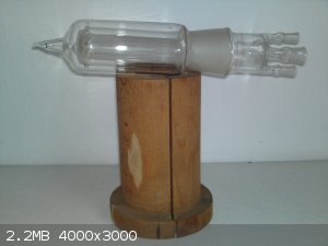

As part of a job lot of used glassware I have had this piece, unused by me, for a few years.
B14thing.jpg - 3.1MB
The joints are 14/23, the flask is 25ml, and I assume that the jacket is vacuum.

Junk_Enginerd - 17-7-2020 at 12:14
Any ideas? Found it at a random yardsale for nothing. It's definitely borosilicate, so I assume it's a lab product.
20200714_204210.jpg - 2.5MB
Eddie Current - 21-7-2020 at 23:33
It's a bit hard to tell from that image. My guess is that it's some type of atomiser.
