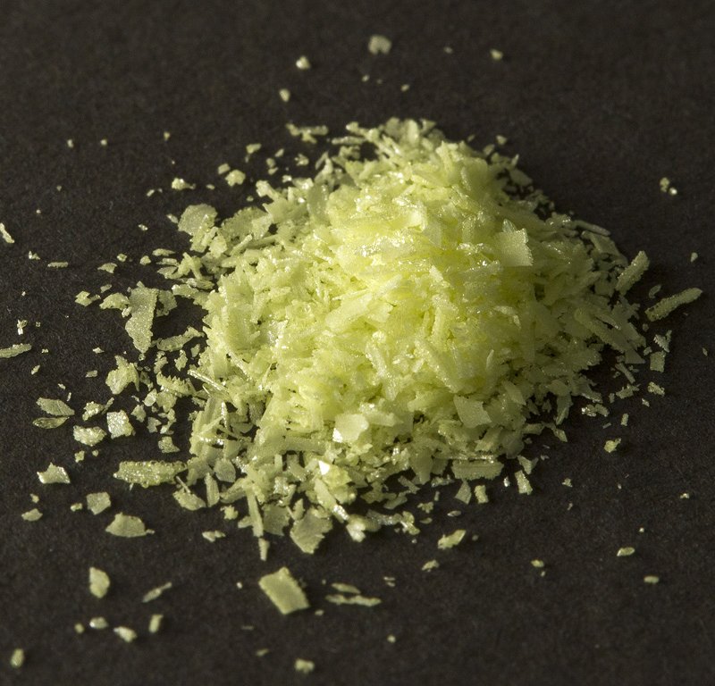

garage chemist - 14-5-2005 at 15:02
With black background, from above (best picture of the four)
The crystals are all the same shape now, and have the same thickness. It looked very different when it wasn't fully cooled.
I'll try out what happens when I cool it very slowly. Maybe I can get some large sulfur crystals.
[Edited on 14-5-2005 by garage chemist]
Img_0029.jpg - 599kB

I repeated the experiment with exactly 2g sulfur and 10ml toluene, and it dissolved without problems (it took some time though, and the toluene needed to be boiling hot).
I observed an interesting phenomenon: the last part of the sulfur (about 0,5g) liquefied as a yellow blob under the toluene before going into solution. I think that the toluene lowered the melting point of the sulfur, and that the sulfur molecules (S8-rings) needed to be seperated from each other by the toluene molecules before they could dissolve.
And I always got monoclinic crystals, even with slow cooling. The toluene was over 100°C, though.
