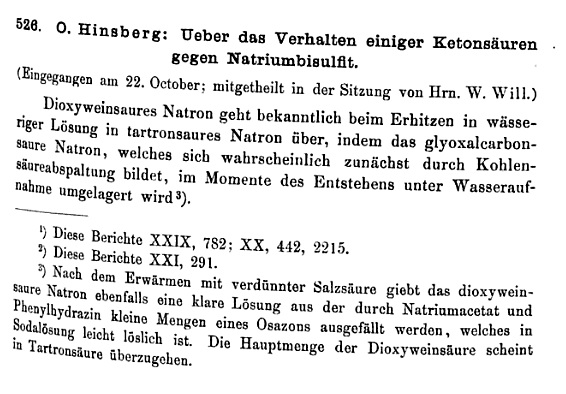

Here is a reference that might be useful to someone who wants a simple lab prep for glyoxal. I haven't tried it yet, but intend to shortly. It uses sodium bisulfite and tartaric acid as starting materials, and looks pretty simple if it works.
The book is in German, and here is the link in Google Books:
http://books.google.com/books?id=AQ42AQAAMAAJ&dq=edition...
Here are the pages in German:
01.jpg - 92kB03.jpg - 129kB
04.jpg - 130kB 05.jpg - 110kB
I have typed out and google-translated the article to the best of my ability, but would appreciate it if someone would like to clean it up. Here it is in English:
"O. Hinsberg: About the ketonic against some sodium bisulfite:
Dioxy wine soda is well known, when heated in aqueous solution in tartronsaures soda over by the glyoxal carbon soda, which probably formed initially by carbon dioxide elimination, is rearranged in the moments of occurrence under water absorption.
It is possible now easy to show with certainty that in the carbonic acid elimination from the first dioxy tartaric acid aldehyde arise when one carries out the cleavage in the presence of an agent which immediately binds with the aldehyde group. This agent is sodium bisulfite.
Plotting dioxy wine soda into a warmed to 80-100 ° concentrated solution of sodium bisulfite, a violent bubble formation takes place during which all dioxy wine soda dissolves. After completion of the reaction, crystallizes from the cooled liquid from Glyoxalnatriumbisulfit, which can easily identify it by its reactions with phenylhydrazine and o-toluene diamine. The Reactionsverlauf is therefore:
02.jpg - 5kB
It has not been successful, the first product of carbon dioxide elimination, namely to take the Glyoxalcarbonsäure; also if you keep the temperature of the bisulfite solution is so low that the development of carbon dioxide slowly of goes (ie, 60-70 °) after completion of the development only glyoxal available.
Since the dioxy tartaric acid is easily generated from nitro tartaric acid, it seemed possible that these also go on in Glyoxal on heating with acid sulphite salts. The experiment has shown that, in fact, a reaction in the indicated direction occurs, however, the yields of glyoxal are always low; were obtained about 20 per cent of the theoretical amount at best. The method is thus suitable for the production of glyoxal bisulfites.
The favorable course of the experiments just described, gave rise, some other ketonic acids, their esters, respectively, to check on their behavior towards sodium bisulphite.
The pyruvic acid, which has been studied for this purpose, showed against the reagent a resistance which at least that is equivalent to diluted mineral acids, for even as it was heated pyruvic acid with sodium bisulfite solution in the tube to 170 °, by far the greater part of the organic acid was unchanged. Products of decomposition of pyruvic acid could not be detected.
Chloro acetoacetate disappears on prolonged heating with a concentrated solution of sodium bisulfite on the water-bath. The decomposition of the ester appears to proceed in the usual way, ie according to the scheme of the acid cleavage, because you will get no trace of chlorine acetone, which is so easy erkeunbar yes by his awful smell when the supersaturated sodium bisulfite solution with dilute hydrochloric acid and then distilled in steam power.
Acetoacetic ester itself is not decomposed by prolonged heating with sodium bisulfite solution at 100 °.
From these experiments it appears that in the presence of sodium bisulfite, the tendency to separation of carbon dioxide from ketonic acids, esters thereof, respectively, is not substantially increased. In contrast, the bisulfite exercises where the spin-off without this already at a low temperature (100 ° and below) is going on, a protective influence on resulting aldehyde groups from."

Weinsäure is tartaric acid and Weinsäures Natrium is sodium tartarate. "Dioxyweinsäure" I think is dihydroxytartaric acid. See http://pubs.acs.org/doi/abs/10.1021/ja01442a013
When sodium dihydroxytartarate is poured into a warmed 80-100° concentrated solution of sodium bisulfite, a violent bubble formation takes place during which all of the sodium dihydroxytartarate dissolves. After completion of the reaction, glyoxal sodium bisulfite crystallizes from the cooled liquid, which can easily be identified by its reactions with phenylhydrazine and o-toluene diamine.
It has not been successful to isolate the product of a single carbon dioxide elimination, namely to take the glyoxylic acid; even if you keep the temperature of the bisulfite solution is so low that the development of carbon dioxide slowly of goes (ie, 60-70 °) after completion of the generation of gas, only glyoxal is available.
Since the dihydroxytartaric acid is easily generated from nitrotartaric acid, it seemed possible that these could convert to Glyoxal on heating with acid sulphite salts. The experiment has shown that, in fact, a reaction in the indicated direction occurs, however, the yields of glyoxal are always low; were obtained about 20 per cent of the theoretical amount at best. The method is thus suitable for the production of glyoxal bisulfites.
