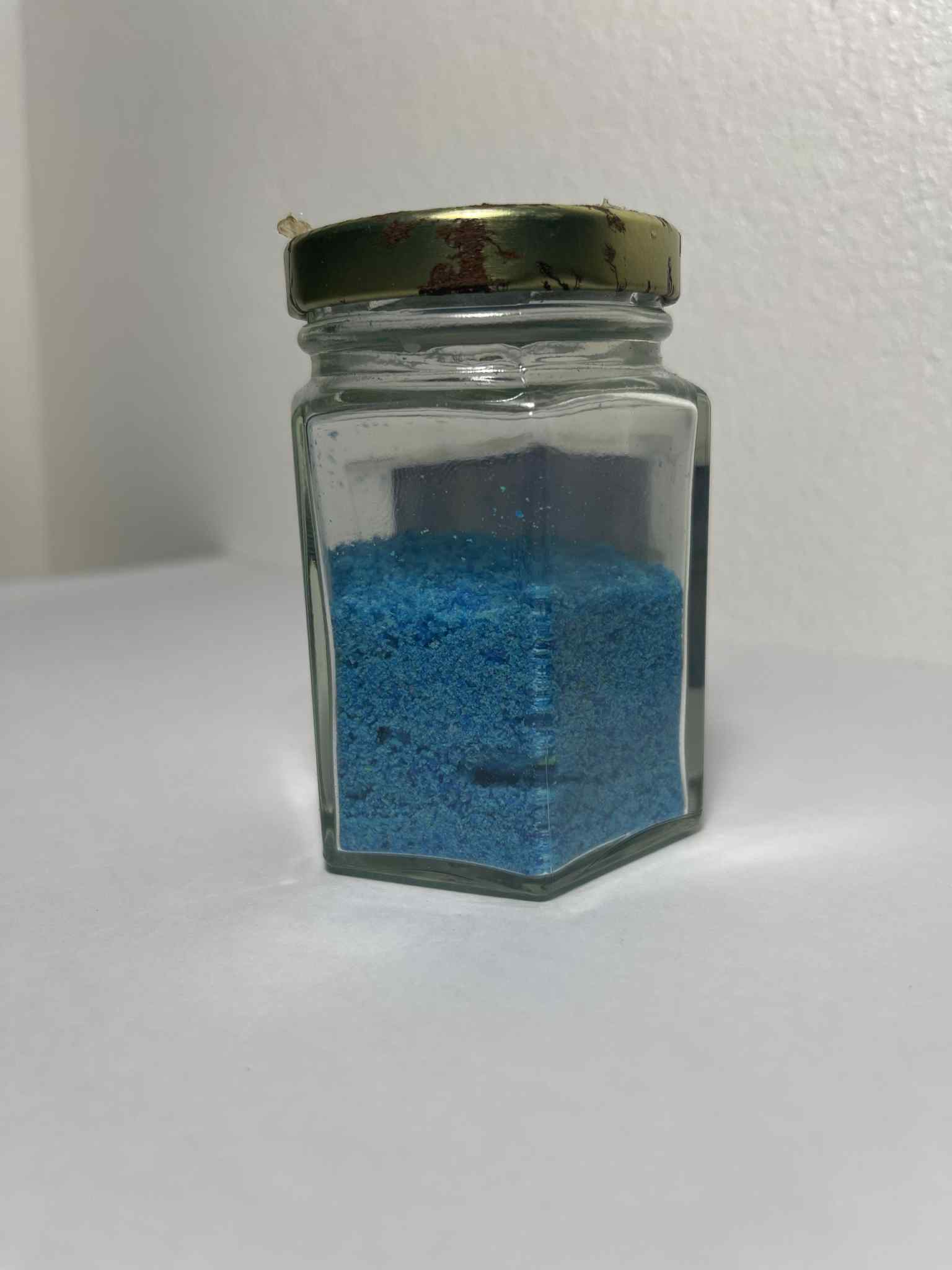

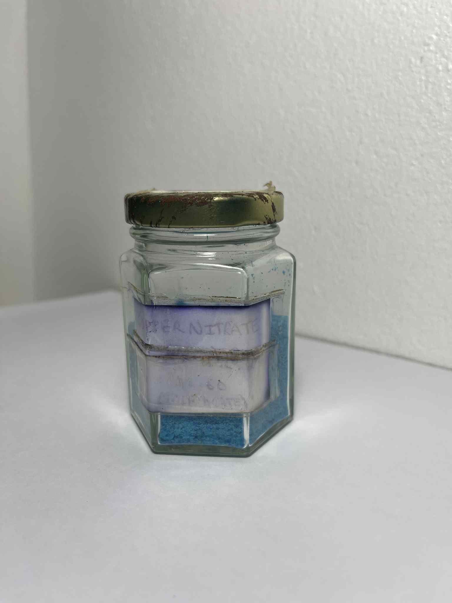

As noted by Woelen, anhydrous copper II nitrate cannot be made using aqueous solution.
Making the hydrated version of copper II nitrate is not easy either. Once you know that you have removed all of calcium sulfate and have a pure solution of copper nitrate, you need to carefully, at low heat, reduce the solution down to a concentrated solution of copper II nitrate. Then place the solution in an evaporating dish and put it in a desiccator and put the desiccator into the refrigerator. Allow it to dry for about one or two weeks.
I've been experimenting with copper II nitrate and its really difficult to crystallize the solid hydrate, especially during summer. In the winter where the garage is freezing and very dry, its alot easier. Once its dry, I bring the desiccator back into the house from the garage and allow it to dry further at room temperature until it is completely dry. I then quickly place it into a bottle for storage. In fact, that's what I'm doing right now. Good luck. Here's some pictures.
IMG_2835.JPG - 29kB IMG_2838.JPG - 42kB

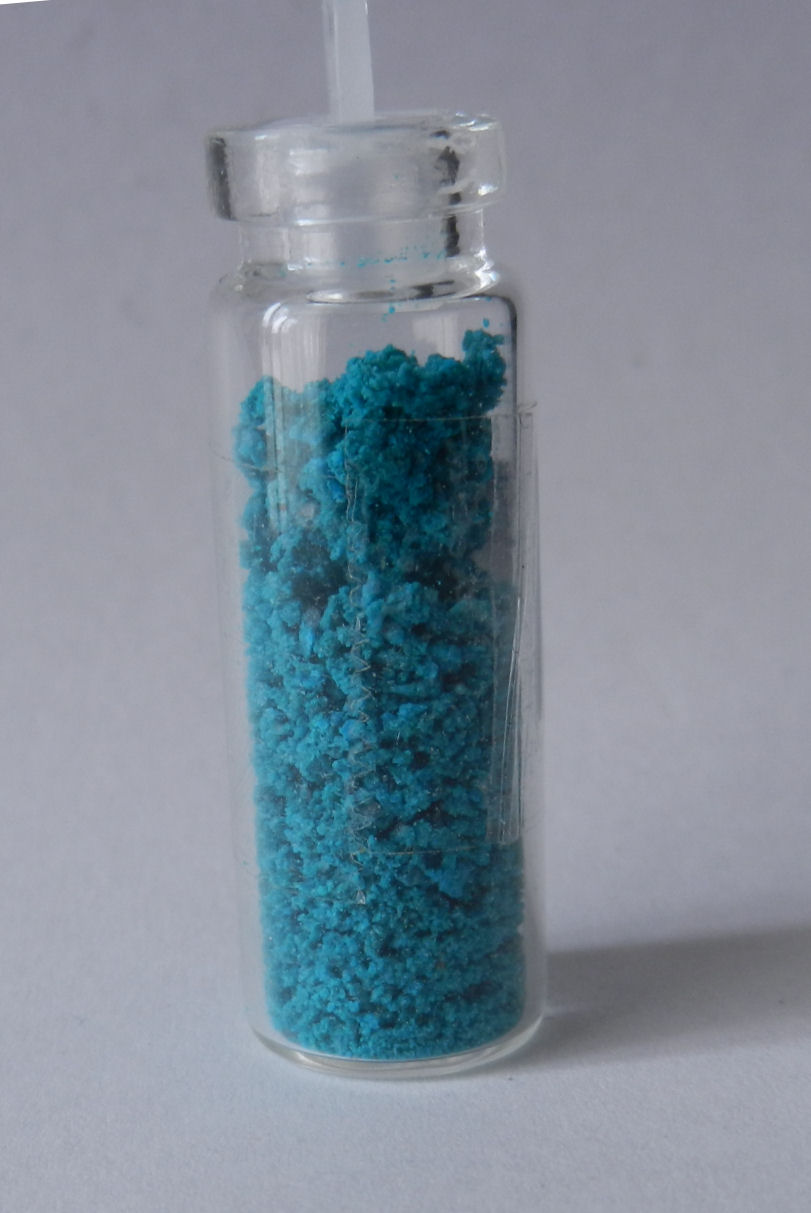

Copper Nitrate
chemcam - 23-4-2013 at 13:17
The best results I have obtained by trying to make copper nitrate dry is just by letting it sit in dry, open air for a few days. Usually takes about 3-4 days for no more mass to be lost.
jamit - 24-4-2013 at 00:25
Wow, that is beautiful. What did you do ' chemcam' to make copper nitrate like that?
chemcam - 24-4-2013 at 17:36
Well thank you, what I did was use steam to evaporate the excess water from the solution and when I saw crystals forming I took the heat away and let it further crystallize over night. It was a solid-like mush the next morning so I stirred it to get the shapes seen in the photo then just let it air dry for a couple more days.

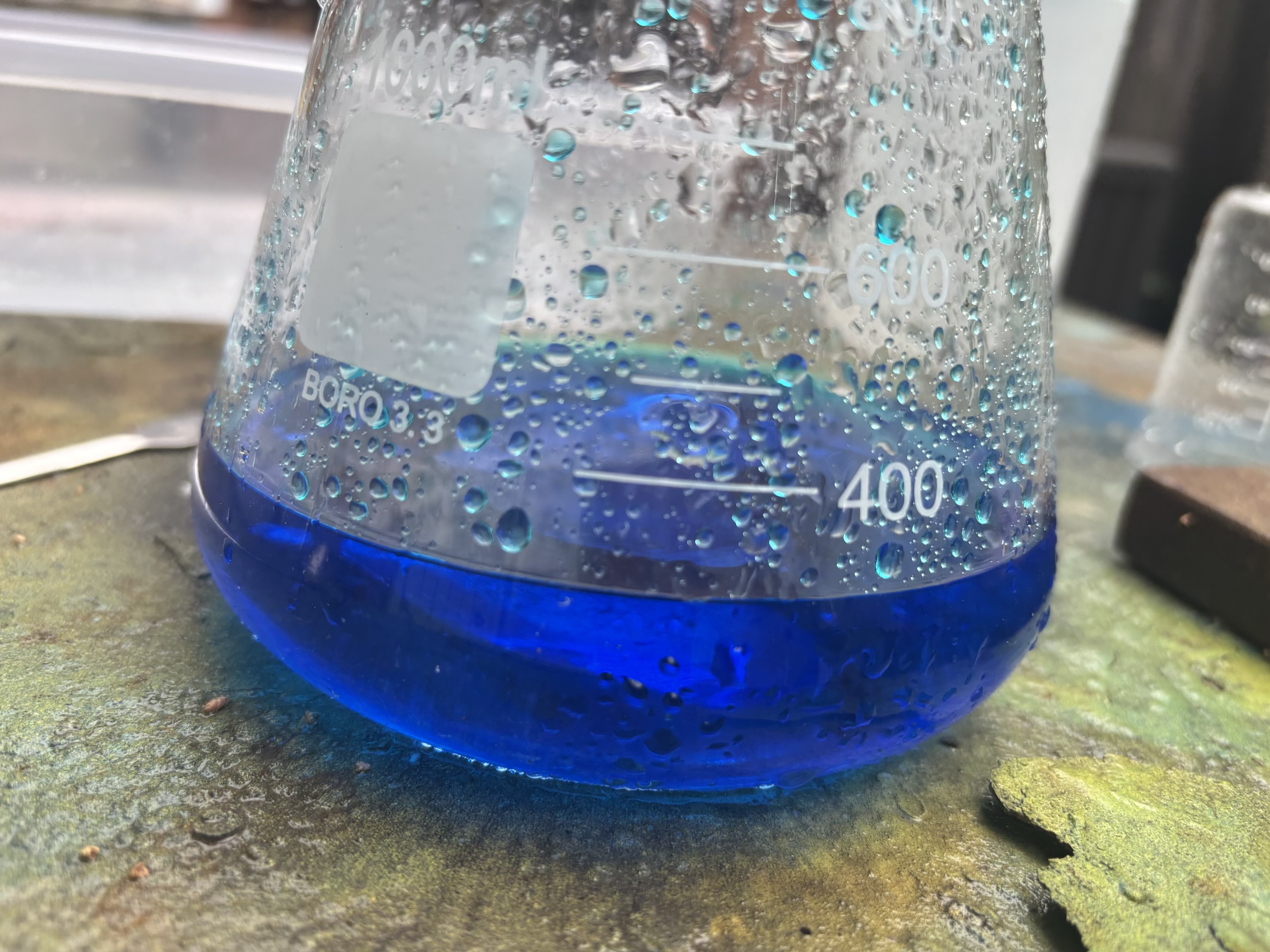

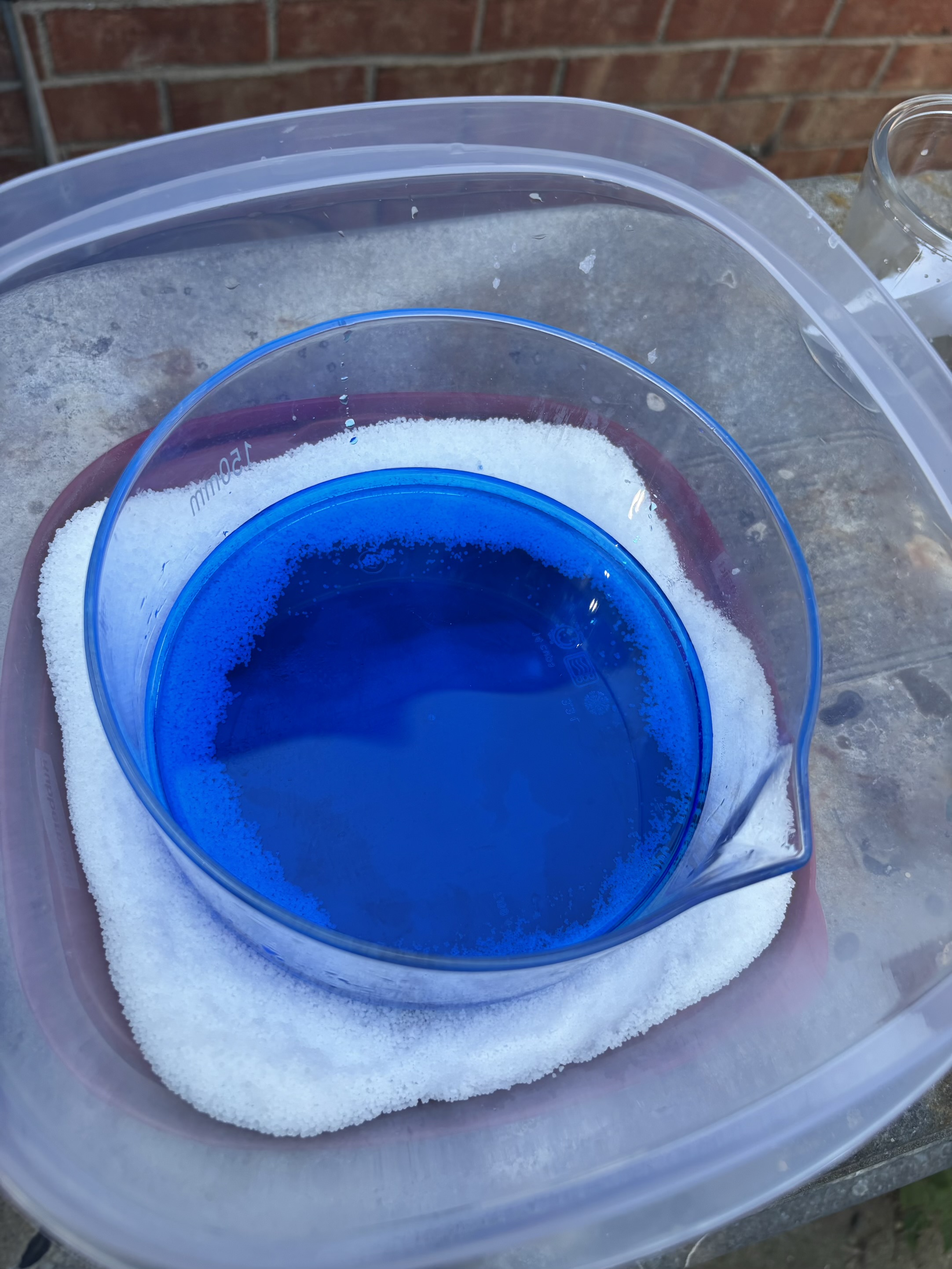

chloric1 - 10-7-2025 at 06:15
I bought a 8 inch desk fan from Walmart for $14 and a cheap one gallon flat plastic container. I made copper nitrate from 166 grams of copper sulfate and 157 grams of calcium nitrate tetrahydrate. After washing the precipitated calcium sulfate I end up with 850 ml of solution. I use this fan set up and even in 60 to 87% relative humidity in the middle of July I was able to reduce the volume significantly but now I got a much more concentrated solution that I don’t think I can get dry without a dedicator so that’s where the Tupperware and sodium hydroxide will come in more to follow up with later
IMG_7984.jpeg - 203kB

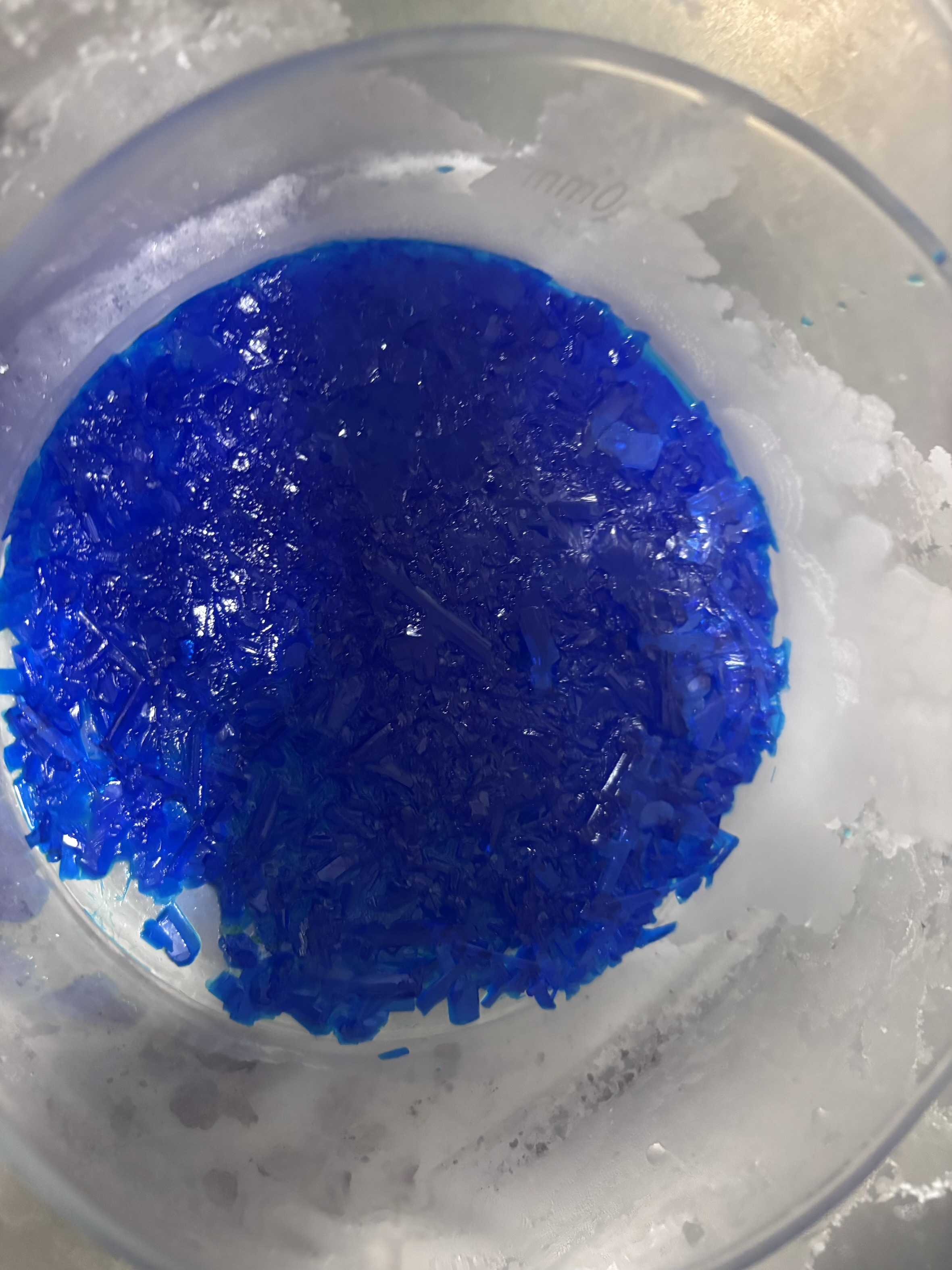

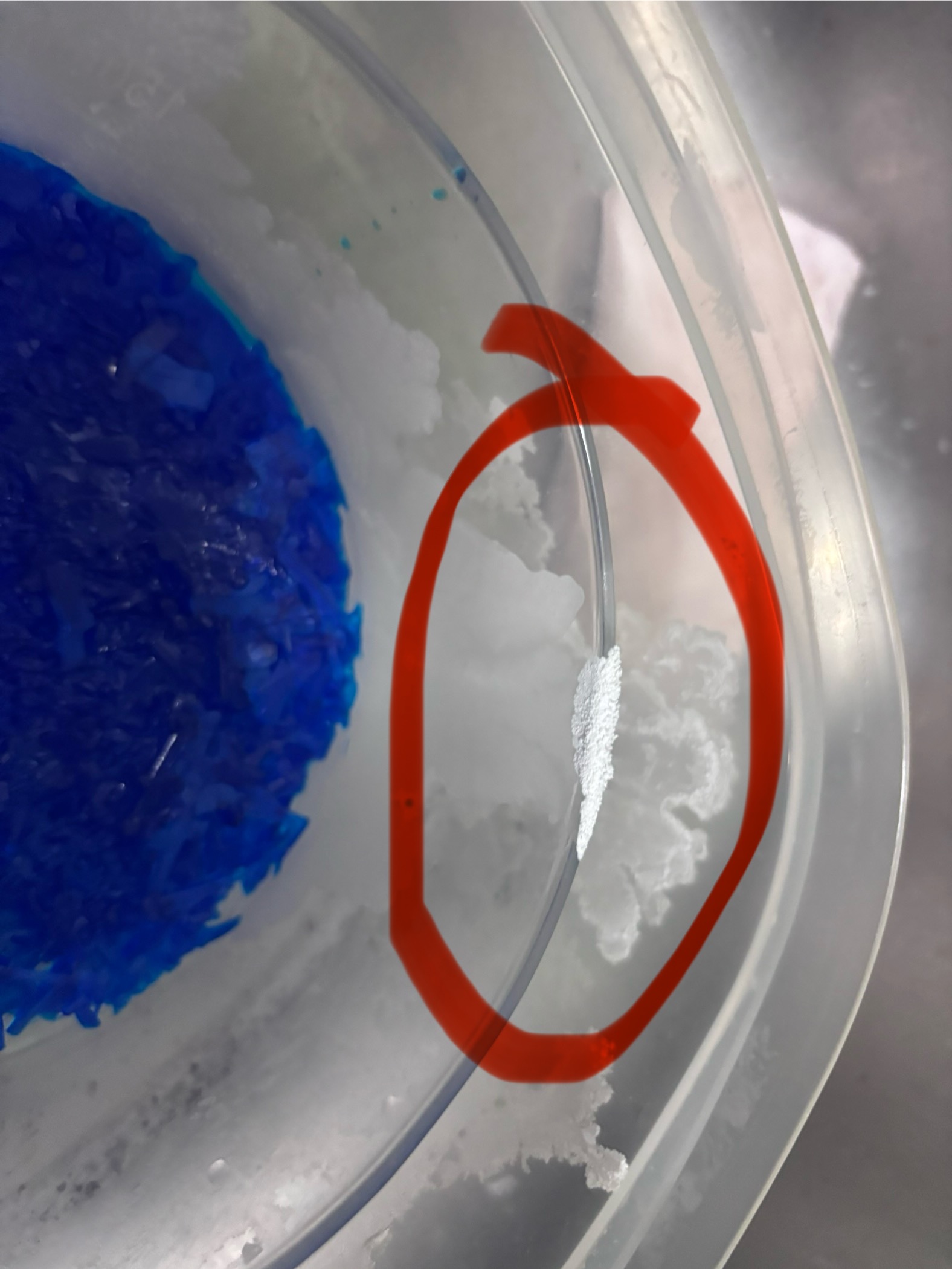

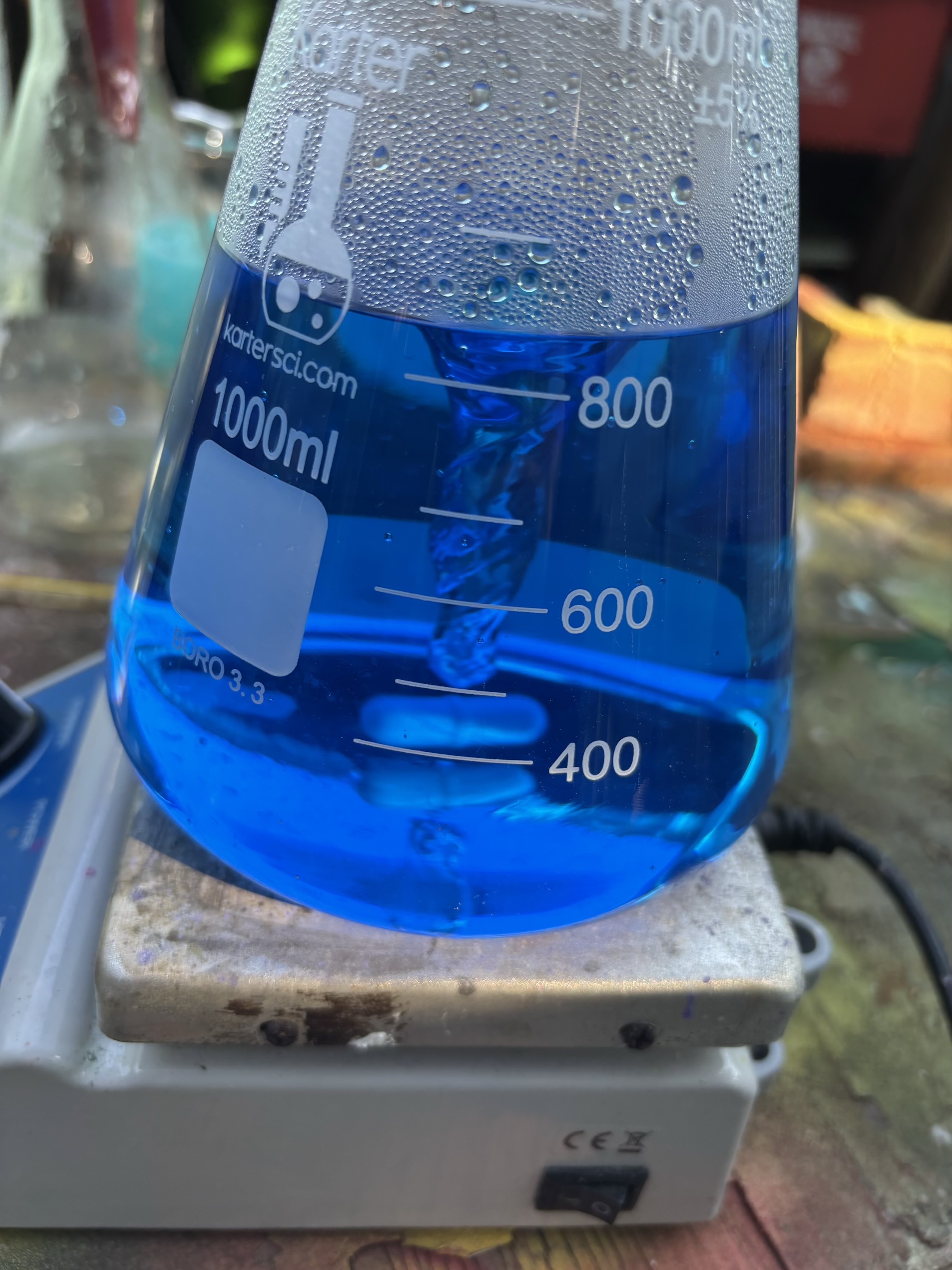

chloric1 - 10-7-2025 at 06:34
I managed to concentrate the volume to less than a third even in hot humid conditions. I’m considering not crystallizing it and keeping it as a concentrated solution.
IMG_7962.jpeg - 872kB IMG_7983.jpeg - 991kB

Copper Nitrate was produced from 69% HNO3 with Copper Carbonate.
Those were the good old days, when we could buy concentrated nitric acid in the UK.
Nostalgic reading these old posts from me (that I had mostly forgotten about).
Quote: Originally posted by zirconiumiodide
But DISASTER! Some of the Copper Nitrate, although a nice powder now has decomposed to a red Cupric Oxide which adds a rather unwanted impurity to my product.
That was weird, although I think I stirred the resulting mixture and ended up with a mostly blue powder.
11 years of storage and counting...

I think your spot on I just really wanted the concentrate solution to put patina on metals and have something besides copper sulfate for copper expiriments. I went ahead and set up my DIY Tupperware dessicator with sodium hydroxide just to see if it can be done with rudimentary means. I will probably just redissolve in solution with known copper content. The alkali does an admirable job in pulling water. When I free the brittle solid caustic brick from the clutches of my dessicator, I weigh it then combine it with same weight of distilled water. That way I get 50% caustic soda of commerce and any carbonate or other impurities are precipitated. Filter through cotton at 50 ° C to lower viscosity and I have refractive crystal clear lye solution that I use to make alkaline earth hydroxides and process heavy metals.
IMG_7989.jpeg - 851kB
CuriousOnlooker - 6-8-2025 at 19:31
~12 months later

chloric1 - 6-9-2025 at 05:31
After 8 weeks over NaOH
IMG_8104.jpeg - 1.1MB
chloric1 - 6-9-2025 at 05:36
Sodium hydroxide is good desiccant but one needs to keep and eye on it as it is one of those inorganic solids that like to “creep” vertically vis capillary action as moisture is absorbed! :o
IMG_8105.jpeg - 324kB
