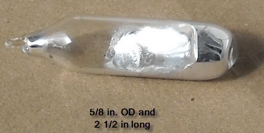

Zan Divine - 3-12-2011 at 21:21
Just made Cesium
Well, it was too damn easy.
Used patent US3164461.
This is a Li metallothermic redn. in vacuo @ 585 degrees C.
Yield is nearly quantitative in about a total 15 min of reaction time (at temp).
CsCl electrolysis - such a bad idea no comment necessary
CsOH + Mg - Just wait until you price CsOH.....Work up sucks
CsCl + CaC2 - lower yield, higher temp
Cs azide - Hah! Just try to get barium azide
I spent hours thinking about this before jumping in. CsCl + Li (or Ca) is the only way worth considering. Esp. if, like me, you copped 250 g of CsCl for $50 on e-bay.
Rubidium next...maybe. RbCl is $350/50g from only source I've found. Yeah, That'll be the friggin' day.....
Ahhhh....how about this?....Got a Rubidium halide? Want Rb metal? I'll do it for 50%.
PS What is that "harmless" doing under my name? You apparently don't know me......
PPS Yeah, I KNOW the pics suck. If you want to see full size ones I think this will do it:
http://i43.tinypic.com/drcl5l.jpg[/IMG]
http://i43.tinypic.com/20fpzsw.jpg[/IMG]
One of the harder things about making Cs was wading through the information/disinformation. Most notably: Cesium is pyrophoric. No, it isn't. At least not at 70 degrees F and 66% relative humidity. When I opened the reactor, I expected fire. The only fire I saw was when I touched molten Cs with a leather welding glove. Amusing.
The Process sm.jpg - 108kB The Setup sm.jpg - 88kB
[Edited on 4-12-2011 by Zan Divine]
blogfast25 - 4-12-2011 at 07:05
Interesting! Reduction of CsCl with Li and removal of Cs by vacuum distillation, if I understand well? Could you provide some more details, please? And more photos of the metal too, does it have that slightly golden shimmer that is claimed?
Is that a hair drier on the left photo?
('harmless' is an attribute any new member here gets. Not to be taken seriously)
[Edited on 4-12-2011 by blogfast25]
Zan Divine - 4-12-2011 at 08:09
This is a screenshot of the US patent. With % yields like those, and especially with the high purities reported, it's hard not to sigh and wish they hadn't made it so easy. I'd love to claim that my Cs was the end result of painstaking trials eventually culminating in sucess, but the truth is that I just followed the instructions.
This 12.5 g rxn. (of the cesium salt) was a quick and dirty scouting run whose main purpose was to get experience in handling Cs and to investigate if the physical construction of my apparatus was suitable.
Among my main questions was this one: Given that Cs vapor leaves the reactor near 600 degrees C, would I need to cool the exit pipe with water? ...or...maybe I'd need to heat it if the Cs froze in it? It was the latter, and that's the reason for the home-built high temp heat gun. Cs tended to freeze in the narrow downwards tube in the center of the vacuum take-off adapter as well as in the last few inches of the 12" long 1/4" stainless steel pipe. Gentle warming solved this problem.
My reactor is a stainless steel tube unto which I welded a standard ferrous pipe fitting (I really don't see why SS is mandated. Steel is suitable, as is monel.) allowing me to attach/detach the condenser pipe for charging/cleaning.
This is actually something I made for my phosphorus project. I'm going to make samples of all of the hard to get, "big-game" elements and offer them on e-bay to other collectors who shouldn't have to pay $100 - $140 per gram for Cs or Rb and those who should be able to buy a small sample of white P without selling their first-born. Bromine was first, cesium is in progress, rubidium will be next and then possibly white P. I need to see how dickish the DEA is about gram quantities. We all know that I2 and P are watched because of their methadrine connection, yet I see dozens of iodine samples for sale and a few (only red) P samples and as long as they are small, seem to elicit no hysterical overreactions.
I'll post pics today or tomorrow of my production scale apparatus which uses part of a SS "lecture bottle" (for gasses) as the reactor and an old heating element from an oven to provide a nice, sheathed source of heat.
The crude metal was submerged in mineral oil and it's hard to see it because the high index of refraction of the oil distorts the image in the small flask. In the future the receiver will be sized so that it is full at the end of the reaction. Now that the prelim. results are in and it's thumbs up, I'm going to rent an inert gas cylinder (big deposit, heavy pain in the ass) or see if heating (NH4)2Cr2O7 gives me a usuable grade and amount of N2. I'm going to eventually use a glove-bag & inert atmosphere to package samples.

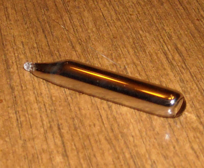

Our very own len1 synthesised cesium by heating CsCl with calcium under vacuum at 640 - 700 C. This was described in his book "small-scale synthesis of laboratory reagents"
Cesium.jpg - 87kB

Extremely interesting synthesis, congratulations! Seems a lot easier than I would expect for something like cesium.
In that last picture of the two ampoules, are they both cesium? The one on the left looks very distinctly silver instead of gold. It looks a lot more like one of the other alkali metals than cesium.

MrHomeScientist, Thank you and they are both cesium. The stuff degrades before your very eyes though. Even the dissolved oxygen in mineral oil quickly attacks it. Don't read too much into the color. Cs is silver just like the others. Trace oxygen contamination causes a golden hue to be displayed. The golden color is just part of the element's mystique. People want to believe it's intrinsic, but it really isn't.
I have no doubt at this point that making Cs is the easy part. Effective packaging of clean material will be harder.

This is a shot of the metal from my first production run. Pre-drying of the reactor, flame drying of the glassware and argon for the necessary blanketing during loading and unloading helped produce nice clean metal in 77% yield @ the 50 g (CsCl) scale. Yield is a bit lower than reported (90-98%).
As soon as I get my oxygen cylinder refilled, I'll be good to go with ampoules.
clean sm.jpg - 68kB

Zan Divine - 22-12-2011 at 07:47
I bought the Li this time, from GalliumSource in Ca. I've never found a better source for Li, Na or K than these guys. They pay the Hazmat fee and prices are very reasonable.
Now that the metal is clean, I'm rethinking my handling plans. Realistically speaking, I may get the glovebag atmosphere clean enough to handle the molten metal, but maybe not. So, given the ease of keeping Cs liquid, I'm wondering if an all-glass syringe, similar to those I've always used to transfer organolithium reagents, might not be the best strategy. Simply prepare argon-filled ampoules with rubber septa, and use the syringe to transfer from a septa-sealed flask of Cs under a slight positive pressure of Ar. The only exposere to air would come at the very tip of the syringe needle and hopefully any oxide, hydroxide or possible (?) nitride would be wiped clean upon piercing the septa on the ampoules.
Considering all the factors, I can probably get a cleaner product this way.
I cannot, unfortunately, redistill the metal in an all glass apparatus. This requires a better vacuum than I can attain. The original workers used diffusion pumps to get there. The original paper I worked from (the patent) claimed 99% purity as singly distilled. I've seen commercial samples that analyze at 99.5% and they, too, wet glass like mine. Only redistilled material above 99.5% (typically 99.9%) beads up on glass. surfaces.
This marks an accetible compromise to me. Only with additional manpower, equipment & time could I go from 99% to 99.9% and, truthfully speaking, collectors are forced, more commonly than not, to accept group 1 metals with relatively thick oxidation layers. Except in an ampoule, who ever sees bright silver, shiny K? Or Na (for more than tens of seconds, anyway)?
This material is bright and shiny, slightly golden-hued due to imperfect O2 exclusion, and I think this is a good compromise.
It kills me that my O2 cylinder will be out for weeks. I sent it for hydrostatic testing with the refillers....out of state! I had no choice. It's been > 10 years since the last one and they tell me that I'm not allowed to own a K cylinder and they won't simply swap for a full one. They will, however, refill the one I "own" ( It's been in my posession >15 years. You're damn right I own it insofar as no company is going to get it back only to charge me $5 rental/month). Legal disclaimer...this paragraph is fantasy. No responsible person would keep one of their cylinders just to save $60/year....would they?

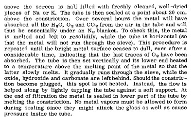

blogfast25 - 23-12-2011 at 06:46
That makes sense, Zan. You could flush the syringe too, I guess. For 99 % Cs that should really be sufficient and a lot less messier than glove boxes or glove bags...

Zan Divine - 12-3-2012 at 18:49
Hi Dennis,
Your observation that price depends on purity is quite generally true throughout all chemical industries & labs. That's why I've been careful not to compare apples to oranges and have priced accordingly.
However, to most element collectors there actually are generally accepted prices. The price per gram for Cs is quite simply the advertized price of the lowest priced provider that sells to the public and is easily found on the internet.
For most people in the US, that translates to GalliumSource. That means that the per gram price is $140 @ 99.5% and $165 @ 99.9% purity. I've noticed special orders on their website where Europeans have paid even higher prices. Your sources, of course, may vary.
The same goes for the $10/g price in bulk. For very pure Cs (99.99%), and at the 250 g size, cesium costs $2500 from GalliumSource.
The price of 99.8% pure caesium (metal basis) in 2009 was about US$10 per gram according to Polyak, Désirée E.. "Cesium" (PDF). U.S. Geological Survey. http://minerals.usgs.gov/minerals/pubs/commodity/cesium/mcs-...
The upcoming Rb synthesis, which will be done with Li and with Ca, is going to be analyzed. I'm very anxious to get this going, and by the end of this week I expect to do the Li reaction.
Eventually, I'm going to try to redistill a sample of my current Cs in an all-glass apparatus. Using a pressure-temperature nomograph, I estimate that with my pump I'll be able to stay within the operational range of borosilicate glass.
My biggest problem is too many projects at once. I'm also doing a lot of other custom work like the potassium shown below. This sample is 2.5 in long and 5/8 in OD.
front cropped.jpg - 54kB
[Edited on 13-3-2012 by Zan Divine]

Zan Divine - 13-3-2012 at 05:20
Hi Dennis,
Thanks for the comment on the K. I used a method described in "Handbook of Preparative Inorganic Chemistry Vol 1" by George Brauer.
As I couldn't lift the actual text, I've taken a couple screenshots and they are below. I modified the procedure a bit by glassblowing a spherical section in the melting area for larger capacity and by evacuating the tube before starting. It works amazingly well, and for those without the capability to apply inert gases or vacuum, it is unbeatable.
About Cs & collectors...another point about collectors is that for group 1 elements, they are used to having to settle for heavily contaminated samples. Usually no silver color whatsoever is seen. Most Na & K samples look like pieces of off-white marble. This is not to say this is what they want, it's just what's available. Everyone who has wound up with my Cs @ $50 (be it 99% or whatever) knew about GalliumSource but figured, I think, that saving 2/3 of the price and sacrificing 1% of purity was a good deal.
This is not to detract from your comments on Cs, which were good points, but the reality of most collections is that reasonable concessions save enough money to pay for the next sample or two.
We all seem to have the same common grouse...never enough time!
part1.jpg - 25kB part 2.jpg - 55kB

Fleaker - 22-3-2012 at 10:36
It's ok! Life happens. I had the opportunity to play a little bit in the lab. Made a little sample set for a nice fellow who inquired. I imagine he'll put them in better bottles!
They're too small to use induction on, so I melted all of them with O2/H2, except of course the Ag. I plucked that out of one of the silver refining cells.
Might make some Pt, Pd, Ir, Ru, Rh Os, and Au gas phase grown crystals soon--I am prepping up for black phosphorus re-trial.
IMG_0972.JPG - 100kB
