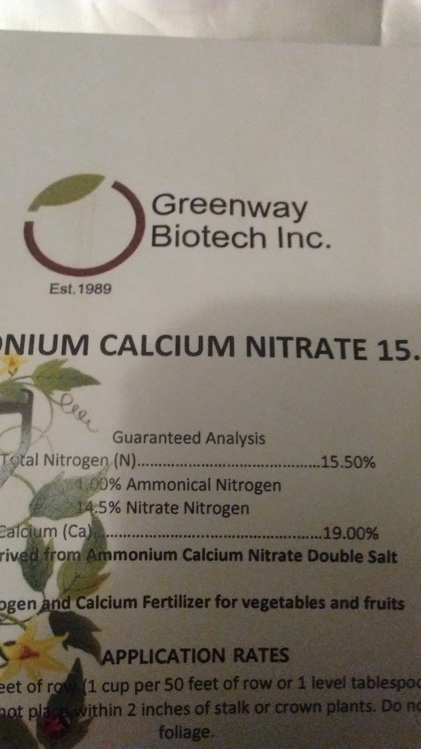

yobbo II - 3-5-2017 at 11:40
https://en.wikipedia.org/wiki/Calcium_ammonium_nitrate
wiki has some good confusing info on Calcium Ammonium Nitrate. It is written is consusion style so that you do not know when they say calcium ammonium nitrate are they referring to calcium carbonate + ammonium nitrate (physical mixture) or the double salt ammonium calcium nitrate.
Attached is a description of 'calcium ammonium nitrate' CAN containing no calcium!!
EDIT:
The thread that shows the bag of Double salt, Ammonium Calcium Nitrate fertilizer (says it on the bag) is here:
http://www.sciencemadness.org/talk/viewthread.php?tid=73415
Picture reposted below.
This stuff is (imo) very rare in europe. Could be wrong.
http://www.sciencemadness.org/talk/files.php?pid=480681&...
A thesies on ammonium nitrate based fertilizers is attached. You'll be 'black in the face' reading it.
It's all rather complicated with lots of small amounts of different additives that can be used for various purposes.
