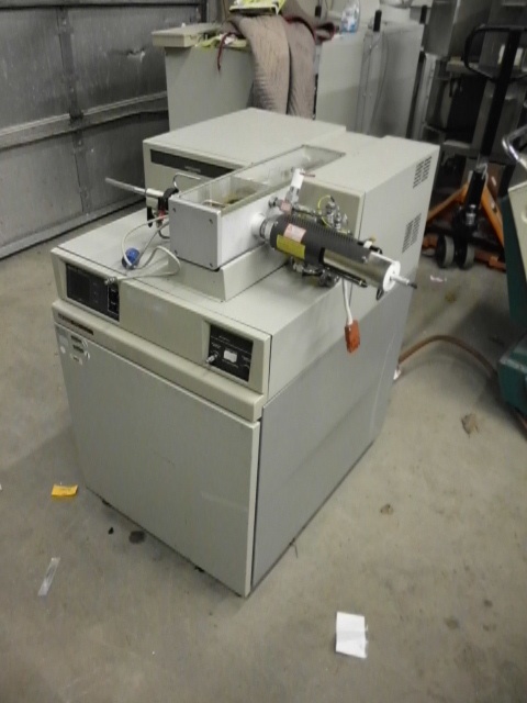

I hope anyone can help me with the next problem with the FTIR.
Beginning is here:
http://www.sciencemadness.org/talk/viewthread.php?tid=7770
(WIN-IR is running properly, the problem was caused by a dongle in the printer port as copy protection for WIN-IR and I thought the copy protection would be read from the FTIR's interface so I overlooked the dongle which looked rather like a printer adapter than a protection dongle, but after I opened it and saw a chip everything was clear.)
Now I tried to get a proper spectra of a polystyrene film which I got as testing sample for the FTIR, but the spectra starts suddenly to oscillate wildly from 1/2500cm to the lower wavenumbers/higher wavelenght:P (photos I uploaded), but between 1/4000cm and 1/2500cm are exactly the peaks you would expect of a polystyrene transmission sample like this one:
http://animl.sourceforge.net/Minutes/2005/20050617%20Virtual...
There's one piezoelectrically cooled DTGS detector inside, but DTGS detectors are normally rated for the entire mid-IR range, so this couldn't be the the reason.
It might be caused by the beamsplitter, I don't know from what it's made of (transparent in normal light,so maybe KBr or KRS-5) but can a opaque beamsplitter (if not made from something mentioned above) cause such a sudden oszillating?
When I block the beam by placing a piece of wood into the sample cell, the oszillating is in the whole area from 4000-400cm^-1
Could the reference laser for the infernometer cause this, if you look close to the photo with the detector you can see the laser beam on the detector, it's lasering through the sample cell, but I think it shouldn't do this.
I hope anyone with experience with FTIR's could help here, probably I've overlooked some settings in the software.

benzylchloride1 - 23-6-2012 at 18:00
I just bought a Hewlett Packard 5989 quadrapole mass spectrometer. I plan on interfacing it to a HP 5890 series II gas chromatograph that I bought last year. The HP 5989 is a fully functional mass spectrometer that can interface with a GC, HPLC or direct sample injection. At the moment, the system is capable of both electron impact and chemical ionization, I hope to add APCI once I get the instrument up and running. I will have the instrument in a few weeks and will begin to gradually sort out the details. It looks like this is going to take a few years to get going, due to my limited budget being on a graduate student stipend and the expense of mass spectrometers in general. I plan on having the 60 MHz NMR spectrometer I bought last year interfaced with with a computer within a month or two. Does anyone have a source of HP Chemstation that would run on MS DOS or Windows 95 that they could sell to me reasonably cheaply? I cant get away with strip chart recorders for mass spectroscopy.
[Edited on 24-6-2012 by benzylchloride1]
