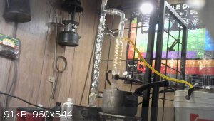

I did an ethanol extraction of some camphor laurel leaves. This was more an excuse to use the soxhlet than anything else. But given that my street is lined with these trees, camphor extraction has been on the list for a while. I doubt my efficacy. I seem to have a lot of chlorophyll even though the leaves are dry and brittle. I will leave my bag of leaves a month or two more and try again. Probably a different method too.
Today I got my 8y old son to help me distill and recover the ethanol. It was a chance to use my Graham condenser: the cool appearance surpasses its functionality in most situations but it performed beautifully in this instance. Distilling ethanol is so satisfying: it just pours out of the condenser. My son enjoyed it too. Good times.

j_sum1 - steam distillation?
as you have plenty of material for free, maybe you can build some medium scale apparatus from an old pressure cooker
arkoma - 2-1-2020 at 00:56
Yup. Only use i've ever had for my Graham. LOL

arkoma - 5-11-2020 at 23:18
Figured i'd see what the heck my semi-crappy vacuum gauge was doing for real, so I set up for simple vac disty with h2o.
results:
(temps are B.P,'s)("inch" figures what my gauge read)
66C showed 25"=286mmHG
73C showed 21"=354.2mmHG
88C showed 15"=535.4mmHG
Ain't been real scientific lately, so its something......

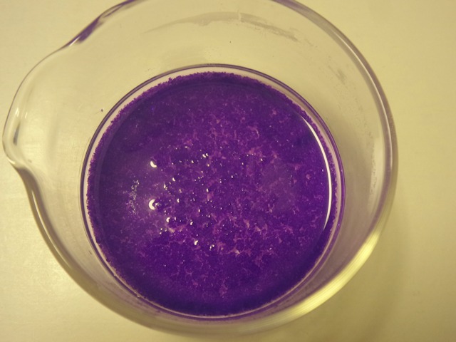

Made some Ni(en)3I2. Dissolved this in dilute KI to recrystallise.
20201114_162514_adj_30pct_small.jpg - 78kB

MidLifeChemist - 16-11-2020 at 21:59
Did you do that to reduce the solubility via the common ion effect?
Bezaleel - 17-11-2020 at 06:15
No, it's just a final purification step, to get rid of assumed co-crystallised chloride.
MidLifeChemist - 17-11-2020 at 08:07
Got it - ok I'm assuming the idea is that the iodide ions from the KI will replace the chloride ions. So why do you need to do this second step - to get the Ni(en)3I2 the first time, did you simply boil away or evaporate the solution, is that why you need to recrystallize? And how do you know this is the iodide and not the chloride? I couldn't find any references to Tris(ethylenediamine) nickel (II) iodide or to its solubility. It looks like an interesting compound that I may want to try to make one day. Thanks in advance for the info!
Bezaleel - 17-11-2020 at 10:03
Posted my answer here.
