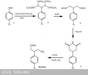

I was looking for a new compound to synthesize and my eye fell on baclofen. There are some nice reactions I didn't do before.
The article that caught my attention was the one attached... Well, after stumbling on some strangely formulated sentences (in the discussion), I started looking at the described reactions.
Naamloos.jpg - 31kB
First I wanted to figure out the mechanism of the first reaction and I realized the first step is not a Claisen condensation as claimed in the discussion, but a sequence of two different reactions, namely the Knoevenagel condensation followed by a Michael reaction (I think). Is this possible? With piperidine as described in the article this shouldn't be a problem (the condensation reaction forming water), but an alkoxide as discussed in the discussion would be destroyed by the water. Or is hydroxide strong enough as a catalyst? I have sodium metal, I have sodium hydroxide, but no piperidine or pyridine.
What surprised me most was the synthesis of the glutarimide ring, directly from the glutaric acid with aqueous ammonia. Is this possible? If not no problem, then I will do an urea/microwave melt as described below, but a direct glutarimide ring with just ammonia would be easier. It could also be done via dehydration to the phthalate anhydride with acetic anhydride, but that I don't have.
The Hofmann rearrangement I will do with hypochlorite.

Edit: I now realize that 1,1-ish mole of sodium (about 25 gram) as sodium ethoxide, would be enough to drive about 380 grams of reactants to form product 2 (if 100% yield), not as a catalyst but as reactant. Which doesn't sound too bad.

I'm a bit confused: I'd expect to see a dialkyl malonate used in the first step, but acetoacetate is used - and then the product is deacetylated faster than it's decarboxylated?!
Posts: 2829
[*] posted on 16-11-2018 at 13:48
I understand your confusion... I didn't look at the mechanism of the second step yet.
I'm less good at this than I would like to be, but do you mean that with acetoacetate, and decarboxylation being faster than deacetylation , this reaction would lead to a ketone instead of a carboxylic acid? As the reaction as proposed in the paper would only go with a diacid?

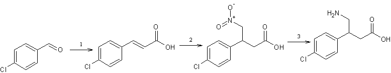

Another route to baclofen:
1.http://revroum.lew.ro/wp-content/uploads/2009/RRCh_11_2009/A...
2.michael addition using excess base
3.reduction
baclofen.gif - 3kB

Looks very doable CuReUS, but I don't have nitromethane anymore and that is one of the few chemicals I can't buy... I finished my last bit I bought OTC 12 years ago. The route suggested I choose because I have almost all chemicals.
I agree that it is unusual but the decarboxylation of a malonate ester is a two step procedure where the decarboxylation happens under acidic conditions. The deacetylation of acetoacetate esters occurs at the ketone, entirely under basic conditions. See pages 475-476 in Vogel's practical organic chemistry.
If you would subject the acetoacetate ester to the two step procedure you would end up with the wrong product. Vogel mentions better yields are obtained with malonate esters which may or may not be true for this baclofen intermediate.

The formation if the glutarimide ring should work alright with ammonia, similar approaches are used to prepare other diacetylamides with ammonia.
http://www.prepchem.com/synthesis-of-succinimide/
https://www.youtube.com/watch?v=Ir3rmvNAgh8
The prepchem example is rather crude but from what it looks like stoichiometrically, both acids are neutralized to their respective ammonium salts indicating that a loss of ammonia is required during the main dehydration part of the reaction.

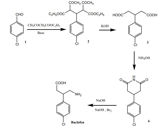

Now as for the rest of that reference from the Iranian chemical communications.
That work doesnt look origional to me, the first clue was where they stated using ethyl acetoacetate when in their pathway drawing they clearly used methyl acetoacetate.
I did a little digging around and found another reference from a paper from what looks like an indian student from 2014.
Attachment: IJIPSRMN-27.pdf (1.1MB)
This file has been downloaded 413 times
Following her references around yielded little results except this 2010 paper that didnt actually have anything about that particular scheme in it.
https://sci-hub.tw/https://www.researchgate.net/publication/...
Anyway my point is, this is not an original scheme, its clear it was netted from elsewhere but precisely where i am having a hard time determining.

I'm now thinking about doing the first step with diethyl malonate, as the second step might work with the ethyl acetoacetate phenyl compound, but if that would work, it will most likely also work with diethyl malonate.
I dont understand.Why don't you want to use acetoacetate when you have the ref for it ? (although all the reactions I have seen that use acetoacetate give ketone rather than carboxylic acid after base/heat treatment,like atara said above)
The third step would be performed with urea in a microwave, as I have little confidence in the glutarimide ring formation with aqueous ammonia. The Hofmann rearrangement should work as predicted.
actually,you could get baclofen in 1 step from the diacid by doing a schimdt reaction using 1 mole of azide
[Edited on 19-11-2018 by CuReUS]
I was a bit doubtful about the reference, and after Atara's comment I wanted to go for safe. But I like all your reactions! when I have time I will have a better look at them... too bad I actually have to work during working hours nowadays. I like your azide idea, I can't find references about it though, do you have one? Or a bit more about the mechanism?
[Edited on 19-11-2018 by Tsjerk]

Based on what Sigmatropic found in Vogel's, I think that you should give the standard lit route a chance. I find it confusing that acetoacetate was preferred for this preparation; nevertheless, the double-addition of two Michael acceptors to a carbonyl group is not a common transformation, so it may work better with some reagents than others for unknown reasons.
The cyclic imide formation and subsequent Hofmann degradation seems like a perfectly workable process, and I see no reason to replace this with the Schmidt variant of the Curtius rearrangement. The formation of a cyclic intermediate seems like it would have the desired effect on selectivity that you mention. However, there are a few things we might consider:
- When N-bromosuccinimide is subject to the action of alkali, the ring cleaves to a succinate mono-N-bromo-amide which undergoes Hofmann degradation as expected. Since the Hofmann degradation is a notoriously fidgety reaction, it might be better performed stepwise by pre-forming the N-bromoimide. This can be accomplished by dissolving the imide as its sodium salt in water that is not too alkaline, and then adding bromine, which should precipitate the bromo-imide. The precipitated bromo-imide can then be subject to concentrated alkali to obtain baclofen. This should avoid over-halogenation.
- It may be possible to convert the diacid to a cyclic anhydride, similar to the formation of succinic anhydride from succinic acid on heating. If this cyclic anhydride can be formed, it should react selectively with sodium azide or another source of N3- to form the diacid mono-azide. This will then undergo a Curtius rearrangement targeting exactly one carboxylate group, yielding baclofen with high selectivity. A major advantage of this technique is that there is no need for the use of hydrazoic acid or any activated source of azide. However, contacting the anhydride with sodium azide may not be trivial. I do not know if there is a standard way to solubilize N3- in an aprotic solvent. The Curtius rearrangement is generally cleaner and higher-yielding than the Hofmann degradation, but the most tempting approach to this rearrangement depends on the generation of the cyclic anhydride (3-(p-chlorophenyl)-glutaric anhydride) which I cannot guarantee.
[Edited on 19-11-2018 by clearly_not_atara]

Acetoacetate makes a fine acetyl synthon. The first step is essentially the Hantzsch Dihydropyridine Synthesis without any amine to close the pyridine ring.

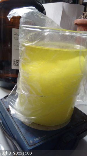

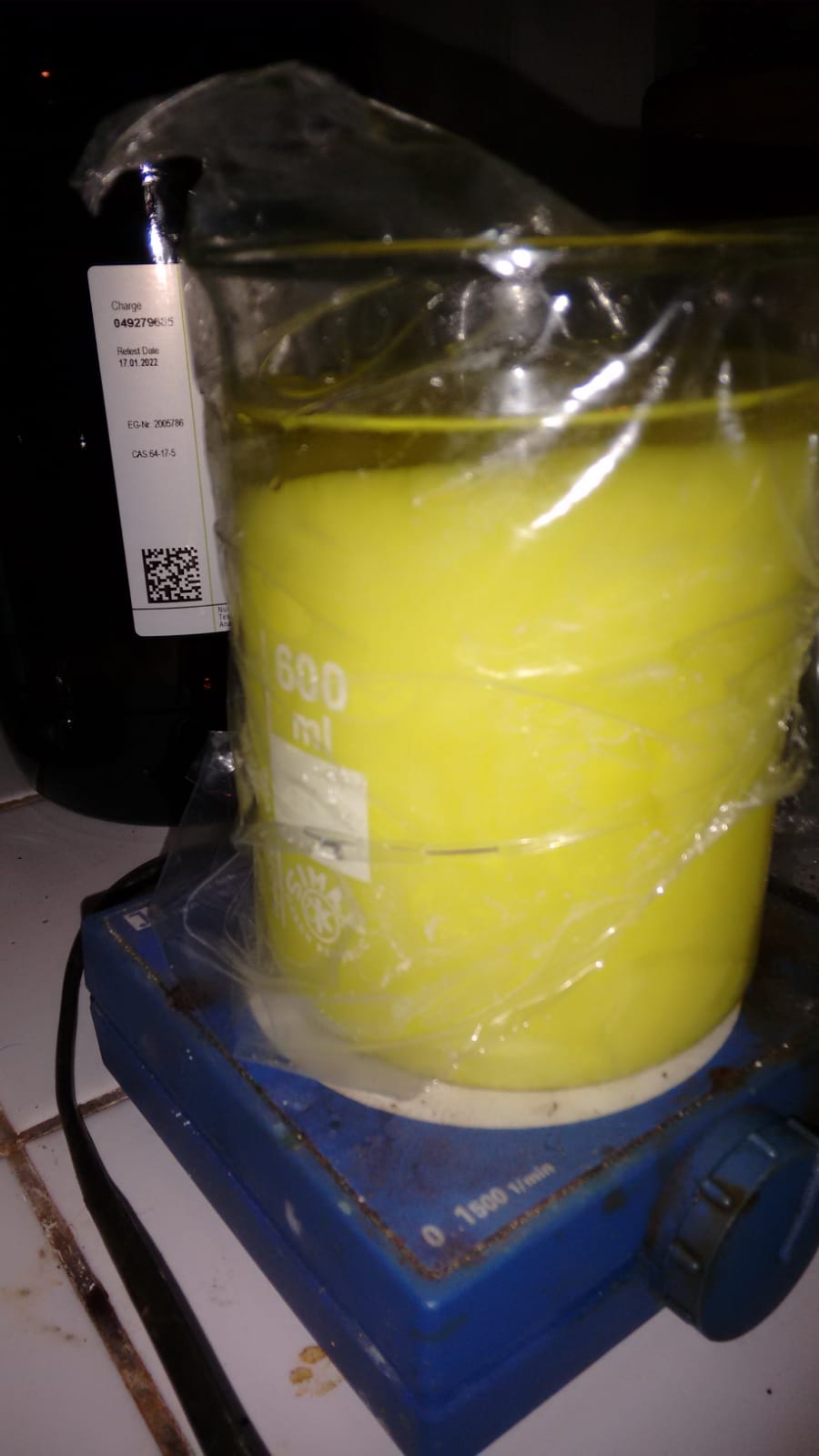

I have the feeling the first step is going fine. I started as was described in the publication I cited in the first post. I started with a bit more product than I would normally go for but I had trust in the fact at least the first reaction should work, if so that would give me some material to work with.
I started the reaction by mixing ethyl acetoacetate (102.1 grams, 100 ml) with 4-chlorobenzaldehyde (53.8 grams, 2.05 eq.) and 5 ml diethylamine. I cooled everything on ice before adding the catalyst, but I don't think this is necessary because I didn't notice any exothermic reaction and the reaction is slow as a brick anyway. I ran the reaction for 24 hours, diluted with 400 ml 99% ethanol and cooled to -20 for 12 hours. A bit of white solids precipitated on the bottom of the beaker. I was a bit afraid this could be water, but it stayed solid after getting above 0, so apparently not.
Now I was getting a bit worried whether this could be 4-chlorobenzoic acid as I'm not running this in a closed vessel. I don't think so because this compound is highly soluble in ethanol it appears. My concerns were taken away for the most part when I saw the precipitate starting to build up. I'm only getting photo's of it every 24 hours because I'm not physically there (my mom is getting the photo's ;), but the photo's are promising.
IMG-20190311-WA0000.jpg - 88kB

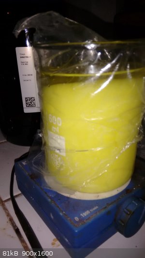

After 24 hour run, diluting with ethanol, 12 hour freeze at -20 and getting back to ambient temperature (8-10 degrees).
IMG-20190312-WA0012.jpg - 87kB

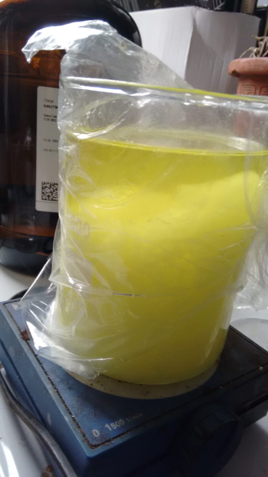

After running for another 72 hours.
IMG-20190312-WA0014.jpg - 81kB
after 120 hours
[Edited on 12-3-2019 by Tsjerk]
[Edited on 13-3-2019 by Tsjerk]

Nothing seems to be happening anymore. I will filter and wash with 50% ethanol tomorrow evening. Let's see what we've got!
Depending on the speed of drying I can maybe already do the decarboxylation with NaOH tomorrow... I think I will suspend the material in water and add the NaOH prills to that suspension while stirring. That will probably heat up a bit but I guess that is more controllable than adding a concentrated NaOH (actually KOH is suggested) solution to the solid material which is suggested in the paper.

I think the deacetylation and hydrolyses worked. The yield of the first step was only 22%, but that still gave me 33 grams to work with.
I dissolved 79 grams of NaOH in 225 ml of water and poured that over the compound of reaction one. The mixture turned bright yellow, that color disappeared after about an hour and after one and a half hours a drop of the reaction mixture cleanly dissolved in cold water. Most solids dissolved after adding two volumes of water to give a dark yellow solution. This was washed with DCM and 0.66 eq volume of 30% HCl was added. The yellow disappeared and a white solid precipitated. This was filtered and washed with ice water.
Edit: the reaction was done at 90 degrees.

I screwed up the recrystallization of the baclofen, so I think that 33% could be raised significantly.
*acetoacetic ester: The synthesis of compound 1 can be done almost quantitatively with ethyl acetoacetate being used in a 2,5 molar eq. quantity and a 10% molar amount of di-ethylamine. Probably other secondary amines can be used in a similar fashion. The reaction mixture is crystalized from 6 volumes of 50% ethanol in water and washed with 50% ethanol in water until white.
**Diacid: compound 2 is synthesized by decarboxylation and deacetylation in 6.5 molar NaOH at boiling water bath temperatures. Compound 1 is finely ground and added to cold 7 molar NaOH and heated to 100 degrees for 2 hours. 2 eq. volumes of boiling water are added and the mixture is heated until most solids dissolve. The mixture is filtered hot and cooled to RT. 50% v/v sulfuric acid is added until pH 3 and the mixture is cooled again to RT. After filtering the filter cake is washed with cold water until the filtrate is pH neutral.
***glutarimide: This product was prepared via the di-ammonium salt and the mono-urea salt of compound 3. Both need heating until melting (approximately 200 degrees) to liberate water/ammonia in order to form the glutarimide. It was found heating in an oven or on a heating plate of the two salts gave comparable yields at around 30%. Microwave irradiation at 850 watt of the di-ammonium salt gave a yield of 50%. The microwave treatment of the mono-urea salt, 6 minutes at 850 watt, gave a yield of 77%. In all cases the mixture was heated until no bubbles were given off.
****baclofen: pH 7.5 seems to be very important for a proper yield as the product dissolves at anything above pH 8 or below pH 7.
