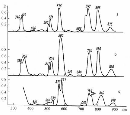

not_important
Posts: 3873
Registered: 21-7-2006
[*] posted on 16-10-2009 at 07:48
Sounds convincing, yet a number of texts state that Nd2(SO4)3 is made by dissolving Nd2O3 in H2SO4. An absorption spectrum would be enlightening, I suspect.
It is possible that you are forming a sulfo-complex, which is not described in any detail save being yellow-brown in tint - at that time under daylight, incandescent light, or gas lights, all continuous spectrum sources. Fluorescent lights are generally discontinuous, with not too much overlap with the Nd lines, mostly in the blue-green and yellow-green regions. The spike around 460-470 nm in white LEDs lands in the weak & narrow blue bands of Nd, the longer wavelength bands of Nd should result in a greenish-yellow to pink colour depending on the exact phosphor in the LED.
http://en.wikipedia.org/wiki/File:Fluorescent_lighting_spect...
http://en.wikipedia.org/wiki/File:White_LED.png
the attached image is of fluoroberyl , fluorophosphate, and silicate gasses doped with Nd(III). It doesn't quite math the aqueous spectrum, but shows how little impact the environment has on the f-shell bands.
Nd_in_flouride_and SiO2_glasses.jpg - 19kB
kmno4
Posts: 1523
Registered: 1-6-2005
[*] posted on 16-10-2009 at 16:03
Spectra of aquenous solutions of Ln are available in mentioned Handbook vol.3 in chapter 24.
Important feature of bands is also intensity and looking at pictures presented above I would not say that effect of matrix is small.
There is some effect in Ln solution: some absorption bands are very sensitive to chemical environmental (ligands) of Ln ions. It is called "hypersensitivity" and may be responsible for different colours of sulfate and nitrate solutions.

I now did a lot of further experimenting at a larger scale.
I took 5.0 grams of Nd2O3, 3.0 ml of conc. reagent grade H2SO4 and some water. I added the acid to water, such that I had appr. 40 ml of liquid. To this, I added all of the Nd2O3. The Nd2O3 dissolves, giving a brown/yellow solution. Quite some heating is required to get all of it dissolved. When all has dissolved, heating is continued, until boiling. This results in formation of a lot of pink crystalline precipitate and formation of a yellow liquid above the precipitate (yellow in TL-light, golden yellow/brown in daylight). This golden yellow liquid I call liquid Y.
I decanted the yellow liquid from the pink crystalline mass (which can be done easily without introducing any losses, the precipitate really consists of fairly large crystals). I rinsed with 20 ml of boiling hot water. This rinse water becomes yellow as well, but after a few swirls it becomes more like grey (probably some of the solid dissolved, leading to a mix color of grey). I rinsed a second time with 20 ml of boiling hot water. This second rinse was pale lavender. No yellow material is present anymore.
Next, I put the pink crystal mass on a filter paper, which in turn was put on a few sheets of household tissue. Most of the water was absorbed by the household tissue. The solid material then was scraped from the filter paper and put in a petri dish and placed in a warm dry place (40 C, dry air, free of dust). Within a few hours the material was dry and a pink solid is obtained. The solid is not hygroscopic at all. Yield is 5.1 grams, which is appr. 50% of all neodymium (assuming that neodymium sulfate is Nd2(SO4)3.8H2O). The losses due to rinsing probably are a few percents and there may be some mechanical losses, but I'm quite sure that at least 40% of the Nd is in the yellow liquid, which is decanted from the pink crystals.
I dissolved some of the pink crystal mass in water (which takes a loooong time) and tested for iron with concentrated ammoniumthiocyanate solution. This test is 100% negative. The addition of the thiocyanate does not lead to any visible change of color.
I also tested the yellow liquid for thiocyanate. This liquid does show a positive, the liquid becomes pink/rose when thiocyanate is added at high concentration. This means there is some iron, but only a very small amount.
Next, I took appr. 0.5 grams of the neodymium sulfate crytals, dissolved in water and then precipitated with ammonia. The precipitate was filtered and rinsed with water and next it was heated to a red glow in a quartz tube. This calcined material was added to 20% sulphuric acid and dissolved by heating. This leads to a brown/yellow solution. On boiling, a lot of pink crystalline solid was formed and unfortunately, now I had too little water in it. ALL of the liquid turned to a pink solid, it only was wetted somewhat with water between the crystals and that liquid had a brownish/yellow color.
From the yellow liquid Y (see above) I also took some and made a precipitate with ammonia. When I next add ust enough sulphuric acid to this liquid, then the precipitate slowly redissolves again, but the color now has changed. I looks lavender. After a while the liquid becomes opalescent again. It seems that there is some hydrolysis. I added a few more drops of dilute H2SO4 and then the liquid became totally clear again. Now its color had changed again. It was grey in TL-light and almost colorless in daylight (very pale grey).
From this I conclude that there indeed exists a yellow/golden form of neodymium sulfate in solution and a lavender form. The difference must be the coordination of sulfate to neodymium. There is some iron in the original Nd2O3 I purchased, but it is only a tiny amount. But it is there, so this might affect the outcome somewhat.
Pictures of all the things, described above, will follow later this week.

It is interesting.
I also dissolved Nd2O3 in H2SO4 without strange colours.
My eyes noticed only the pinks violets...
Also known to me literature does not say anything about yellow/brown colours in the case of simple salts of Nd.
Even in case of solid Nd(HSO4)3 or (NH4)[Nd(SO4)2(H2O)3]H2O only light-violet colour is reported (Acta Cryst. (2006). E62, i169–i172 and Z. anorg. allg. Chem. 624 (1998) 1583-1587).
Unfortunately the X-MET I have access does not see this metal and Ln at all (I think). It shows mixture Mn, Fe, Zn... etc instead of Nd. :(
If anyone knows any literature about yellow or brown colored simple salts of Nd, it would be very desired to post it here.
