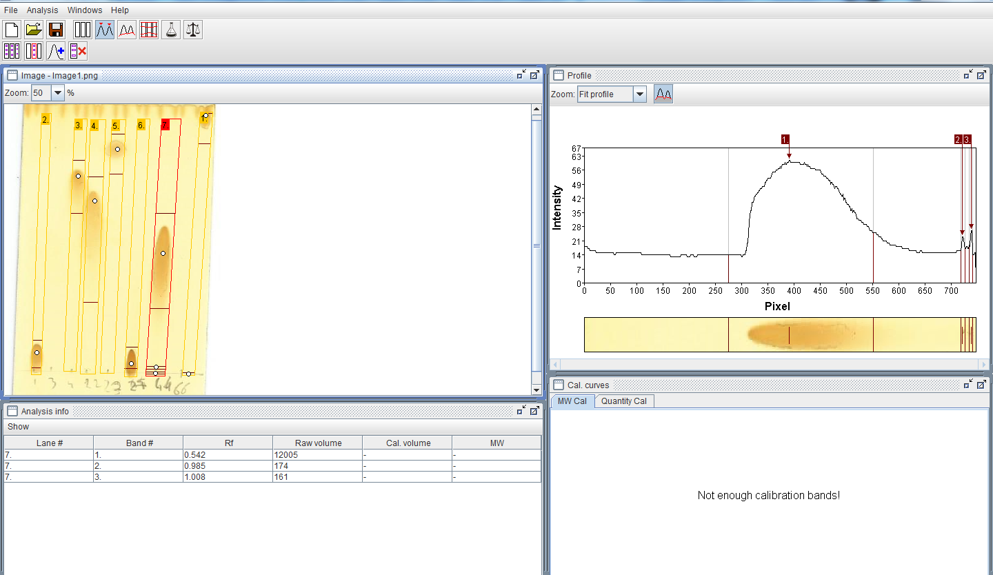

brubei
Posts: 180
Registered: 8-3-2015
Location: France
[*] posted on 21-2-2017 at 02:30
Another free usefull software : gelanalyzer
http://gelanalyzer.com/download.html
vsxFZ6F.png - 175kB
Harristotle
Posts: 138
Registered: 30-10-2011
Location: Tinkerville
Mood: I tink therefore I am
[*] posted on 21-2-2017 at 03:36
TLC visualizer
NIH Image, or its java port, ImageJ.
Just the best for gel, tlc and densitometry, in my opinion, and free.

Posts: 1749
[*] posted on 21-2-2017 at 10:27
How do you use these pieces of software. Do you scan the plate on an ordinary flatbed scanner or photograph it (under UV light if you can) with a digital camera or something and then open the image in the software and highlight the area to analyse? Even just the densitometry facility would be useful.
@Harristotle. Do you have a bit more info on the TLC visualizer like a partial web address. I tried running "TLC visualizer" etc through google but I mostly about various bits of hardware by CAMAG.
I found the gel analyser software though. Does anyone have any experience of it?
