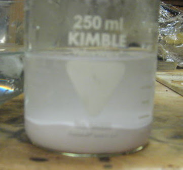

So I set out to try and quantitatively isolate the neodymium from neomagnets - Nd2Fe14B. 35 g of magnets were demagnetised by heating and cracked with a hammer. Only part of the Ni-Cu-Ni protective layer was removed and the magnets dissolved in 155 ml of 36 % HCl, on a low setting hot plate and covered with an hour glass. The cover material was later found back but the nickel had dissolved, possible small amounts of copper too. Strong, meaty smell, some suggest of boranes (?)
After filtering and washing the filter cake (mainly undissolved boron) the solution was simmered back to about 250 ml of emerald green solution, covered to prevent loss of salts. To this hot solution, 25 g of crushed (and previously recrystallised) K2SO4 was added, a quantity corresponding to approx. saturation at 20 C. Immediately a quite large amount of precipitate formed, presumably the unspecified double salt of Nd2(SO4)3 and K2SO4 and the solution/slurry simmered for a bit, the allowed to cool. No further precipitation on cooling was observed. With flash on, the precipitate can be clearly seen:
This was filtered off on a coffee filter (which with hindsight was oversized) and the filter cake washed with about 200 ml of sat. (at RT) K2SO4. At the end the filtrate still tested very slightly positive with oxalic acid solution, showing a slight and slightly yellow precipitate of FeOx. Further rinsing reduced this signal but only slowly. I believe it due to Fe2+ solution in the large part of the filter slowly seeping into the filtrate.
To remedy this, the filter cake, which is typically lavenderish in colour, was transferred as quantitatively as possible into 100 ml of saturated (at 20 C) K2SO4 and allowed to cool and decant. The supernatant liquid showed very slight white turbidity with oxalic acid solution, suggesting the unspecified Nd/K/SO4 double salt may be very poorly soluble rather than totally insoluble in sat. K2SO4. Here it is:
The supernatant liquid was decanted off (the double salt is clearly ‘heavy’) and to the thick slurry a solution of 13.5 g of KOH in 100 ml of water was added and the precipitate changed appearance slightly. The slurry was kept warm for about ½ hour, stirring occasionally. Supernatant liquid is strongly alkaline. The precipitate, presumably iron, nickel and copper free neodymium trihydroxide is clearly light pink:
Tomorrow this will be washed with warm water until the filtrate runs almost neutral and sulphate free. The purified hydroxide will then be dissolved in an appropriate amount of hydrochloric acid.

I said the hydroxide was ‘lightly pink’ (on the photo) but to the naked eye the precipitate is actually very light blue! Which is what I remember form a first attempt. Those dangling f-electrons…

To cut a long story short after washing the hydroxide till the filtrate tested negative for sulphate and ran at pH = 10.5, it was then transferred quantitatively into a clean beaker, the volume made up to 50 ml and 17 ml of 36 % HCl (approx. the least amount) was added. Prior to adding HCl the filter cake was a nice light blue. The resulting solution however, after heating was slightly turbid still, urine yellow in colour and… tested quite positive for ferric ions! The separation hadn’t been 100 %. Quite disappointing…
This solution was then filtered to clarity and the K2SO4 separation method will be applied once again to see if complete elimination of iron is possible.
It appears the double sulphates are of the formula M2SO4.Nd2(SO4)3.2H2O with M an alkali metal (http://books.google.co.uk/books?id=walWQrTRNK4C&pg=PA47&...)

Heat evolved from dissociation of sulphuric acid and reaction with the hidroxides, raising the temperature to about 60ºC.
A greyish mass with a slight pink hue remained at the bottom after decanting. The supernatant was brown but translucid and did not resemble true ferric sulphate produced with hematite: I was obviously an hybrid.

The greyish pink precipitate at the bottom was not, so, anything even close to pure neodimium sulphate, but something precipitated by it. At this point the solution had a volume of about 1 Liters: more than enough to dissolve both salts if they did it in time.
The solution was allowed to settle and the supernatant recovered at another becker. This collect supernatant was boiled until reaching a volume of about 700mL and then was re-added to the becker containg the grayish pink precipitate and mixed together au bain marie, at 100ºC for 40min.
The solution was stirred and then filtrated when still very hot. The filtrate was collected and washed with boiling hot water au bain marie then filtrated again. The filtrate was collected and washed with boiling hot water au bain marie then filtrated again (third time). All filtrated liquid were kept for analysis excpet for the last.
The resulting filtrate powder was set to dry in filter paper and its appearence is always yellowish no matter what light I expose it to: seems its very contamined with iron or Pr.

Last, the first filtrated liquid kept for further analysis was brought to a boil and reduced in volume from 700mL to about 300.
After a much longer period of time than expected this brownish solution gave green crystals!!
filtrate liquid crystalization.JPG - 27kB
and
filtrate liquid crys closeup.JPG - 25kB
Those green crystals when washed gives transparent crystals. Thats absolutly a sign of contamination.
Second filtrated liquid:
second wash lquid.JPG - 20kB
I came to a conclusion that its very important to add very excess acid when making such solutions to counteract hydrolisation speed of the new formed solved ions, when dealing with weak base metals.

Elemental boron does not react at all with HCl or H2SO4, AFAIK. ‘Magnet boron’ may be partly present as borides and those would blow off as boranes, explaining that typical meaty smell you get when reacting the magnets with acid.
Thanks for the tip on removing the coating: it will be used on my next attempt.
Poppy:
I suggest using H2O2 or even HNO3 to oxidise all Fe (II) to Fe (III), instead of relying on oxidation by air oxygen.
At a guess I’d say your top photo is of Nd(SO4)3 heavily contaminated with Fe2(SO4)/Fe2O3 as main contaminant. Does it look any different under TL lighting and incandescent lighting?
I suggest trying to purify it as follows: suspend it in a little water and add some strong alkali and simmer it: the alkali converts the Nd sulphate to Nd(OH)3.nH2O. Filter and wash cake properly. Dissolve the cake in the minimum quantity of HCl. There’s no need to filter. You now have a contaminated NdCl3 solution.
Separately prepare quite a quite large amount of fresh, thoroughly washed Fe2O3.nH2O and add some of it to the Nd bearing solution. Some of it will dissolve, then add some more. Allow standing overnight, making sure that some of the Fe2O3.nH2O doesn’t dissolve. You should thus obtain a NdCl3 containing suspension of Fe2O3.nH2O that is almost neutral (pH ≈ 7).
Filtering this solution you should find ALL the NdCl3 in the filtrate and ALL of the Fe (III) in the filter cake.

I'll try purifying the yellow mass I got from picture above but I think the major other part is still inside the vessel with brown liquid and green crystals. The crystals have grown even more and I'll post a picture of them soon.
Blogfast,
you suggest some species might be hidrated iron oxide?
(Fe2O3 .nH2O or FeOOHHOH and all the heck of strange formulas iron can get in such conditions.) but I cant find a specific way to afford Fe2O3.nH2O
Between trying to react hematite with water and conc. alkali but nothing occured.
I will verify your method, thanks for advice

Fe(OH)3 has a very small solubility product (Ks about 10<sup>-39</sup>;) and ferric ions hydrolyse easily (much more easily than Nd3+), so yes, hydolysed species are likely to contaminate your (top photo) sample.
Hematite (Fe3O4) does not react with alkali AT ALL. Iron oxides (II and III) are not oxoacid formers and cannot react with alkalis.
I think most of your Nd is in the stuff shown in the top photo: even the quantity (for 75 g magnets) seems to roughly fit the observation.
Mixing fresh ferric hydroxide with the dissolved contaminated sample, making SURE there's Fe(OH)3.nH2O/Fe2O3.nH2O left over should cause any Fe3+ in that solution to precipitate as Fe(OH)3.nH2O/Fe2O3.nH2O. That's what my preliminary test showed. The method is also used for cleaning Mn2+ solutions from Fe3+ contamination.

Poppy: you're looking too far afield: there are no O<sup>2-</sup> in solution.
Fe(OH)3 (Fe2O3.nH2O is just a different notation, really) forms most easily by adding alkali to a Fe3+ bearing solution:
Fe<sup>3+</sup>(aq) + 3 OH<sup>-</sup>(aq) + n H2O(l) === > Fe(OH)<sub>3</sub>.nH<sub>2</sub>(s)
£$$%&*())__%^&*(^%$£$
Well, this separation method based on adding ferric hydroxide to the Nd3+/Fe3+ solution works well. I’m inclined to say ‘it rocks!’, actually.
Two such separations were carried out on 2 lots of about 250 ml of ferric contaminated Nd3+ solutions, both with great success. In both cases the pH went up slowly to about 4 after addition of the ferric hydroxide (in both cases the same lot of ferric hydroxide was used). The supernatant solution then filtered to clear, testing negative for Fe3+ (KSCN) and very positive for Nd3+ (against oxalic acid).
This is roughly in line with Ksp = [Fe3+] x [OH-]<sup>3</sup> ≈ 10<sup>-39</sup>: at pH = 4; [OH-] = 10<sup>-10</sup> and thus [Fe3+] ≈ 10<sup>-9</sup>. Of course there are some subspecies at play like FeOH<sup>2+</sup> and maybe Fe(OH)<sub>2</sub><sup>+</sup>.
A few tips:
• Once the pH drop below 3, the [H2O+] concentration becomes low (< 0.001 M) and reaction slows down a lot. Help reaction along by heating the slurry and keeping it warm for a bit.
• Heating also helps the Fe(OH)3 particles to grow, allowing for faster filtering.
• Don’t try and squeeze the last bit of Nd3+ from the filter cake: Fe(OH)3 has a tendency to peptise at low ionic strengths: it then starts running through the filter as a colloid.
Then another batch of 4 magnets, 27.7 g by weight were dissolved in 122 ml of HCl 36 %, in a 1 L beaker on a low hot plate setting. After reaction had stopped, the solution was diluted to about 200 ml and filtered. The latter may not even be necessary here but because I didn’t get the cover off I didn’t want further contamination with Cu2+.
The solution was then iced and slowly oxidised on icebath with 100 ml of 9 % H2O2. It was diluted a bit more and then simmered to decay excess H2O2. At that point large amounts of ferric hydroxide started to precipitate: hydrolysis is pushed by heat. The pH was till low and I added the same ferric oxide slurry recovered from the filter of the last separation and kept the solution warm for some time. It’s now cooling and I will read pH tomorrow: at pH >= 4 the separation should be complete!
