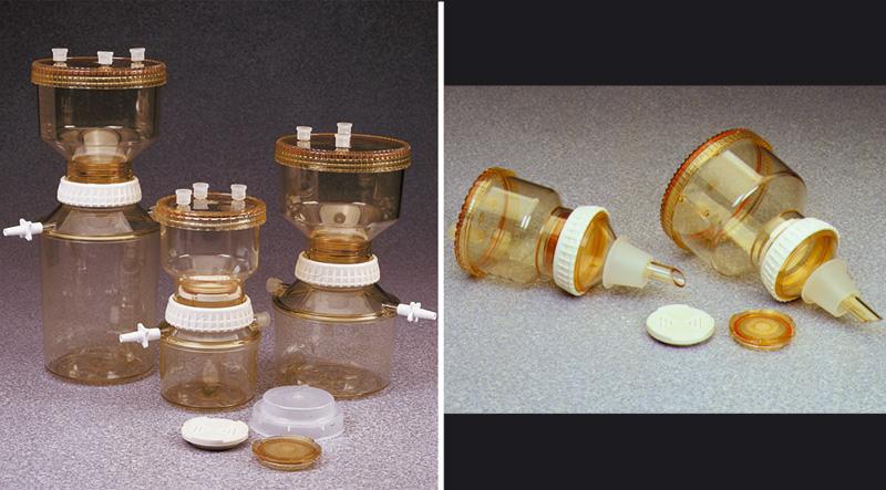

I think it's a shame they do this with the clampable funnels, because those have nifty replaceable membranes that can filter bacteria and spores, so I could use the same glass for biology if it wasn't laid out that way. The membranes can either be binned after each use and a new, sterile disc dropped it or users can dry them and determine the cell mass, or use it to inoculate plates to look at what's in water samples and whatnot.
The amber plastic is from Nalgene, so it's designed for repetitive autoclaving in biology labs, keeping oxygen away from cakes of cells and reducing the light they're exposed to.

We use those filters at work with 0.45um nylon membranes for HPLC mobile phase filtration. I suspect the joints are reversed so when you pour, your mobile phase does not contact the joint, and any potential grease/dirt it might have. In fact we've never had a stuck joint, and they're all ungreased.
I also suspect that because of the tendancy for organic solvents to boil off like ACN under strong vacuum, the cooling effect on the top portion won't affect the joint's gas-tightness as much as if it were the normal orientation (ie: the joint becomes tighter instead of looser).

It's good to see someone else knows about those membrane filters, they're funky little things hey!

Probably another reason why they use ground glass joints at all in these style flasks is to avoid any plastic, since mobile phases for RP columns can happily leach out trace contaminants such as plasticizers that you would find in neoprene stoppers/cones for filter funnel adapters.
