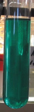

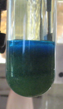

Bottom of the tube: NaCl (solid, about 11 g), top CuSO4.5H2O (solid, about 14 g, with 50 ml water poured over it all. Due to the high solubility of CuSO4.5H2O (> 30 g/100 g water) some of the CuSO4 dissolved immediately on pouring on the water, where the dissolved Cu2+ then reacts with NaCl to form the green CuCl4 (2-) complex anion. The green is so intense the white NaCl appears green!
After shaking the tube for some time:
This solution can be considered a solution of Cu2+, CuCl4 (2-), Na+ and SO4(2-).
[Edited on 9-4-2011 by blogfast25]

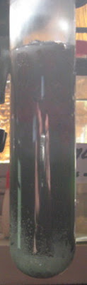

So this is the CuSO4/NaCl tube after adding some aluminium (a few of these little levers you use for opening a pop can) and standing overnight:
Top layer is greyish CuCl with a wad of elemental copper ‘hidden’ in it, then follows a green layer and at the bottom of the tube is some CuCl. Here’s the wad of copper sponge recovered and rinsed:
What took me by surprise a bit was the heat generated by the reduction of Cu2+(aq) by Al(s). Of course the cell potential ΔE for 3 Cu2+(aq) + 2 Al(s) === > 3 Cu(s) + 2 Al3+(aq) is very healthy and thus ΔG = -nFΔE is too but in this case things appeared to even start boiling, which is why the copper was found in the top bit of the tube! Of course it was a concentrated solution too (almost saturated).

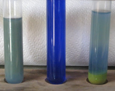

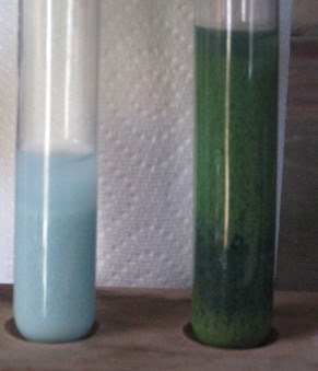

The CuCl was of course formed by Cu(s) + Cu2+(aq) + 2 Cl-(aq) === > 2 CuCl(s). The heat will have helped a lot! Here’s some of the CuCl transferred to another (smaller) test tube:
Left: the CuCl.
Right: after adding 4 M NaOH. The green precipitate is likely to be our old friend the Cu[+I]/Cu[+II] complex, due to some remaining Cu2+ (the suspension as slightly bueish).
Reaction with ammonia:
Middle: the left tube from above was decanted off, then fresh water added and then decanted again. 4 % NH3 solution was then added. The deep blue is the colour of the Cu+ ammonia complex: Cu [+I] forms the same complex as Cu2+ and it’s blue too. The weak ammonia dissolves all the CuCl!
Left: adding 4 M NaOH changes nothing for a few minutes, indicating strength of the complex. But then slowly precipitation starts…
Right: the same tube as above right, after a bit of standing what is more or less Cu2O has dropped out (CuO's colour depends on a lot of things...)
