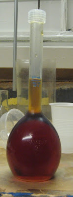

The samples were dissolved in hydrochloric acid containing calcium nitrate, about a spatula tip of calcium nitrate was used and the solution volume was 2mL. The amount of calcium nitrate should be as little as possible to fully dissolve the metal. The digestion was again hastened by heating. After digestion, the sample was allowed to cool and iodide was added. For samples which show no precipitate but still had yellow coloration, an excess of iodide was added, and the solution was boiled for a minute or two. If after boiling the solution is appreciably colorless, the test is a negative. If the solution still has distinct yellow coloration that is not significantly changed by this process, the test is a positive for lead.
(Samples being digested. From left to right: Neg. Control in Aqua regia, Pos Control in Ca(NO3)2/HCl, Pos Control in Aqua Regia, Unkown in Aqua Regia)
(Same sample order as above after digestion, the nitric acid controls have been boiled with HCl. The unknown, is showing PbCl2 precipitate and is ready for another concentration)
(concentrating down an HCl/HNO3 Sample)
(Positives: Left to Right: Pos. Control Ca(NO3)2/HCl, Pos Control aqua regia concentrated to dryness (fourth attempt), unkown aqua regia concentrated (third attempt))
(Left: HCl/Ca(NO3)2 Pos Control (5th attempt). Right: 5th attempt Neg. Control after boiling off I2)

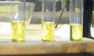

NaCl (left), K2Cr2O7 (middle) and KI (right) were then respectively added to tube 1, 2 and 3:
It's always a joy to see the typically delayed precipitation of PbCl2: in this case it was like snowing inside the tube, with crystals as long as 4 mm needles formed. With KI, no I2 was formed.
The lead nitrate solution had developed a white precipitate but clearly crystalline in nature. The clear liquid was decanted off and some 10 ml cold water added to the precipitate which dissolved quickly and completely upon shaking. That liquid was then added to the rest and divided over three test tubes.
Here the higher concentration of Pb caused the PbCl2 to drop out more quickly in a 'cheese-like' precipitate. Notice also how the iodide tube did develop some iodine: here the tube hadn't been boiled to expel HNO3.

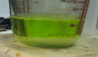

Two other, larger scale test were then carried out with the aim of synthesising some more (NH4)2SnCl6.
First a test with 3.85 g pewter and 20 ml HCl 22 %. This is the stoichio amount (+ small excess) for obtaining SnCl4 (even though in the first step only SnCl2 is formed). Dissolution on steam bath took about 20 mins but left some black insoluble residue behind. The solution was filtered and 3 g of HNO3 38 % was added: this is stoichoi + plus small excess for 3 Sn (II) + 2 HNO3 --> 3 Sn (IV) + 2 NO (not fully balanced here). That was simmered for a few minutes. No NOx was observed. Then about 3 g of solid NH4Cl was added and the solution simmered with reflux until boiling behaviour became odd. On cooling to RT (then refrigerator), typical crystalline sheets of (NH4)2SnCl6 appeared. Nice crop too!
The second test (with 5.1 g pewter) was very similar but here the HNO3 was added right from the start to the HCl. Events unfolded quite differently though.
Although this too started out fine at BP, about half way the reaction completely died, due I believe to passivation of the tin which manifests itself in a stubborn black sludge coating the metal. It was removed, the solution set aside and the metal scrubbed with sand paper and dissolved in virgin HCl (w/o HNO3). Some black residue remained. I combined the first solution with the latter and added some more HNO3 (I patently forgot to filter first!). On simmering something strange happened: all of a sudden the solution 'whooshed', threw some outside the beaker (not very much) and dissolved also the residue! On top of that, the solution was now greenish:
This was brought to the boil and solid NH4Cl was added and something strange happened again: a whitish precipitate formed. SnO2? (NH4)2SnCl6? Something else? What ever it was on adding quite a bit of HCl 22 % and heating, the precipitate dissolved completely: by then the volume was about 125 ml. That was boiled down to half way and I got my supper. On returning, in the cool solution quite few white crystals had formed. Very well formed. Except... they didn't look like any of the (NH4)2SnCl6 previously obtained. I collected the crystals on a plastic tea strainer, then washed them with cold DIW: they are essentially white. They dissolve in water and tested negative for Pb2+ (I suspected maybe Pb(NO3)2 because they look like it) but positive for behaviour of (NH4)2SnCl6: the solution sheds SnO2 on heating and also when strong alkali is added.
Finally the rest of the solution was reduced and cooled: more crystals formed...

Firstly, it's not the aluminium that does the reducing here but the hydrogen, in particular monoatomic hydrogen (hydrogen radicals, if you prefer), generated by Al + acid ---> Al3+ + H* (2 H* --> H2). This method (also with zinc or iron) is often used as a reduction agent. It reduces for instance Ti (IV)aq to Ti (III)aq. SO2? Worth looking into, IMHO...
Re copper, I'd have to look that up, I think it might be reduced to elemental copper, as antimony. But I have to look both up.
Here's what I did.
1.92 g of pewter was first attacked with 25 ml simmering HCl 22% and when that reaction showed signs of slowing down, 5 ml of HNO3 38 % were added. The reaction that followed was almost instantaneous: large eruption of NOx, remaining residue completely disappeared and a clear, lime green solution formed. This is the first time things were so straight forward with my reagents and pewter.
The solution was then quantitatively transferred to a Nalcene round calibrated 250 ml measuring flask and diluted to the mark, resulting in a stock solution of approx. 0.1 N (=0.05 M) Sn, probably mainly Sn (IV).
The titrant solution was ferric alum 0.1 N (0.1 M) but years old. Kept in the dark and well stoppered it looked in good condition with no precipitation or observable hydrolysis. Of course it would at least have to be re-standardised but here the purpose was to show a principle.
My titration station:
20.0 ml of stock solution were pipetted into a clean conical flask and 25 ml HCl 22 % and 0.6 g of Al added. The Al used is extremely low in C, BTW from similar experience (titration of Ti (IV)aq. ) After a bit of heat the reaction starts. And here's the snag: fairly small amounts of an amorphous looking black powder started to form. After all Al was digested, 3 ml of KSCN (Fe3+ indicator) were added. I decided to titrate with the precipitate present. It's clear the reaction Sn (II) + 2 Fe (III) ---> Sn (IV) + 2 Fe (II) [1] proceeds: each time you add some titrant solution, temporarily the red colour of FeSCN (2+) appears then fades quickly as the Fe (III) is reduced away.
A the start of a reduction: no black residue formed yet:
But there's a snag: endpoint determination was difficult with a slow and 'spongy' endpoint. End point was around the 20 ml area.
The second test was identical, except that I filtered the reduced solution quantitatively (it was then clear as water) and then titrated it. That improved things but endpoint was till difficult to determine, I believe because at near endpoint of [1] the reaction speed had dropped to almost nothing. Near the end, when you add another drop the solution turns, say amber red, but in minutes gets back to completely clear! A remedy would be to increase the concentration of both solutions to about 0.5 N, instead of 0.1 N.
But it's been shown that titrating Sn with Fe3+ after reducing to Sn (II) should be possible in the right conditions.

Yesterday I made 250 ml stock solution that was approx. 0.5 N in Sn (IV) and 250 ml of ferric alum ( 0.5 N, as yet not standardised) (in 0.1 M HCl) as titrant solution. This works much, much better than 0.1 N: endpoint is still a bit shaky but much easier to establish. Tomorrow the 0.5 N solution will be standardised.
250 ml of approx. 0.5 N ferric alum in 0.1 M HCl:
Finally, another 10 g pewter was dissolved into HCl/HNO3 and an excess of NH4Cl added. The solution was then gently simmered down until the first crystals appear.
After a bit of standing (solution still hot - about 50 C) and a nice crop of (still presumed (NH4)2SnCl6) crystals has already appeared (yield determination tomorrow):
I'll also try and make the potassium salt, which is likely to be even less soluble at RT and which has been used for the separation of Rb and Cs.
Finally regarding the antimony: it should be detectable as (black) Sb2S3 in not too acidic conditions by saturating with H2S.

What really remains a mystery is the green colour. Believing it might be ferrous stuff, I tested it with KSCN after adding peroxide, also hypochlorite, but no FeSCN 2+ showed up.
What is most striking is how it shows up: as explained I use HCl to dissolve most of the pewter, then add enough HNO3 to oxidise all Sn (II) to Sn (IV) and dissolve the last of the black residue that appears insoluble in HCl alone. At that point the solution is still ever so slightly turbid and looks a bit greyish. Sometimes the nitrate then leaves the party altogether with a puff of NOx and the turbidity is then instantaneously replaced with the green colour. Sometimes the turbidity just disappears over a few seconds, being replaced by the green colour.
This strongly points to something in the pewter being dissolved ate the end of the dissolution process and forming a green compound. But what?
