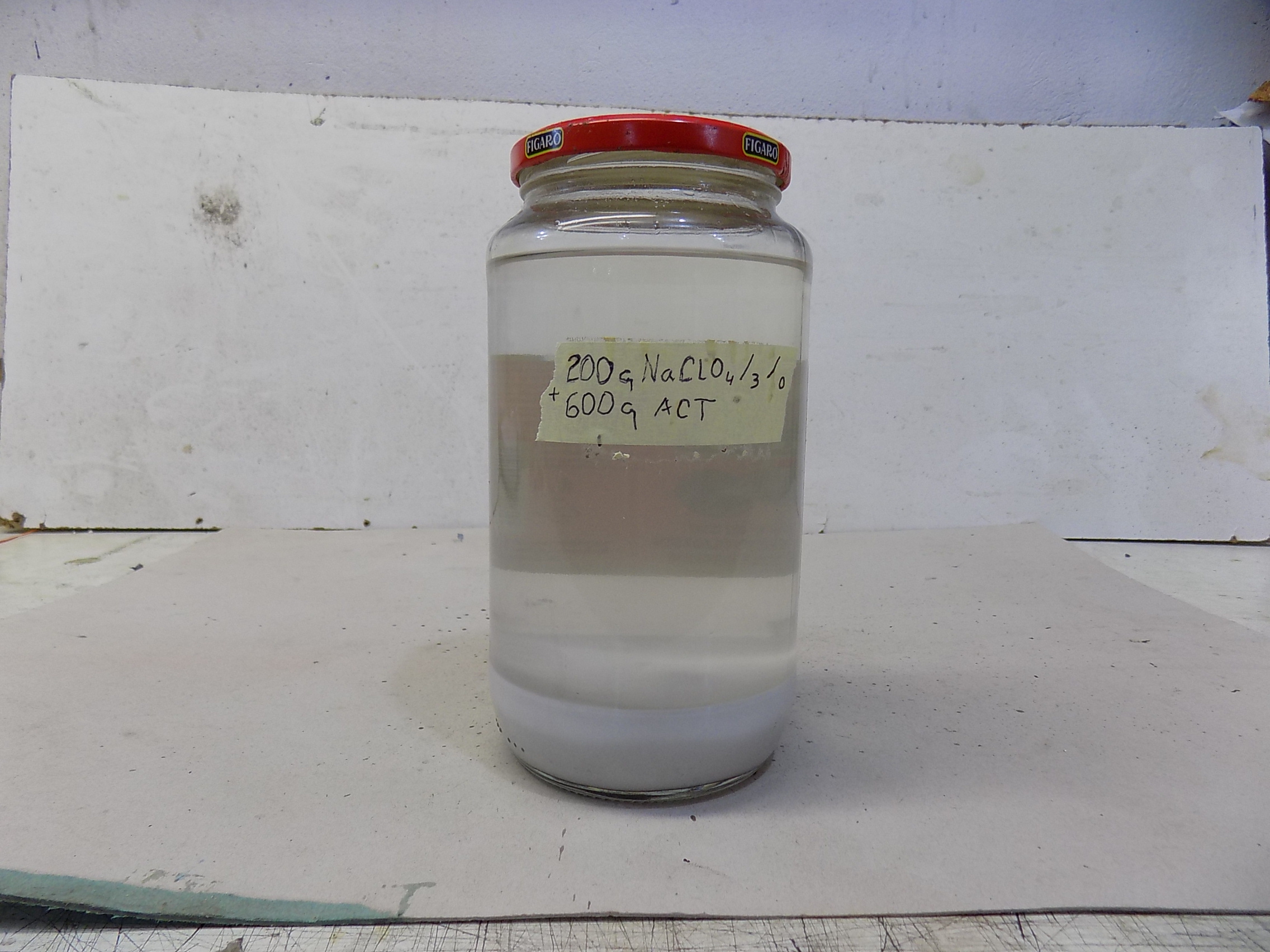

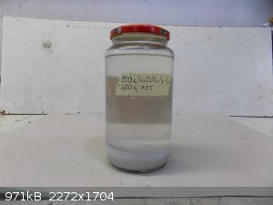

NaClO4 from NaClO3 via acetone
Markx have right. During process from NaClO3 on NaClO4 arises next compounds, which can damage Platinum surface. Next way is use PbO2, which is
resistant against NaCl in solution. Is resistant agains anythig compounds during proces. But problem can be original factory quality of this PbO2
anodes. Which go on sale around the world. Therefore I am prefer method heating NaClO3 (+ NaCl residuum) from chlorate cell, heating process on 500 C
and forming NaClO4 + NaCl (+ NaClO3 residuum). In acetone are dissolve only NaClO4. All others compounds remain as powder on the bottom of glass
jar.... ...LL
Ratios are on 100 gram of crude NaClO4 + 300g acetone. MAximal dissolving takes about 24 Hrs at 25 C.

Here is example uncomplete reaction at 500 C. In glass you an see 2 layers. Down is NaCl, up is NaClO3, in acetone is NaClO4. His solubility is 52g in
100g of acetone. Solubility others is zero grams on 100g of acetone.... ...LL

normal easy process. Water bath 90C = cooler= ice bath zero C. Tested, confirmed. Is it even without smell on output side. Thanks ice bath. Most
