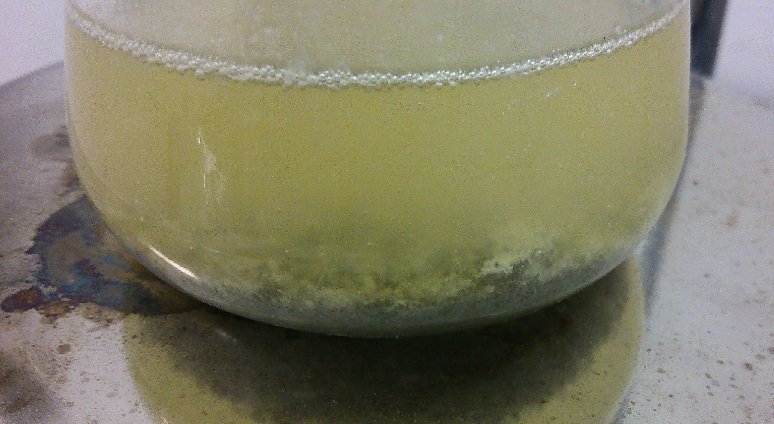

Unfortunately, last try was also unsuccessful. Probable issues are:
- KOH with a too high content of carbonates,
- insufficient power of a hotplate (possibly can't reach the required temperature range),
- insufficient cooling in my air-cooled Liebig's condenser, resulting with my catalyst (menthol) staying mostly there and not in the flask.
Soon some pics should arrive.

First attempt. Look kids, this happens when your solvent contains too much aromatics:

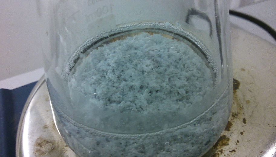

Second attempt - as we can clearly see, there are small shiny balls of molten potassium neither floating, nor merely existing in mineral oil:

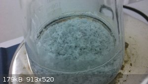

Third attempt - I got really optimistic during the "drying" step, as this time the mixture behaved differently - KOH became grey and fluffy, as gas
was evolving:
But later, when the temperature was raised and menthol added, the oil turned yellow again and no potassium formed:
(this time, however, Mg consumption was visible.)
Also, checked the hotplate - when set to 208°C, phthalic acid (m.p. 207°C) in a beaker melted, so I am reaching the desired temperatue range. Well,
the quest continues.
