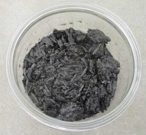

Potassium trioxalatochromate III, the very dark crystals are rather hard to photograph.

No its quite stable except perhaps over prolonged exposure to bright light. The Manganese III, iron III and cobalt III analogs are all light sensitive
which is why I decided to use the chromium analog. I simply evaporated mine down on the hotplate, slowly, over about 1.5 hours in a shallow bowl,
poured it into a small beaker and rinsed the bowl with 2ml of water. The photograph above is of these crystals with the liquid simply pour off. The
crystals are glassy, almost black and practically opaque but are completely soluble again in a little water.
I am sure you can evaporate it at room temperature and grow really nice crystals. The solid doesn't seem to be hydroscopic or deliquescent so it
should evapoarte to dryness in the end.

- The crystals looked lovely, black and glittering. They formed some hard layers in the drying dish and had to be scratched out.
Final recovery was 28.5g which is some 90% of the theoretical. Color is black with maybe a hit of green. It is easily soluble in water and a dilute
solution appears violet when light is shined through it.
