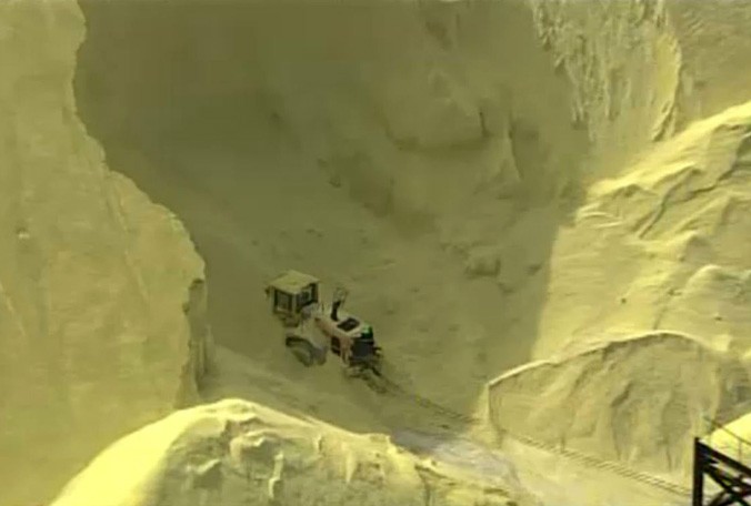

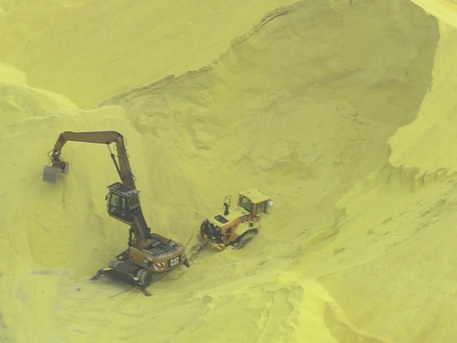

Tidbits
https://en.wikipedia.org/wiki/Sulfur#/media/File:Io_highest_...
Mountain of sulfur
https://cen.chempics.org/post/116679929484/sulfur-mountain-c...
A collapse that killed the driver, what a way to go.
http://www.sulphuric-acid.com/techmanual/Plant_Safety/Sulphu...
