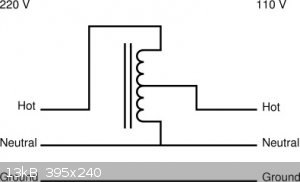

Many 240V (230V, 220V) transformers have dual primary windings,
e.g. 120 + 120 (115 +115, 110 +110)
so they can be wired as an autotransformer, https://en.wikipedia.org/wiki/Autotransformer
leaving any secondary windings unused.
autotransformer.jpg - 13kB
