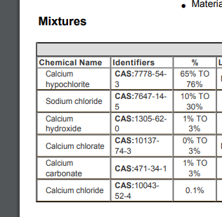

[*] posted on 14-4-2021 at 19:03
Quote: Originally posted by caterpillar
I think it would be better to start with Ca(ClO)2. At least, this compound can be obtained in the free market.
I saw it in the pool section "73% Calcium Hypochlorite"
Online I just read another brand "68% Calcium Hypochlorite, which means 67.4% free chlorine"
Means the rest is calcium and oxygen or some filler junk for more bulk?
MSDS time
All that NaCl but Ill try it.
