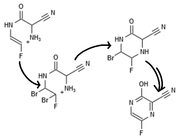

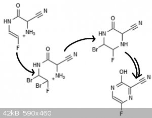

Ullmann reaction of glyoxylamide with 1-fluoro-2-iodoethylene should result in N-fluorovinylation. See:
https://pubs.acs.org/doi/10.1021/ol035355c
Reaction of this with ammonia and sodium cyanide gives the Strecker aminonitrile -- this is the Strecker amino acid synthesis. See attached picture.
Reaction of the complicated thing with Br2/NEt3 will result in addition to the alkene, Sn2 amine addition and then dehydrobromination to give
3-cyano-5-fluoro-2-pyrazinone.
Selective hydrolysis of this nitrile with H2O2 gives favipiravir.

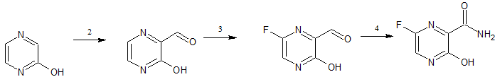

1.Synthesis of 2-hydroxypyrazine - https://pubs.acs.org/doi/10.1021/ja01126a070
https://patents.google.com/patent/US2805223A/en
2.Duff reaction on 2-hydroxypyrazine-https://en.wikipedia.org/wiki/Duff_reaction
3.P-flourination - https://www.sciencedirect.com/science/article/abs/pii/S00221...
4.Direct conversion of aldehyde to favipiravir - https://www.thieme-connect.com/products/ejournals/pdf/10.105...
EDIT - Instead of doing a duff reaction in step 2,we can do a Reimer–Tiemann reaction with CCl4 to get the acid directly.Then the last
step would be done with just NH3 and TCT (TCT might not be required if the COOH gets converted to COOF during the flourination )
[Edited on 21-3-2020 by CuReUS]

CuReUS: elemental fluorine seems a bit bold for a substrate bearing an aldehyde. Likewise for a substrate bearing an amide. Maybe form a cyclic
acetal? Of course, elemental fluorine always seems bold...

Quote: Originally posted by clearly_not_atara | CuReUS: elemental fluorine seems a bit bold for a substrate bearing an aldehyde. Likewise for a substrate bearing an amide. Maybe form a cyclic
acetal? | Are you suggesting the aldehyde would be turned into a diflouro compound ? In that case,we will be
able to hydrolyse it back during the workup and no protection would be required.
But what happens to amides when they react with flourine ?
I found some papers on the electrochemical fluorination of organic compounds
https://link.springer.com/article/10.1023/B:RUJO.0000036072....
https://pubs.rsc.org/en/content/articlelanding/2011/cc/c1cc1...
Quote: | Of course, elemental fluorine always seems bold... | Desperate times call for desperate measures
But this paper suggests some ways to tame F2 - https://www.sciencedirect.com/science/article/abs/pii/S00221...
1.Using Flourodec for generating F2
2.Diluting it with N2
3.Using strong protic solvents like H2SO4 or HCOOH
I
wonder if we could p-flourinate that using the paper I linked to get favipiravir ?

So I thought a bit more about the route I posted.
Unfortunately, glyoxylamide is not commercially available. It also might not be very stable considering the tendency of aldehydes to react with
primary amides -- an equilibrium, but glyoxylates are very reactive aldehydes. And I'm not sure that the N-vinylation conditions will tolerate
aldehydes. However, I had forgotten that they do tolerate amines.
So instead we start with ethyl glyoxylate and sodium cyanide with an excess of ammonia in ethanol. The aminonitrile forms first, and then the ester
undergoes aminolysis. This should give mostly the stable 2-cyanoglycinamide, which can then be N-fluorovinylated with 1,2-iodofluoroethylene.
In the third step I think it would be most advantageous to start with the ammonium salt in some polar solvent (that isn't easily oxidized) and add one
equivalent of bromine, which will add to the alkene, followed by base, which will close the ring. There is the question of whether we will get a
5-membered ring or a 6-membered ring; the former is typically favorable, but the angles around the amide bond are fixed at 120 degrees, which promote
the formation of the correct product. Then adding one more equivalent of bromine should take us to the pyrazine; I'm not sure if the 1-, 3- or 4-
position will react first, but either should react with one equivalent of bromine to give a product that easily eliminates to pyrazine.
Scheme attached. Of course we hope the fluorine atom doesn't eliminate as HF under the reaction conditions. I expect it to be "kinetically protected",
