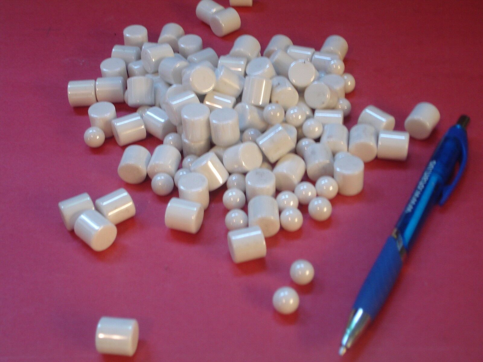

[*] posted on 16-4-2020 at 09:53
Comes in different shapes and sizes, but I like the stuff that looks like marshmallows. (yum)
tumbling media.jpg - 156kB
It'll probably take that paint off your tumbler though. porcelain's pretty tough.
Can that stuff be ground wet?
Put it through something that functions like a quern, but mechanical?
Ha Ha, I got to use quern in a sentence.
Don't do that every day.
