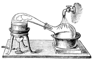

Yttrium2
Posts: 972
Registered: 7-2-2015
biggrin.gif posted on 23-4-2020 at 14:02
Using a retort, if you cool the spout with water then the water will probably drip into your product.
Why not consider a cheap ground glass joint 'distillation kit' from China via eBay etc. ?
those require running water, + I like the look of the retort/ Id like to avoid purchasing more stands. Simple is oftentimes better

You can put a cheap aquarium pump in a bucket of water to cool a condenser. If you need the condenser to be colder, add ice cubes (or plastic bags of them) to the bucket.
Distilling acetone in a retort does not seem like a good idea. Perhaps this is why alchemists are a rare breed today.:D

A retort is essentially an air condenser. Useful when you want simplified apperatus and you don't need large rates of heat transfer to achieve condensation. Also good when there is a reason to avoid water cooling.
There is a member here who routinely uses a retort for distillation of sulfuric acid. Search "boiliing the bat" for details.
I would try to avoid active cooling on the retort itself. And I would try to avoid a metal ring stand unless I could insulate it somehow. (A few strips of glass fabric to prevent the retort directly touching the metal would be good.) I am thinking the logistics of say 300°C distillations here and the fact that you want to avoid any thermal stresses as much as possible.
I agree that they look both classic and cool and that might be reason enough to purchase one. It is on my glass fetish list. But realistically, I don't need one for anything that I am doing.

Yttrium2
Posts: 972
[*] posted on 24-6-2020 at 11:30
All jokes aside, I'll probably go with what is in the depiction I posted

Yttrium2
Posts: 972
[*] posted on 24-6-2020 at 18:52
Quote: Originally posted by karlos³
Hope you're not going to distill solvents with it...
Well, not the exact depiction. I'm going to use a electric water boiler as my heat source ( I think) -- which I guess is still a bit of a fire hazard.
I'm not really sure how well my vapors will condense, I think so long as I don't heat it up too fast, it will work nicely.
Even if I were to distill flammable solvents in a retort like the one in the depiction, I am thinking that it wouldn't pose any serious problems if I did it outside.

If you intend to use a water bath to heat the contents of the retort
then the boiling point of the contents must of course be lower than the boiling point of water.
So the temperature will be not much above ambient temperature,
which, combined with the small effective cooling area, will only allow a VERY slow condensation rate.
So slow that you may give up chemistry in despair.
As a rough guide:
if I distill water using a Leibig condenser such as supplied in a cheap Chinese distillation kit,
I can condense about 6 ml per minute :(
Using a retort you should plan on much slower rates.
A retort is more suitable for higher boiling point liquids than it is for low b.p. liquids.
Even in the depiction there isn't adequate cooling surface area? That is what I plan on doing, not just using the spout of the retort to condense vapor.
Does anyone have any suggestions as to how to modify the neck of the retort so that it connects to an air cooled condenser/ longer length of tubing?
Lastly, can someone explain, (as I've heard before) - Why higher b.p. compounds condense easier at room temp than the lower b.p. compounds? -- I think I get it, but a clear explanation might do wonders.
Thanx all
