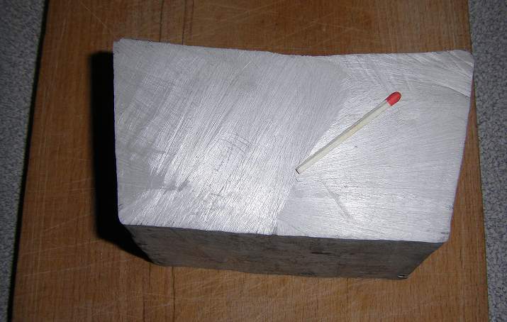

You reminded me that I have something freak : 1kg piece of cast Mg.
Price was not very big, about 25 euros/kg.......
Mg.JPG - 43kB
