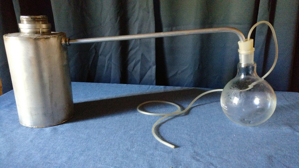

Refinery
Posts: 371
Registered: 17-2-2014
Mood: Still
[*] posted on 28-6-2020 at 23:04
Na reacts with hydrogen gas to form sodium hydride, hence probably hydroxide cannot be readily converted into metal, unless the reaction would occur below the formation temp. Na2CO3 on the other hand turns into oxides of carbon, which leave the reactor.
Na2CO3 + 2 C → 2 Na + 3 CO
1100C might be too much temp for high pressure propane burner. Theoretical temp is 1980C, but in no way even small metal object go much beyond 1000C when immersed inside the flame. On the other hand, a SS vessel placed in ceramic wool insulated oven would work if the temp is achieved to start the reaction. An exhaust tubing through the wall could be used to collect the sodium metal, because it melts at 98C so the residual heat and thermal mass will keep it flowing until it drops to collect into the receiving vessel.
I could actually look into this reaction. I should have a proper vessel around, with few fittings to be done. It doesn't work though, if I can't reach the temp. It could be done with charcoal, but I've managed to melt a couple of SS pots with it due to the heat. Possibly the reactor could be pre-heated with decent coal bath and then more heat added with propane torch.
Refinery
Posts: 371
Mood: Still
[*] posted on 3-7-2020 at 06:36
I gathered some old stuff and found this. It could be viable for above reaction.
