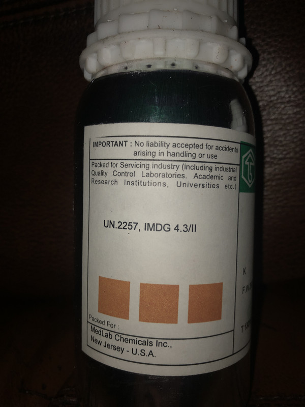

So I bought some Potassium metal a little while back and it came in this aluminum bottle with a separate stopper (looks to be LDPE) as well as a tamper evident screw-on cap. So i suppose if it is good for potassium then it should be good for sodium right (in a second bottle and not combined in the same one with the K, and submerged in mineral oil of course)?
I only ask because I know NaOH is obviously is not compatible with storage in Al so any Na2O, and consequently NaOH, on the surface of the metal would cause issues if it came in contact to bottle wall I would think; however this looked to be a professional supplier I purchased the K from and no issues have occurred with it (it was sealed very well with no doubt an inert atmosphere inside) but still I wanted some other opinions. Is it standard for Na or K to come in metal containers? Does anyone think this is a bad idea? I searched here and google but couldn't really find anything pertaining to the metal, everything was trying to warn me about NaOH + Al.

Thanks everyone for all your input. Now I am torn between glass and HDPE. Perhaps fluorinated HDPE would be better, it is quite a bit cheaper than the true fluoropolymer containers but supposedly provides a less permeable barrier than regular HDPE (interesting to note I just ordered some fluorinated gallon jugs and the recycle code still lists them and the standard number "2" HDPE, I am now wondering if they are the real deal.)
Stainless steel is probably better for long term storage as it isn't attacked by sodium hydroxide below 80C at any concentration according to literature.
Well honestly now you have me thinking that the K I received came in stainless steel instead of aluminum. Here is the K on the left and the Aluminum container I originally got for the Na on the right. Notice how much more shiny it is? That could just be a more polished finish however; I suppose I could test a small corner or something... unless any of these markings give it away that I am unaware of...

[*] posted on 19-8-2020 at 08:47
Stainless steel is considerably heavier and harder than aluminum.
The usual test for metal type is to use a metal hardness tester aka durometer.
The potassium container does look like stainless steel.
Since it was packaged in the US I doubt it is aluminum.

Some stainless steel that isn't typically magnetic can sometimes be magnetic around the stressed bends and edges of the container.
