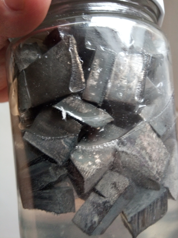

I have about 100 g of Li metal and I was wondering on some interesting ways to utilize some of it.
Of course you can always throw some into water, but that's just not as exciting as sodium or potassium. I already tried burning it, which was pretty cool. But I'm more interested in productive ways to use it.
I already have distillation of cesium metal from CsCl and Li on my list of things I would like to do, as soon as I muster the financial bravery to purchase some CsCl. I also want to try dissolving Li in anhydrous ammonia (don't know if I have anything suitable to try the birch reduction, though).
Are there any other interesting applications/reactions for Li metal that can be done in a home lab?

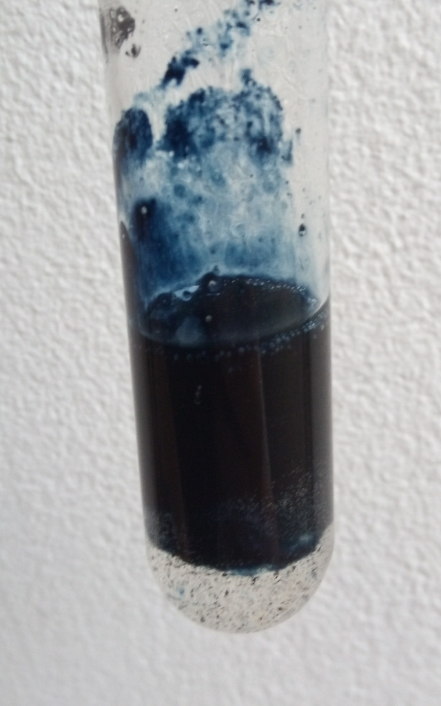

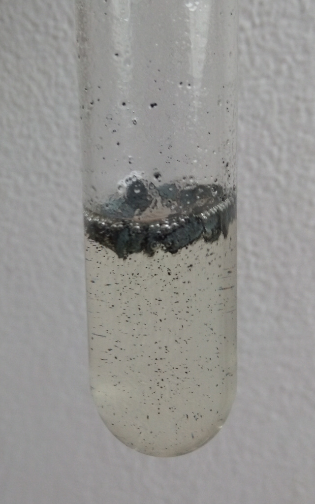

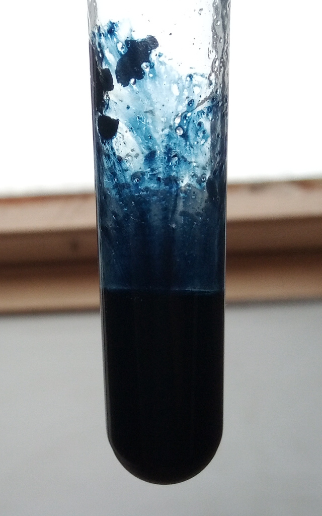

I tried the experiment of Li metal in 99% ethylenediamine.
My sample was slightly yellow, probably due to some oxidation of the ethylenediamine sample. Nonetheless, the experiment worked perfectly. I cut up the lithium into approximately 2 mm sized pieces to get a faster reaction. Below is the sequence of changes during the course of the experiment.
About 3 minutes after adding Li:
electride_1.jpg - 169kB
About 10 min after adding Li:
electride_2.jpg - 185kB
What I found most interesting was that the solvated electrons came off in "bursts" from the surface of the lithium into the ethylenediamine, rather than just slowly and gradually dissolve into it like it happens in general with colored compounds dissolving into solvents.
After 15 min of adding Li, I swirled the test tube a bit. The first few swirls of blue immediately vanished, but after the 5th or 6th, the deep blue color remained for longer:
electride_3.jpg - 156kB
After a 3 more swirls, almost the whole contents of the test tube maintained the blue color:
electride_4.jpg - 170kB
Finally, after 20 minutes the entire test tube was filled with the dark blue color. I held it up with the roof window as the background.
electride_5.jpg - 176kB
I'm satisfied with the outcome. I'm still amazed that it's possible to observe solvated electrons without using sub-zero temperatures in order to liquify ammonia. So, thanks again for sharing this experiment, Woelen. I can get solvated electrons off my list of things to do (though I still want to try the Birch reduction eventually)
