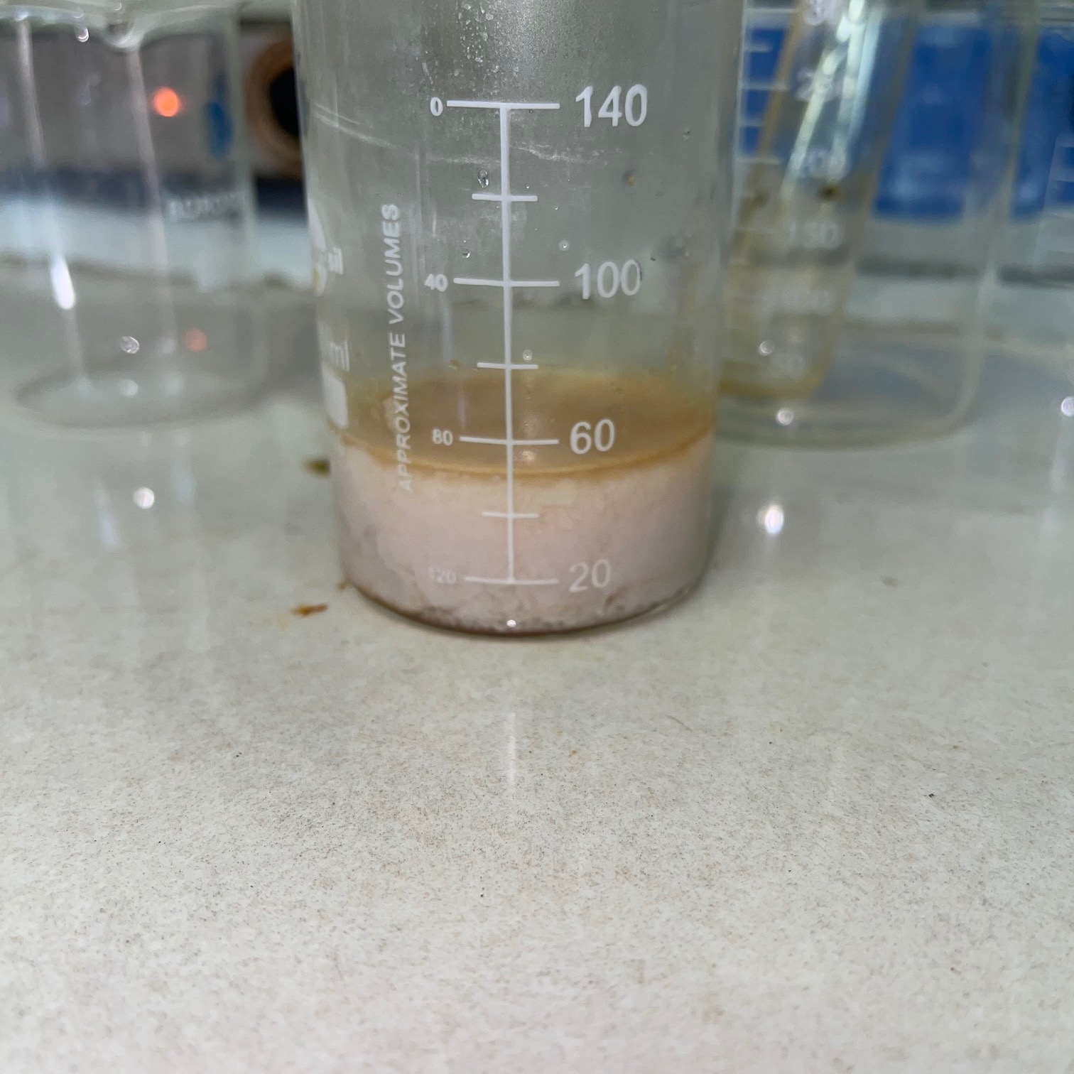

Batch test:
30g NaOH was dissolved in 100g water and 75g b-alanine was then added. This quickly dissolved complete giving a clear solution which was then made up to 200g by adding a bit more water. Assuming the product of the reaction is C3H6NO2Na then the alanine was in slight access and I should have ended up with 8g sodium-alanine in every 20g of solution.
20g portions of this solution was then mixed with solution containing about 5g of each of the below salts to see what happens and if anything produces a salt interesting enough to extract.

3) Erbium iii bromide - a pale pink jelly ppt.
3 ErBr3.jpg - 435kB
