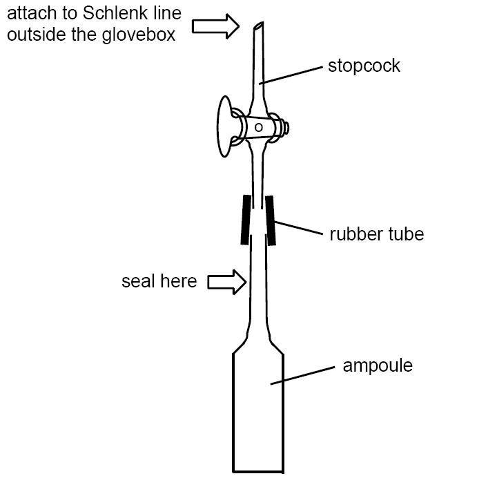

Just attach a piece of vacuum rubber tube with a stopcock to the ampoule after its filled, get it out of the glovebox and than attach it to the Schlenk line, evacuate it and than seal it with a torch.
[Edited on 10-3-2011 by matei]
untitled.JPG - 29kB
