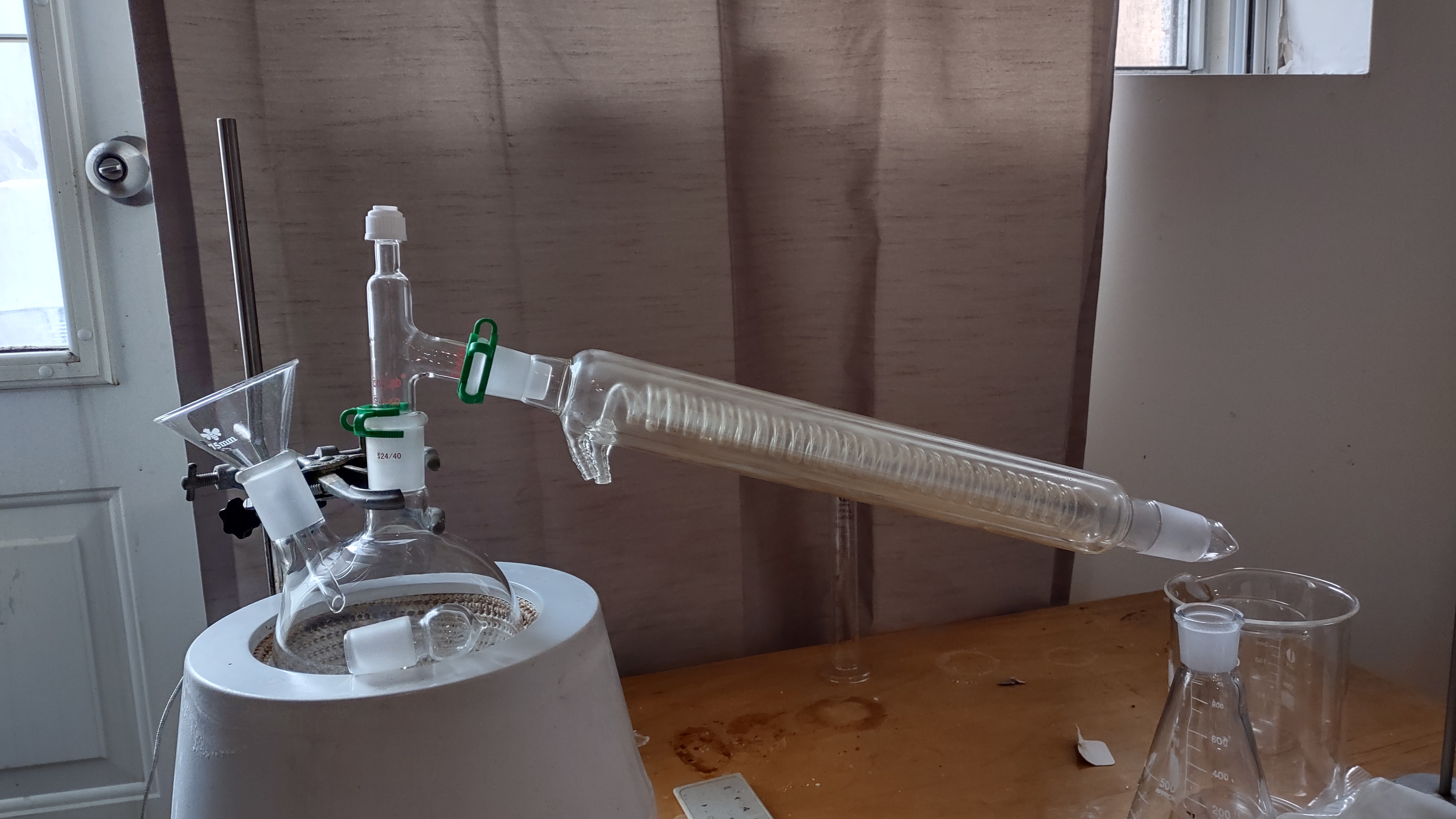

My apologies. I want to make small quantities of energetic material. Specifically NHN (Nickel-Hydrazine Nitrate), picric acid, ammonium picrate (if possible) DDNP (from picric acid), ETN, and RDX.
So I will need both fuming nitric acid and 65-70% nitric acid for these.
I made a picture of my setup so far (it needs a little improving).
Basically before I put the joints. I will put the quantity of KNO3 into the flask before putting the joint and condenser (and greasing all joints with sulfuric acid). Just when I am about to start distillation I will power the quantity required of sulfuric acid through the funnel you see and then close that with the joint plug I placed on the mantel. I will not add any further material once the distillation begins.
You mentioned to put the first 20ml back into the flask when distilling, this is what I plan on doing. At least during my first distillation.
Does nitric acid distillation produce any bucking or movement of the glassware? The setup as you see it is quite steady but I don't want anything tipping over. for very obvious reasons.
My dimroth condenser cannot have any joints added, so it needs to drip directly into a container. I have several beakers that will work just nicely.
Setup.jpg - 1.8MB

ManyInterests, you don't need to return 20 ml to the flask during the distillation. Just keep it separately, so you can use it for the second run for the fuming acid. Also, your setup is not safe enough for distilling the fuming acid. Try to use the vacuum type of receiver for that. Also clamps could be damaged, so provide some additional fix for the condenser (piece of wire?). Also, make sure the thermometer adapter doesn't contain a silicon/rubber part.

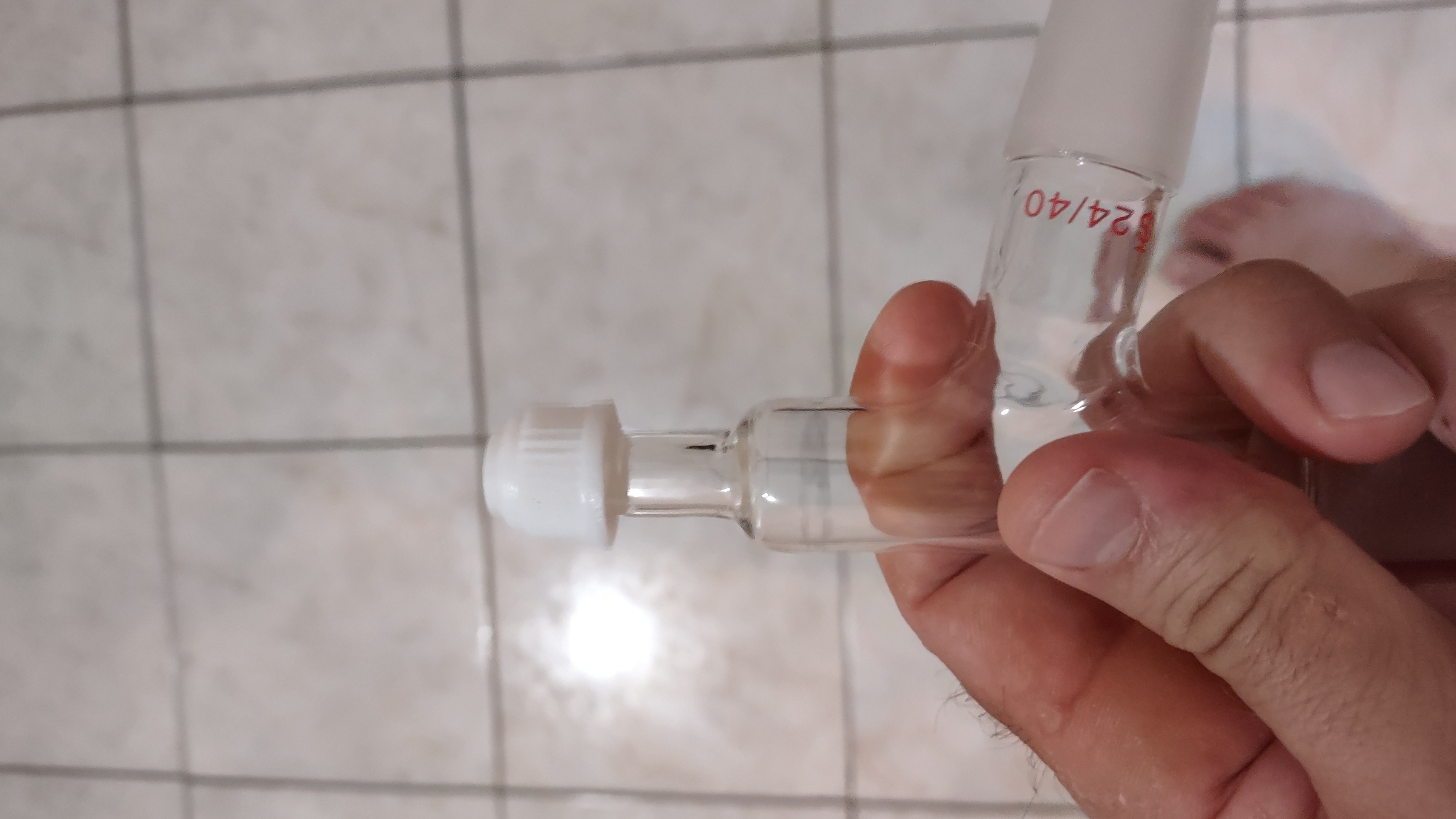

The joint at the top allows for a thermometer to be inserted, which I have and will use (as I cannot the mantle's own thermometer) It does appear to have a seal on the top. But I have seen that exact type used by people distilling nitric acid (fuming and otherwise) by NileRed, and other chemistry YouTubers. Links below:
https://youtu.be/QmCdrDLyNXQ
For NileRed While we don't see the absolute top. I don't know of any other joint that would allow for an insertion of a thermometer in any other way.
https://youtu.be/-vuLjbXh5Qc
For the Canadian Chemist. He uses the same kind of joint. I assume he has smaller glass funnels than I do, because I was not able to fit my funnel through the top joint that I have.
Put a little water or (better) sodium (bi)carbonate solution, close it and allow to stand to absorb nitric oxides. Then fill the flask with water to the top to displace all fumes. Be careful at this step. Then wash 5 times or attach a piece of hose to a tap, turn the flask upside down and put hose through one neck allowing water fountain to wash the internal surface.
You don't need any neutralization. Nitric acid is liquid so it just evaporates. If the glass is dry there is no acid.
That's good! Because that's how I also cleaned my glass after sulfuric acid purification. Also my glassware after making nitrocellulose (mixing KNO3 with sulfuric acid to make a nitrating mixture). I always have plenty of sodium carbonate because of how cheap and easy it is to make.
Joint1.jpg - 1.6MBJoint2.jpg - 1.7MB

Just add the chilled acid after your nitrate, put everything in place, clamp the condenser aswell than all you have to do is adjust the temperature and add Al foil to prevent heat loss and protect from light. Using this funnel makes it unnecessarily complicated. Put a stopper instead and make sure it doesnt leak.
Your condenser is less than ideal for the task. Actually, it's probably the worst one. Get an adaptor to let the acid in a flask immersed in ice / salt. Your lungs will thank you.
Do this outside or at least on the ledge of the window because I'm pretty sure you'd gas yourself with that setup no matter how experienced your are.
Making nitric acid takes a lot of time even with a good setup. Making *quality* nitric acid takes even longer.
The one thing that is certain is that the bong condenser will be absolutely clean.

I have another Allihn condenser (bulb condenser) that I can fit another adapter to. If that is your recommendation I will do so. This is because I have no adapter for the other condenser.

An Alhin condenser would be a much better choice. Not "the best" but sill way better than the current one.

An Alhin condenser would be a much better choice. Not "the best" but still way better than the current one.
And what is "the best" in your opinion? I personally used Dimroth condenser for many distillations (including WFNA) and didn't see why it could be not "the best". It would be interesting to know what I missed.
Also, as a receiver, it is convenient to use 2 necks flask.
I wouldn't use sand in any cleaning routing personally, I think it can scratch glass and I don't like scratched glassware, but this is a matter of preference.
Yeah, I don't know what 'the best' would be. Every chemistry YouTuber who made Fuming HNO3 or 68% HNO3 had far more basic setups than that. Just a simple liebig condenser with cold water flowing through for cooling. From the flask to the Alhin consenser I have the thermometer attachment joint, and on the other end I will have a vacuum joint. The vacuum part is optional, but even without the pump attached it makes a very firm seal with the receiving flask.
The only thing I need to do is raise the mantle on a platform, because the receiving flask will not fit.

I just have the impression that the Dimroth condenser is more effective than Liebig. I had some issues only with diethyl ether distillation, for anything else it works pretty well. The completeness of condensation in Dimroth is more visible than in Liebig - you can see where is the end of the condensation area inside the condenser - some part of the spiral will be covered by drops and after that it is clear, so you see how complete the condensation is. With diethyl ether you see the drops covered the full length of the spiral - that's a signal that some ether escapes condensation.

A Graham maybe but a Dimroth ? I'd use a Liebig for the task at hand.

Dimroths are far superior compared to liebigs. If you want a good combo, use dimroths as condensers and put a graham after it as a cooler unit. Better yet, use two coolant reservoirs, normal one for dimroth and a cryo-coolant (either salt-ice or CaCl2 solution) for graham.
I used this kind if setup when I dehydrated reactions under vacuum. The water goes freely through any single stage condenser setup, no matter how cold coolant you use. I first used a dimroth as a condenser with snow-ice water(winter time), then a graham as a cooler unit with separate, but same composition coolant to bring the condensate as cold as possible. The 3-neck receiver flask was also immersed in a bucket of ice water. Finally, the vacuum outlet was put on top of a liebig condenser, with the graham circuit, so any residual vapors would face as much resistance as possible, and finally the pump had a -30C CaCl2 solution coldfinger. I managed to keep the oil clear over multiple hours of distillation.

That doesn't look like a Dimroth in that picture.
It looks like a coil and tube condenser, which has both the outer jacket of a Liebig and the inner coil of a coil condenser.
These are very efficient, and expensive, condensers, and they have a very high internal surface area to volume ratio.
This one is unusual in that the coolant is entirely fed through the inner coil and then goes through the outer jacket.
Most coil and tube types I've seen are built with an internal nozzle which directs some of the coolant through the coil while the rest runs through the jacket.
Why can't you put joints on it?
Does that drip extension on the end foul the joints?
Some coil and tube condensers are designed specifically to be used vertically with the output going right into a flask.
Not sure why this is but I've got an old one with an integral drip tip that can only be used vertically because otherwise it would trap lots of distillate in the condenser.
Mine has an internal drip tip that would be tough to remove cleanly, but that external tip on yours could be cut or ground off some day if you've got a Dremel tool. A little work with wet sanding paper will smooth it out.
EDIT: Maybe I missed it and somebody already mentioned this, but in addition to an adaptor between the condenser and collection flask you can add a hose (not rubber, some more inert plastic) on the vacuum take-off for the adaptor and run it into a gas trap to absorb those toxic gasses. Or a scrubber.
There shouldn't be any smell getting out during the distillation, except possibly a very slight one.
Learning to set up your apparatus for proper safety is vital.
Get those vapors under control before they blow into your neighbor's apartment and the emergency services get called.
I'd be a bit nervous. Two things--stands and clamps to hold the glass (shit happens, and an elbow in the wrong place mid run would be disastrous, and a vacuum take off with a hose venting ELSEWHERE or into sat NaOH solution along with a joint ware receiver. Nitric Acid is no joke and neither are those lovely NO2 fumes.
