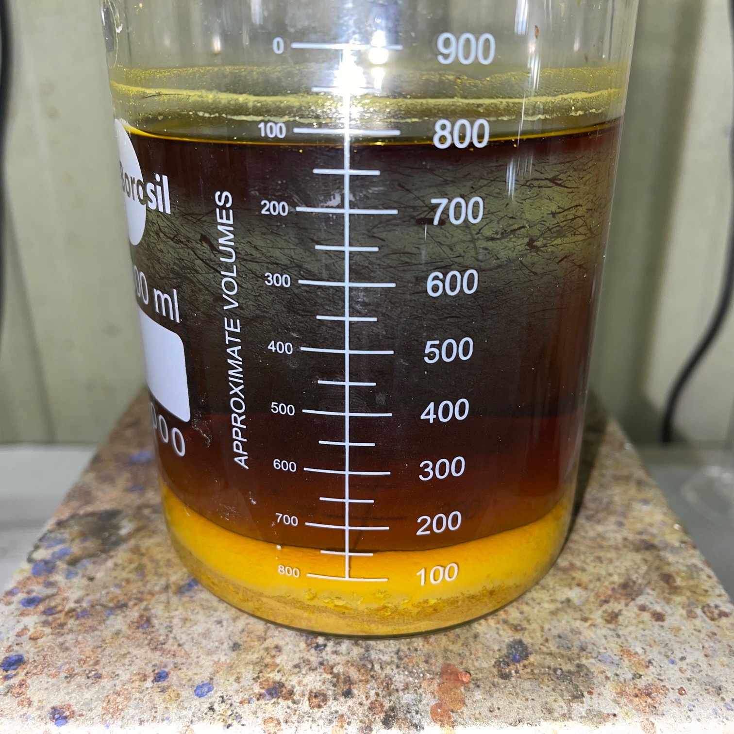

I then started adding sodium hydroxide in 10g portions to the filtrate while stirring. Upon the very first addition some dark solids appeared that did not re-dissolve in the predominantly HCl solution; I did not expect this. I kept adding NaOH. After adding 95g NaOH, a light brown suspension appeared but the pH was still under 2. By 125g added the pH was 5, and at 129 added it was 8, and this was where I stopped. At this point there was a lot of suspension and the beaker was left overnight to settle.
10.jpg - 637kB
The next morning the clear supernatant liquid was poured off, and the rest put through a vacuum filter. What a pain to filter out....very slow! Intially the filtrate was very pale brown as some of the fine material seemed to pass through the filter paper but once there was a layer of remainder the filtrate was clear. The remainder was washed once with water.
