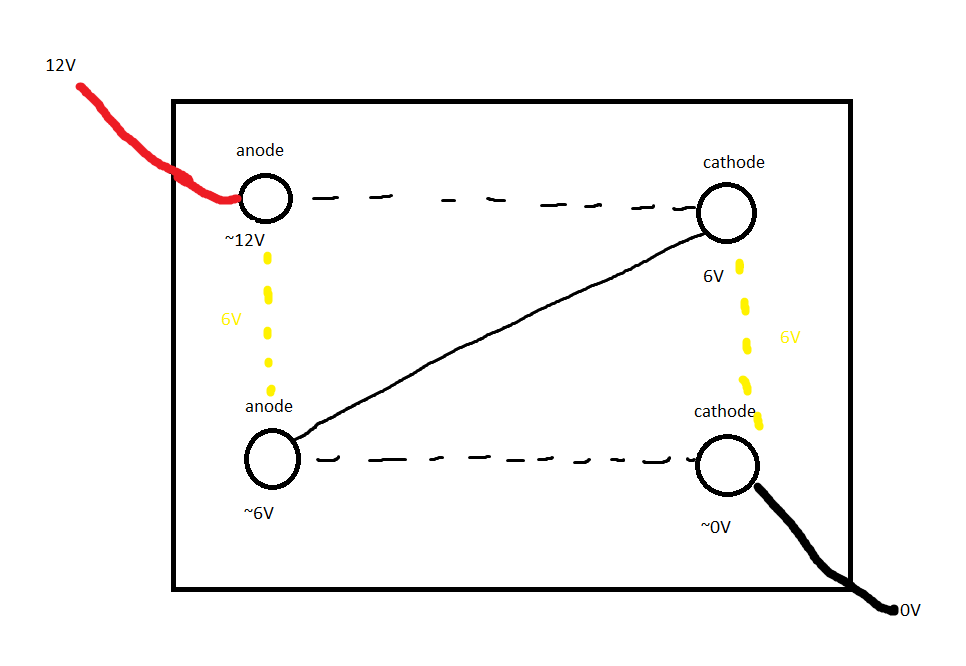

I have 2 server PSUs capable of putting out 70 amps @ 12V sitting at the bottom of my drawer. I'm worried of using my lab psu anymore because the chlorine will probably shorten it's lifespan considerably, and ig I have better things to do with it.
I'm using graphite electrodes so my biggest concern so far is the anode disintegrating at such high voltage if I were to run the default configuration.
The only other solution I considered was using some resistors/zener diodes to drop the voltage to something lower but it would have to dump a shitload of heat into these components so they'd need to be rated for high power (thus expensive).
What I recently came up with was to try running multiple electrodes in series.
This has a few problems as per the diagram below. Assuming equal voltage drop, there would be
an approx 6V difference between each of the anodes and cathodes, I'm not aware if that would be a problem,
maybe the cathode that acts as both cathode and anode would passivate or something. I let go of the idea.
ecell_series.png - 19kB
This brings us to the best one so far
What I think could work better is to have 3 completely separate cells that are to be run in series,
mitigating the issue of unintended use of cathode as anode and vice versa.
It would equate to roughly (12/3 so ~4V) potential difference which I hope would make the anodes last longer while
still utilizing the PSU to it's fullest.
Any comments appreciated :)
unionised
Posts: 4931
[*] posted on 28-11-2021 at 06:55
You (pretty much) need two containers for two cells in series.
In your diagram, there's nothing (as far as I can see) to stop the electricity just running from one corner to the other and ignoring the other two electrodes.
More cells in series is a better way to use the power from your supply. Less gets wasted as heat.
Even 6 cells (as you get in a car battery) would be workable with some reactions.
zerodan
Posts: 27
Registered: 4-4-2019
[*] posted on 28-11-2021 at 07:48
oh you're right :D. This was a quick sketch just to show the concept and I didn't think this through.
Although I wouldn't completely abandon the idea of single cell in series, you could make a linear electrode array so
(12V -wire-> A1 -sol-> C1 -wire-> A2 -sol-> C2 -wire-> GND)
Here we'd have potential difference between
A1 to C1 = ~6V
C1 to A2 = ~0V
A2 to C2 = ~6V
A1 to C2 = ~12V
but the distance from A1 to C2 would be twice the distance to C1.
Resistance of solution being proportional to distance you'd maybe get same amount of current flow between A1->C1 and A1->C2.
I reconsidered this case just for fun, poke some holes in it if you can. (the obvious problem is C1 acting as an anode for C2)

Just put some cells in series. Two or three.
You can use one cell and have what is called bipolar electrodes. One side of the electrode is the cathode the other side the anode.
Will work with flat plate type electrodes. Used for plate electrodes in industry with mmo one side (the andoe) and bare titanium the other side.

You will have some issues in this set up that will require some thought.
I don't think you mention what you intend to use your electrolysis cell for?
Not that you will get 70 A through your cell/s, but if you get anywhere near that you will need very substantial carbon anodes.
If you are running cells in series the voltage drop over the cells will vary depending on resistance within the cells, you may end up with one cell seeing most of the voltage drop.
If you are running close to 70 A you will need serious cabling and joints, if everything is wired in series each component will see the maximum current and will need to be treated for it.
If your power supply is not short protected you will need to wire in an appropriate fuse.
A local metal fabricator may be able to assist with your cathode/s.

zerodan
Posts: 27
[*] posted on 28-11-2021 at 15:22
Never tried copper as cathode, could it work for chlorates?
It's never going to run at 70A, realistically it's going to run between 40-50A. A nice safety margin and more reliable runtime.
I'm buying 6mm gouging rods for welding, should be good enough for anodes.
Also eyed a neat SiF insulated 13awg cable for 0.6USD a meter.
I like them because they don't have the memory effect and I hope the fluoride bond is strong enough to resist any damage from stray chlorine gas.
I know, the idea is to run 3 completely mirrored cells so they don't deviate too much in resistance. Same electrolyte, always ran together, etc.
It's a server power supply, it does way more than that. (It took me 6 months to figure out how to properly turn it on :P)
No such thing, I'm afraid. Best I can do is a bunch of steel wholesalers but that doesn't help me one bit.
I can buy steel mesh at the hardware store (although galvanized, would be nice to know if it would be a problem or I could easily remove the zinc only).

2. pH control lowers the operating potential by a lot run at 60C or higher with Ca/Mg chloride buffer for pH control to be viable and not a Cl2 gas generator.
3. run saturated NaCl
4. electrode spacing 2.5cm or lower
5. 2 cathodes for 1 anode, 3 cathodes for 2 anodes ...
