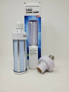

UVC
I bought a 60-watt UVC LED "corn-cob" styled bulb in the early days of COVID.
This to kill any COVID on surfaces. Whether or not this was effective is unknown
to me because less than a minute after turning the bulb on something smelled like
it was burning. Fortunately I wasn't in the room and the bulb came with a fixture
with a remote control to allow me to operate without exposure. The reflection
from the room was intensely violet-white light. Nothing like I'd ever seen with a
black lamp. I haven't used this thing since.
SMD-UVC-CORN-BULB-60W.jpg - 8kB
[Edited on 2022/2/12 by MadHatter]

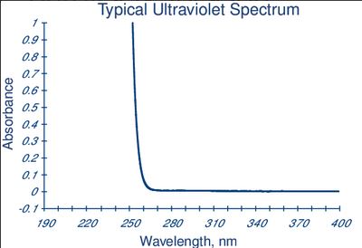

Let's pick ethyl acetate as an example, because the data is easy to find.
Here's the UV spectrum (from here)
https://us.vwr.com/store/product/4542490/ethyl-acetate-99-9-...
Et Ac UV.JPG - 22kB
There's no absorption of light above 270 nM
So there's no possible effect of UV / visible light above 270nM because the light just goes through.
And there are not many convenient UV sources in the region where the stuff absorbs- the obvious option is a low pressure Hg lamp emitting lots of 254 nM UV. (The 181 nM emission is blocked by the oxygen in the air so it's a red herring for photolysis)

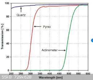

And here's the transmission spectrum of Pyrex glass.
Pyrex UV.JPG - 55kB
Showing that there is no transmission below about 280nM
So no light that is long enough wavelength to go through glass is short enough to be absorbed by an acetate.
You can do the same thing with ammonium compounds , starches etc.
Unless you are working with compounds with a good chromophore, you can't do photochemistry in glass containers.

[*] posted on 12-2-2022 at 08:43
That LED corn cob looks like it has about 360 LEDs, if they are UVC LEDs I would expect it cost more than £100. UVC LEDs are expensive compared to longer wavelength LEDs.

Take a look atbTiO2 photocatalyst and other compounds like that, you may not be able to do photolysis, but, you can still do come pretty interesting photochemistry , true, not everything you shine UV(A, B or C) will change, but that is what catalysts are for. I myself did some with chlorine(no catalysts needed there) but I plan to play with plenty other things, copper compounds, ethanol, some oxides.... but whatever the case, I think that Titanium dioxide would be a nice start, cheap, easily available, non toxic , non poisonous... I have a bag myself, tried some stuff in the past, not greate results... try different temperatures as well, you may get different levels of photoactivity.
