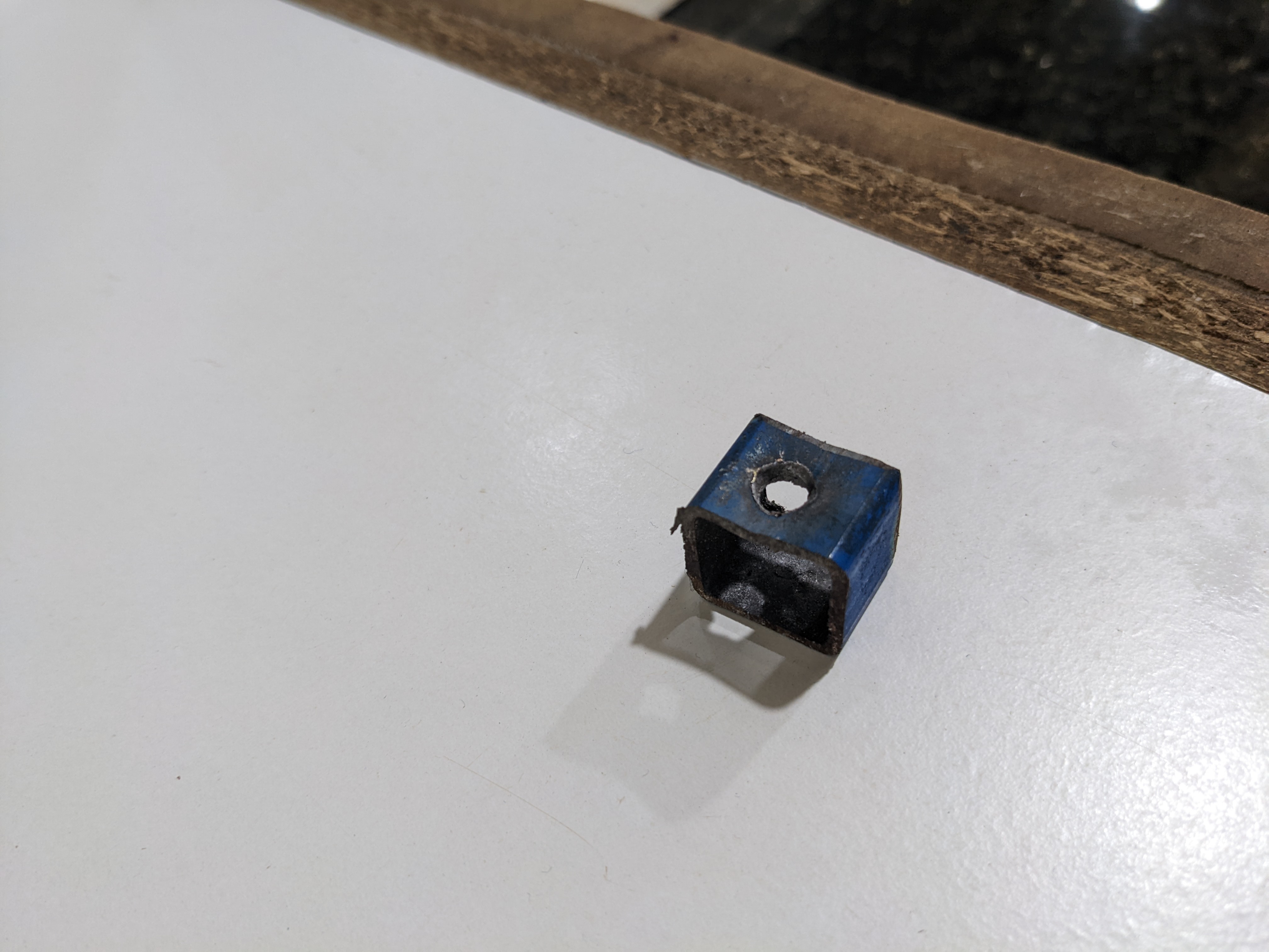

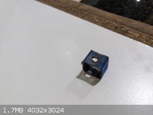

[*] posted on 9-3-2022 at 20:32

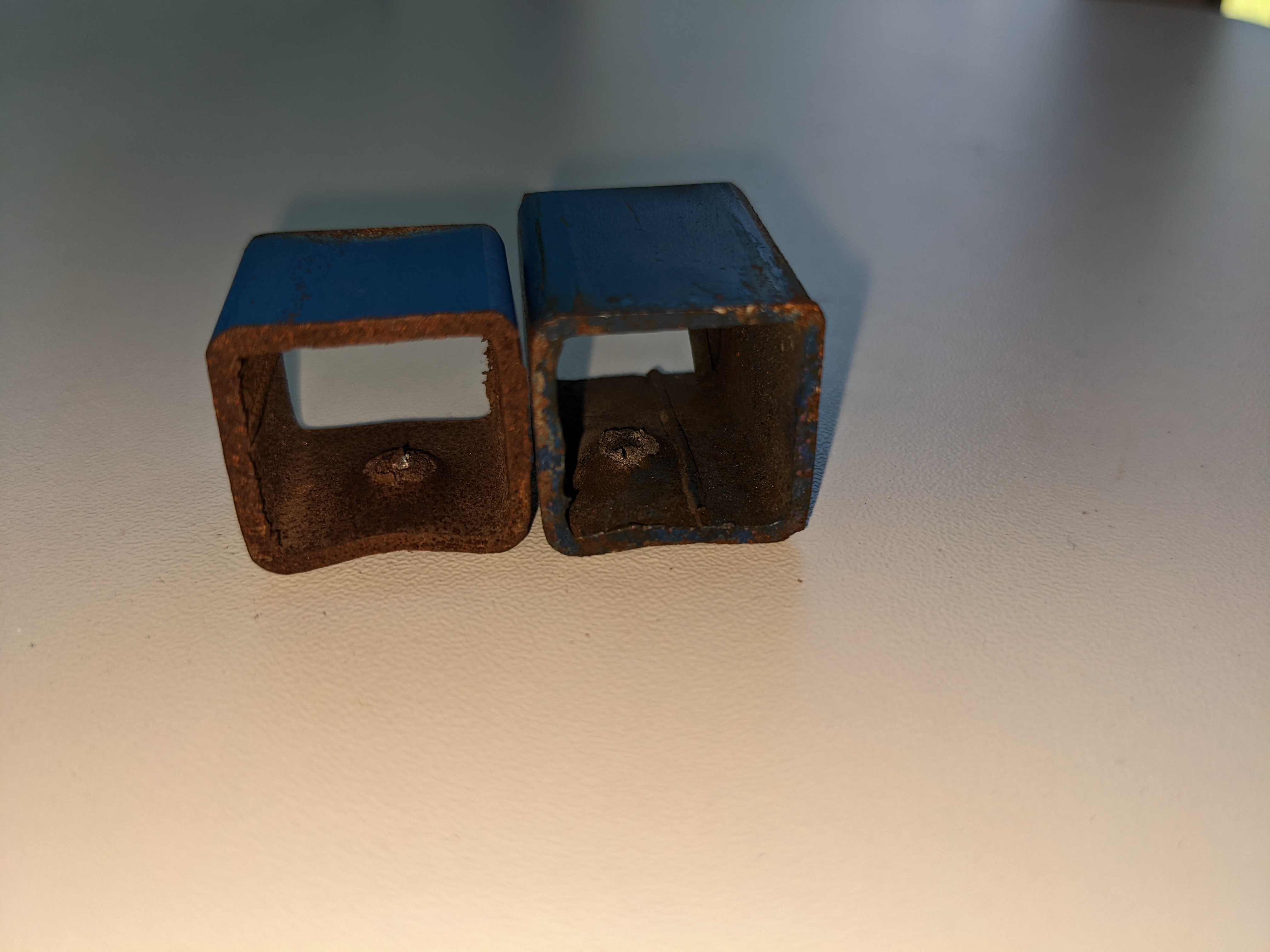

So the rain has finally eased allowing some further testing of this product.
I don't have the means to accurately assess friction, though I have not been able to set it off using friction.
I have a crude impact tester with a 2 kg weight and the material was set off reliably from a drop height of 5 cm. For comparative purposes I get 3 cm for mercury fulminate.
400 mg was loaded into a brass cavity 4.5 mm ID with 0.5 mm walls at 1.23 g/cm3.
Fuse was inserted and packed in place with NC.
The target was 30 mm mild steel RHS with 1.5 mm walls.
The results can be seen in the attached.
I was hoping to get full penetration. I was also a bit disappointed with the density that I could achieve. More to come when I can improve the density.
PXL_20220310_035221428.jpg - 1.5MB
PXL_20220310_035155594.jpg - 1.8MB
Edit - corrected an error in the cavity dimensions.
[Edited on 10-3-2022 by B(a)P]

B(a)P
Posts: 830
Registered: 29-9-2019
Mood: Confined
[*] posted on 10-3-2022 at 13:53
400mg in cavity inner diameter 0,45 mm ....? Wall 0,05 mm...?...
It is diameter syringe needle....:D...?
Ha ha ha, good catch. If I got that performance out of that diameter I would have been very happy. The correct dimensions are 4.5 mm ID and 0.5 mm walls.
Laboratory of Liptakov
Posts: 1077
Registered: 2-9-2014
Mood: cool.gif
[*] posted on 11-3-2022 at 07:20
Brass wall 0,5 mm and ID 4,5 mm is good result for examined compound. Into 1,5mm steel. Basic ratio between ID and thickness of steel is 3:1.
It is base for measurement. Similarly as ID 6 mm (examined compound) and 2 mm steel target. Also 3:1....:cool:

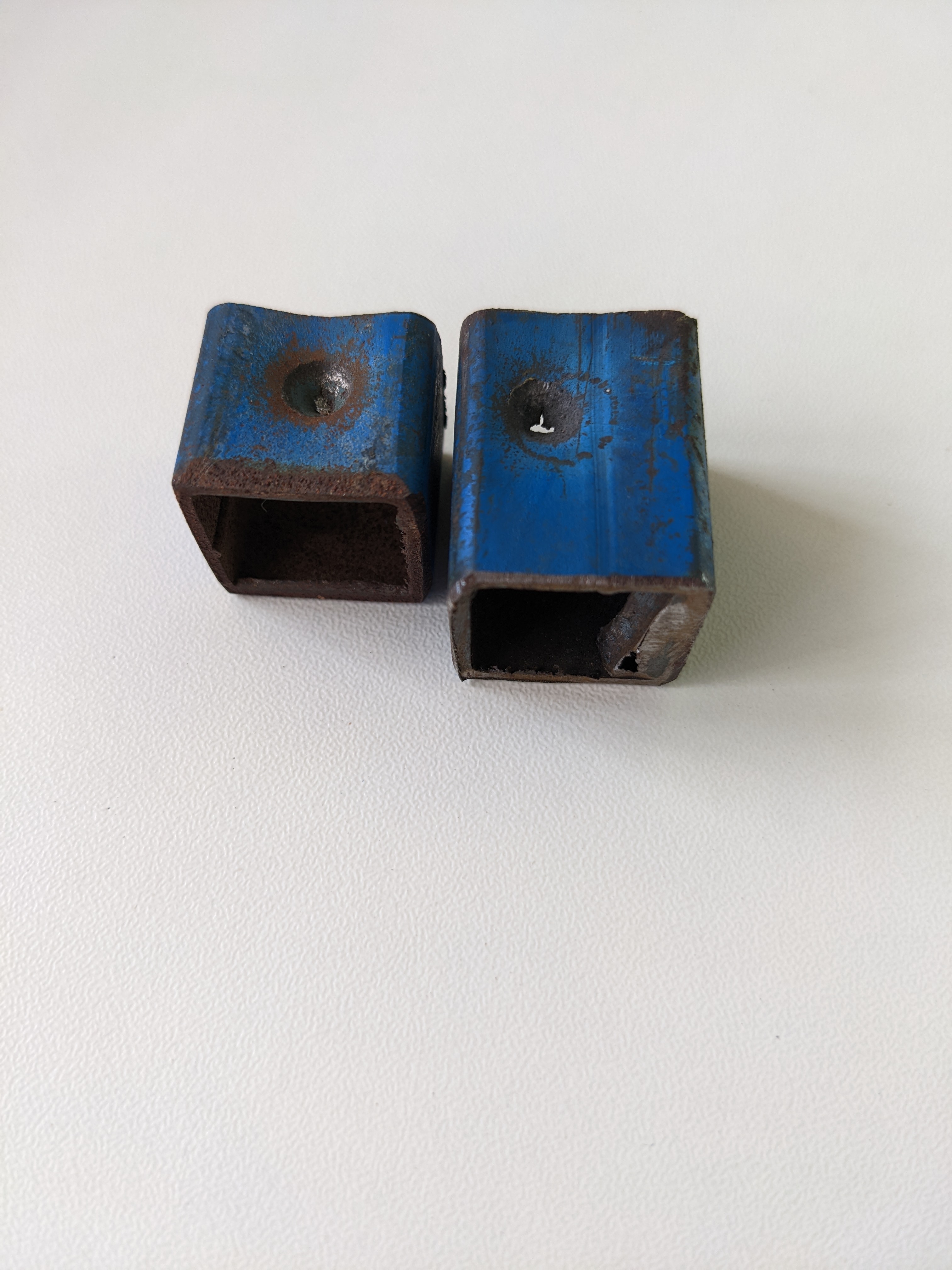

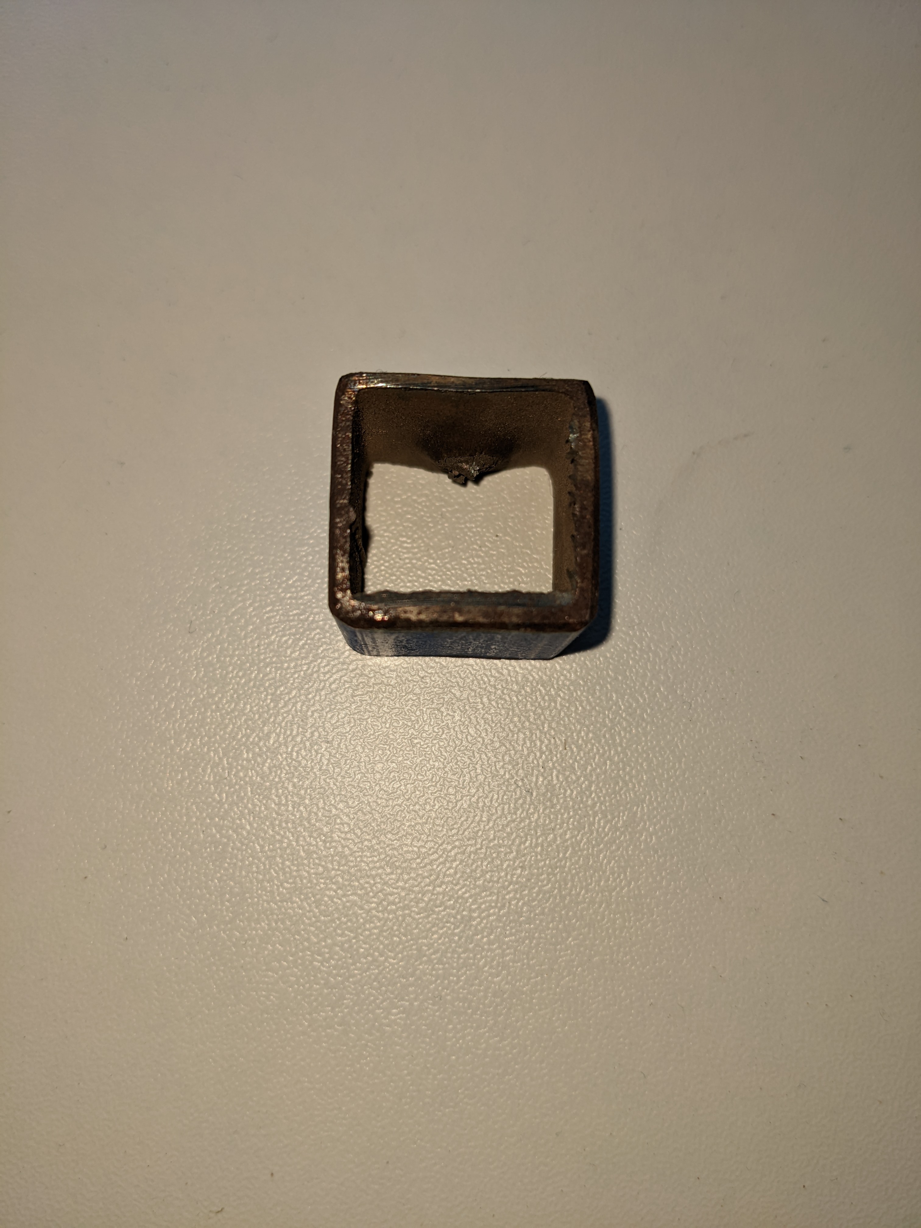

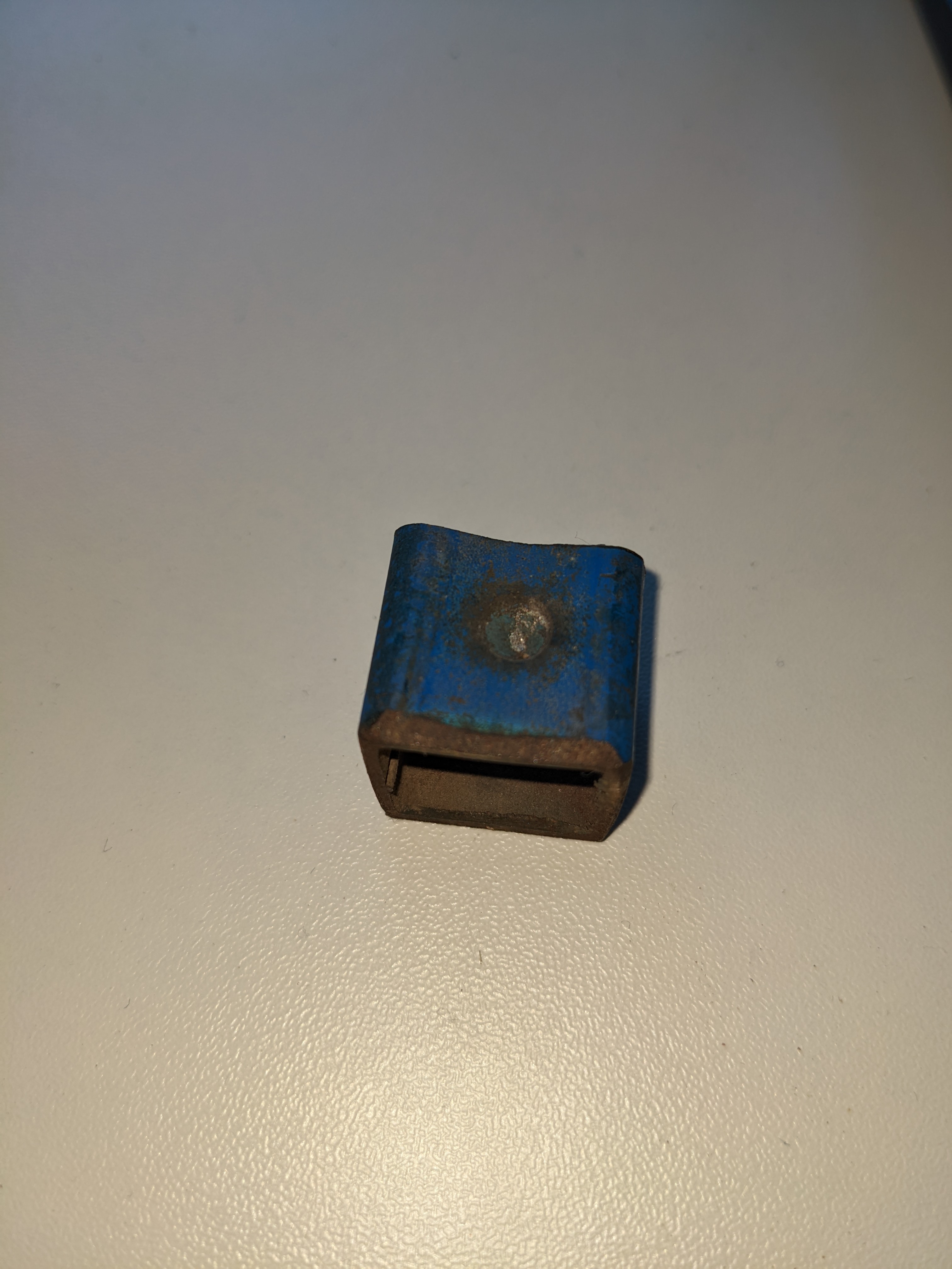

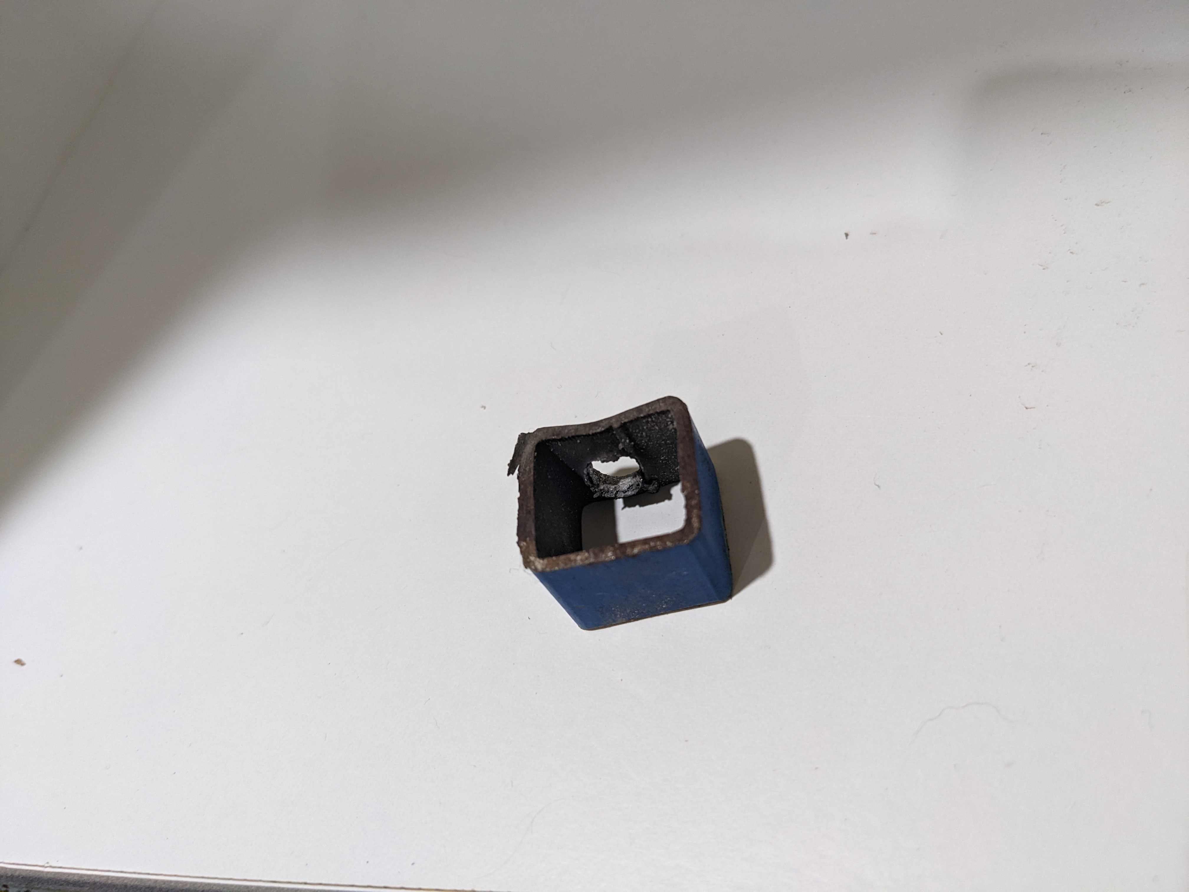

[*] posted on 21-3-2022 at 16:00
This was tried again with a finer crystal size.
The same cavity dimensions, loading weight and target material were used. This time the achieved loaded density was 1.62 g/cm3. Not a lot of difference was observed in the outcome. The smaller piece on the left is loaded at 1.23 g/cm3 (previous attempt) and on the right 1.62 g/cm3. The higher density cap seemed to have slightly more penetration, though more was expected. Without some replications this can not be seen as significantly different.
PXL_20220321_233259988.jpg - 1.7MBPXL_20220321_233332879.jpg - 1.6MB

B(a)P
Posts: 830
Mood: Confined
[*] posted on 22-3-2022 at 01:19
You should be able to get a density of 1.8-1.9.
I pressed the nickel aminoguanidine diperchlorate to approximately 50 MPa, which is about as far as I can go with my setup. What pressure would you need to achieve that kind of density?
Obviously this depends on crystal size. I tried continuous stirring to reduce size. The only other thing I can think of is to increase the reaction temperature more rapidly, then cool rapidly to make the crystals form faster.

I have my press guard reconfigured and now it is working perfectly. I repeated the above test, but this time managed to press to 2.01 g/cm3. Here is the result.
On a side note I have also been trying the lithium equivalent, but with no success thus far. I will report back if I manage to create anything of interest.
PXL_20220520_211807404.jpg - 1.7MB PXL_20220520_211857460.jpg - 1.8MB

Good work, wall is 2 mm ? Inner diameter cavity 6 mm ?. If yes, it it good result.....:cool:

The target had 1.5 mm walls and the cavity is 4.5 mm ID. I note that in this instance I inadvertantly placed the detonator over the join in the RHS. In previous tests i had avoided the join.

[*] posted on 31-5-2022 at 22:02
It are basically same ratios. Good results. Only the variable value according to the law of proportions comes into play. When the strength (behavior) of a material varies significantly according to size. This is given by the final size of the atom and molecule...:cool:
