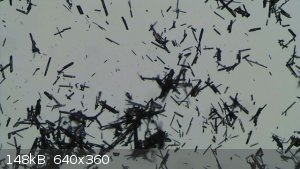

pdb
Posts: 99
Registered: 8-4-2004
[*] posted on 28-11-2024 at 02:35
This time, the precipitation of uNAP took only 5-6 minutes with ultrasound. After filtration, I observed something I’ve noticed before: if the washing with water is prolonged too much, the precipitate develops a gray film within a few minutes. I suppose this is the decomposition by water mentioned by others? I don't have any IPA on hand; I need to get some.
contaminated uNAP.png - 557kB
[Edited on 28-11-24 by pdb]
Hey Buddy
Posts: 442
Registered: 3-11-2020
Location: Bushwhacker Country
[*] posted on 28-11-2024 at 07:52
Yes

@Hey Buddy: the initial difficulties came from the fact that NiCO3 is not common in my country, whereas NiO is readily available. So, I ordered oxide, and while waiting for delivery, I conducted tests using impure NiCO3 because the synthesis from Ni(NO3)2 and NaHCO3 apparently produces a mixture with hydroxide and basic carbonate. I also wanted to use NH4OH, as others in this thread have done, instead of HClO4.
From now on, I use the cold method with NiO, HClO4, and NaOH to neutralize the acid and induce precipitation under ultrasound. The yield is around 55%.
The product obtained, which seems to have the characteristics of the uNAP described by other members (first pic -length of pic is about1.5 mm), does not exhibit DDT for quantities of at least up to 5 mg. This is demonstrated in the attached video.
10 mg are weighed on aluminum foil (with a 5 g tare for better balance precision). Then, the material is divided into 3 charges by hand and eye estimation: each pile should weigh between 2.5 and 3.5 mg. They are then ignited one by one. The photo shows that after unfolding, the aluminum foil is not pierced anywhere.
The last sequence in the video shows the same test with a DPNA charge, estimated to be between 0.5 and 1 mg.
I don’t see an explanation for the absence of DDT. In your video, do you get the same effect with direct flame contact?
uNAP-1 .jpg - 148kB PXL_20241207_160600272 .jpg - 118kB PXL_20241207_161304535 .jpg - 109kB PXL_20241207_161447947 .jpg - 133kB
PXL_20241207_162537130 .jpg - 129kB
It is common for primary explosives to not detonate from open top heat. I think bottom heating is a higher resolution examination of a material in minimum mass DDT capability. Closer to as it would be when confined in a device during actual use. There are tetrazoles that wont detonate on open top heat. Bottom heating reveals the minimum mass necessary to cause a detonation transition. Some materials are incapable of detonating by bottom heat in low mass, and so it is a useful comparison. The Al foil is useful as a witness medium because it is resilient to perforation unless a detonation takes place at such small mass.

[*] posted on 8-12-2024 at 01:47
OK, so the explanation lies in the testing method. Although the bottom heating test is widely used on this forum, in my opinion, it is biased for evaluating DDT. Heating samples of different energetic materials to their explosion temperatures will result in detonation much more often than if they were exposed to a flame.
I’m not saying this test should be abandoned, but there should at least be a distinction between h(eat)DDT and f(lame)DDT. In this case, uNAP exhibits hDDT but not fDDT, unlike some other primaries. However, these differences no longer matter when the charge is confined, as in a detonator.
